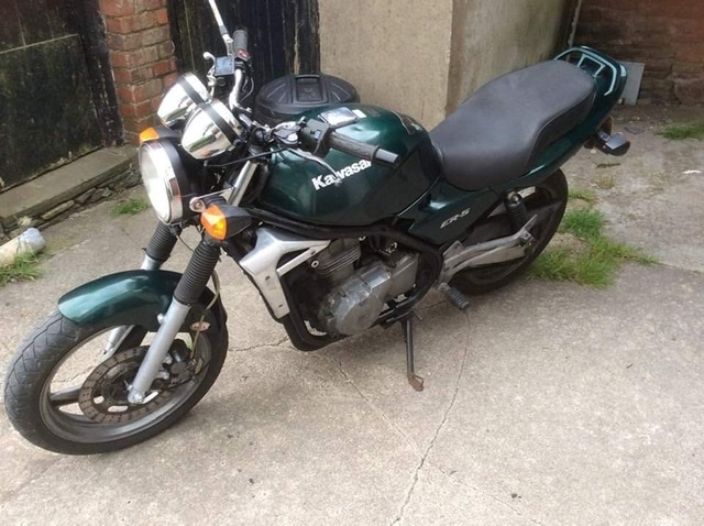

    Just picked up this oldie from a mate of a mate for £100 so it looks like I have a new project. Might as well build a cafe racer.
    Not been run in a few years but all present and correct.

    That looks in really good nick.
    I reckon you could just as easily give it a deep detail and turn it around quickly - provided you don't want your own racer.
    And . . . I reckon you'll be friggin' blessed. You'll chuck a new battery in it and it'll effortlessly start up and run perfect.:)

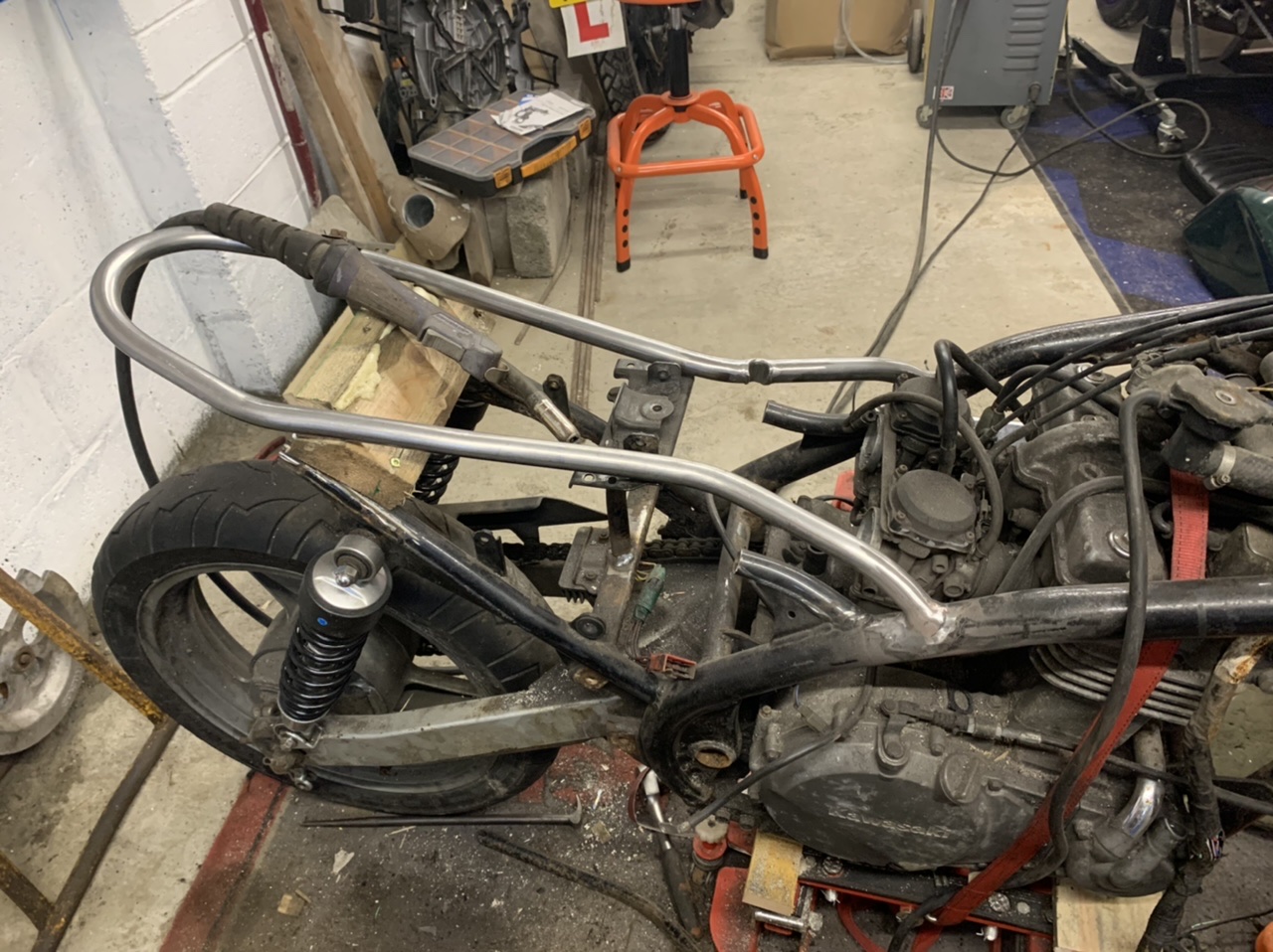

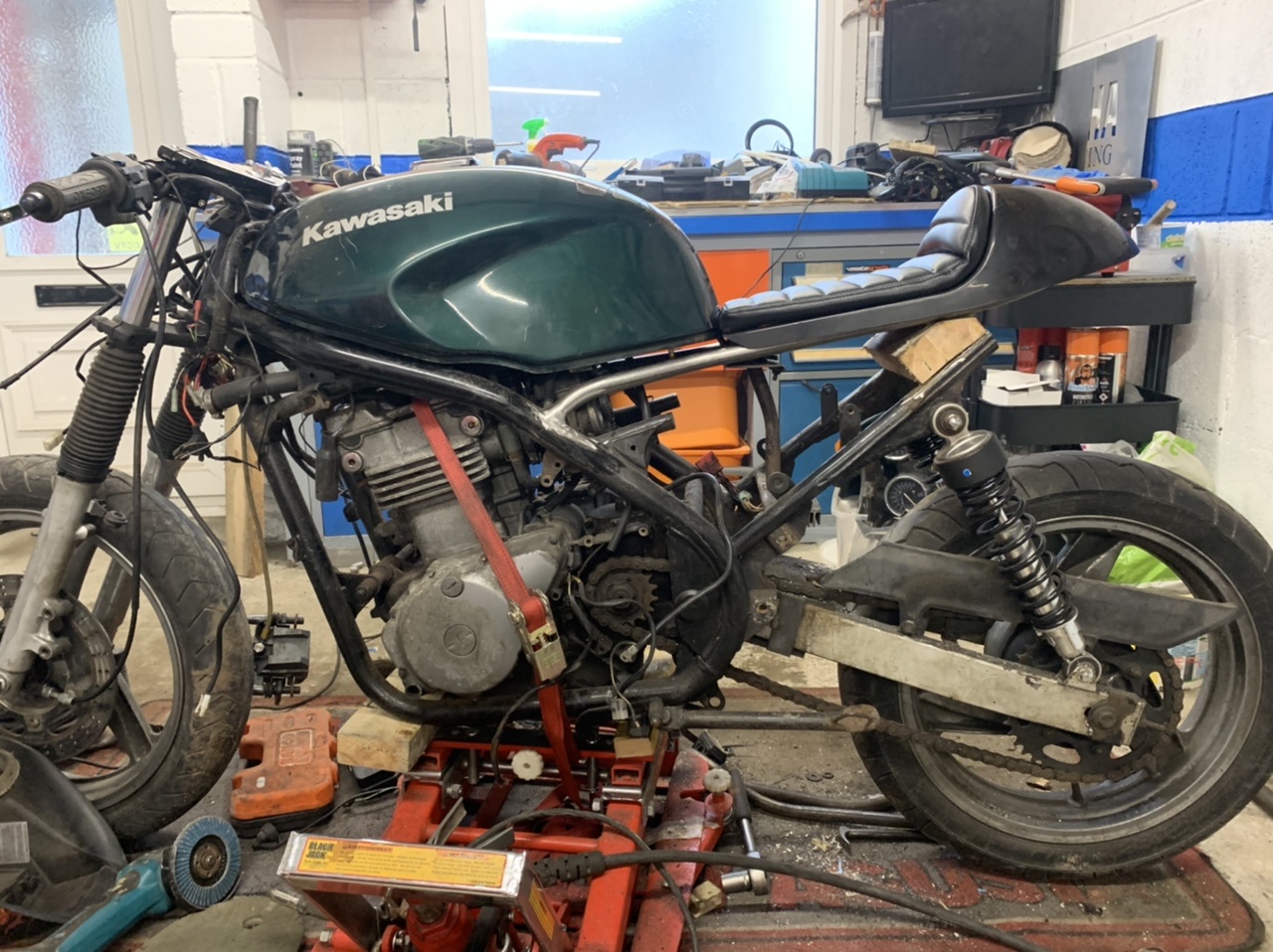

    Today’s work was replace the shocks with the Triumph ones (the mounts are huge, frame modification required!!) cut out the subframe top tube, replace it with my new one. Thankfully the seat arrived so I could get on with it. Darren got my shaved down yoke back too.
    Been a busy day but I pleased with the outcome.

    This is going to be one quick turnaround for a project bike. Certainly no dithering going on.
    And seemingly, no plans and specifications - all in the head I guess. Congrats and kudos to you!

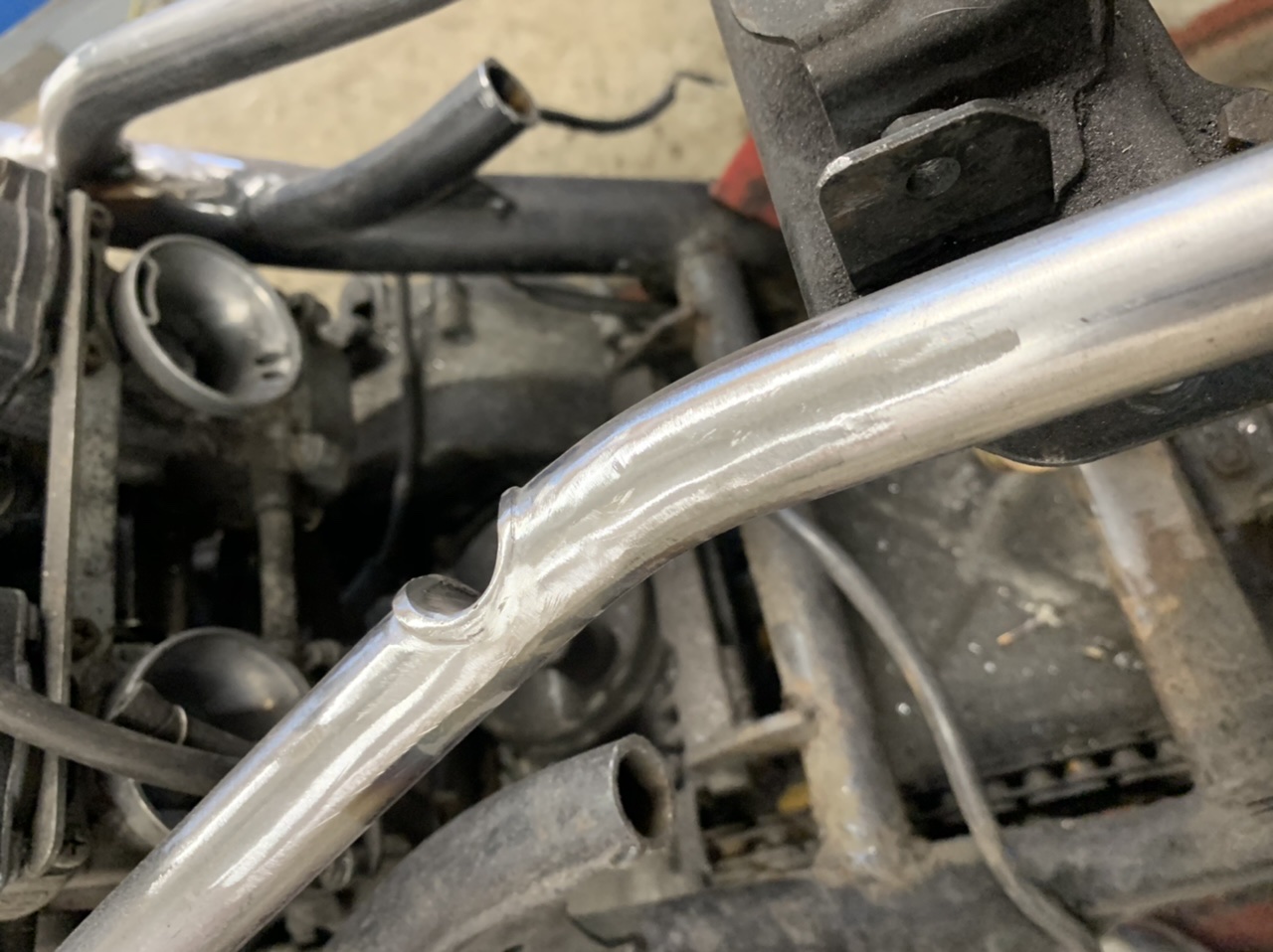

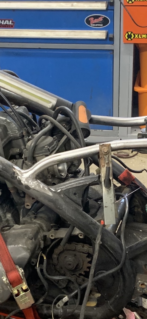

    Darren turned up this morning with my spigots (slugs) so I made a start and drilled through the main frame.
    Plug welded
    Stubs fitted and subframe adjusted for length Annoyed at the gaps but it is what it is.
    Multiple passes then smoothed out
    Fuel tank outlet mod
    Other side view
    Plenty of meat
    The look I’m after
