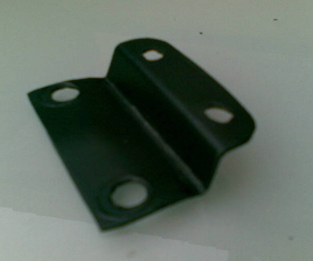

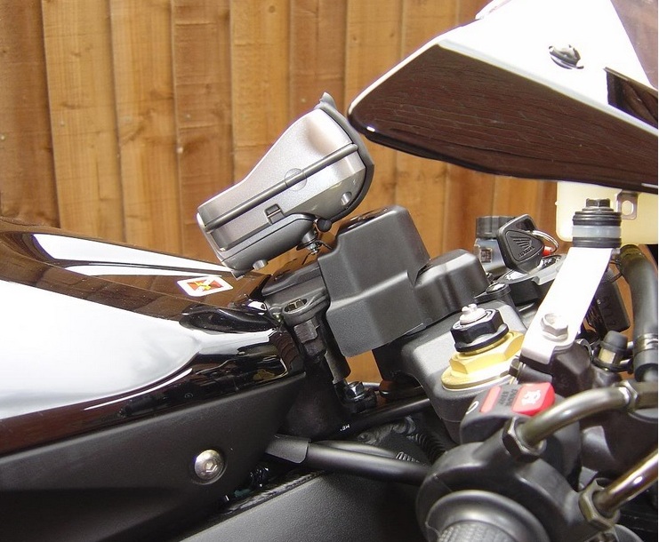

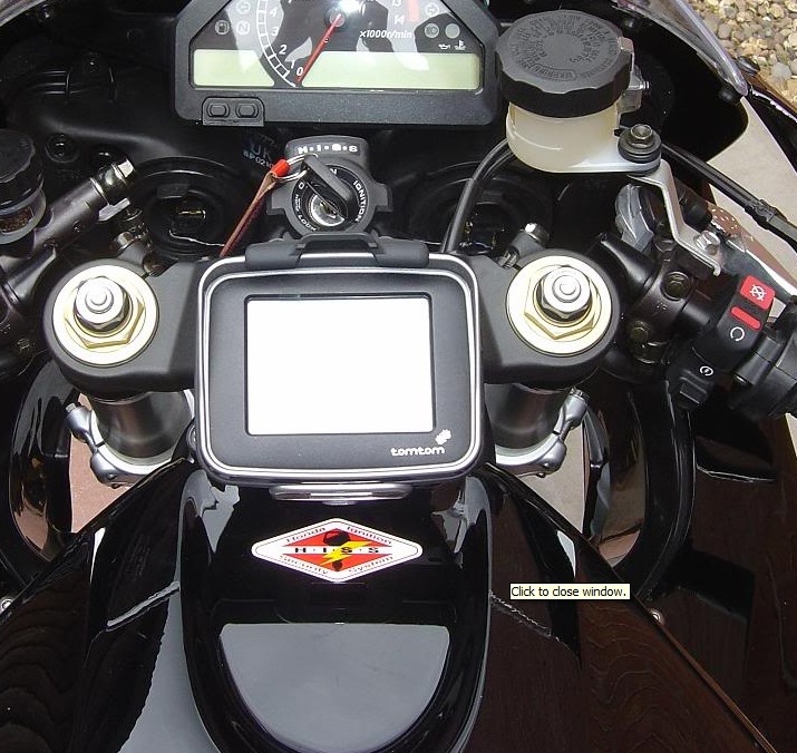

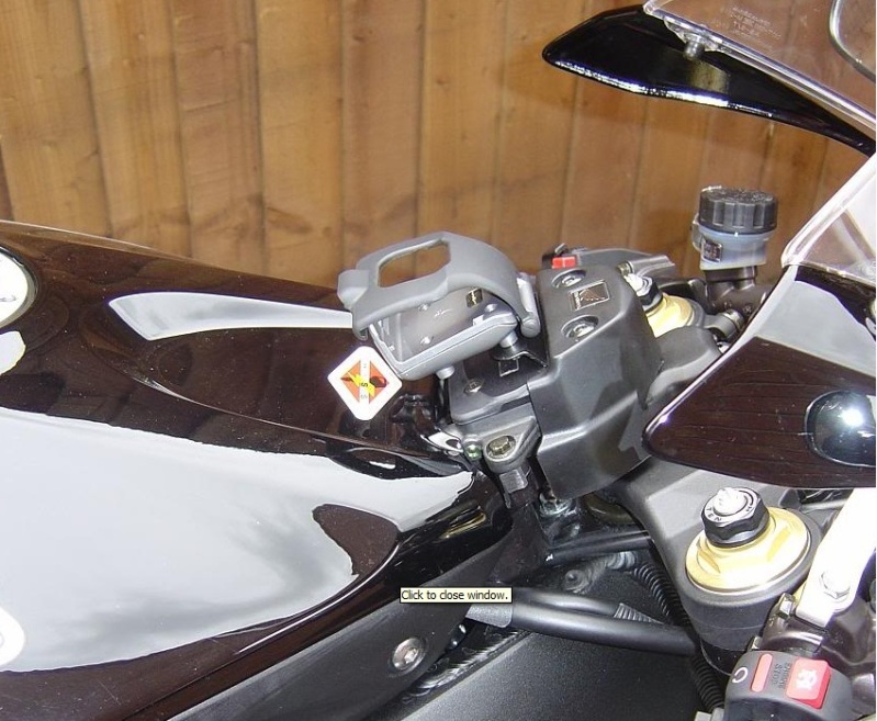

    Sam, that's my mount and my bike. The mount was made by using an aluminium plate that I bought from b&q for a fiver. It's original use was a push plate for a door.
    Just bend it to shape ising a vise, drill some holes and spray it black. Job done.
    That mount actually gave up this year so I'm on revision 2 and holds my garmin zumo instead of a tomtom.

    The mount shown is what was included in the original rider v1 box.
