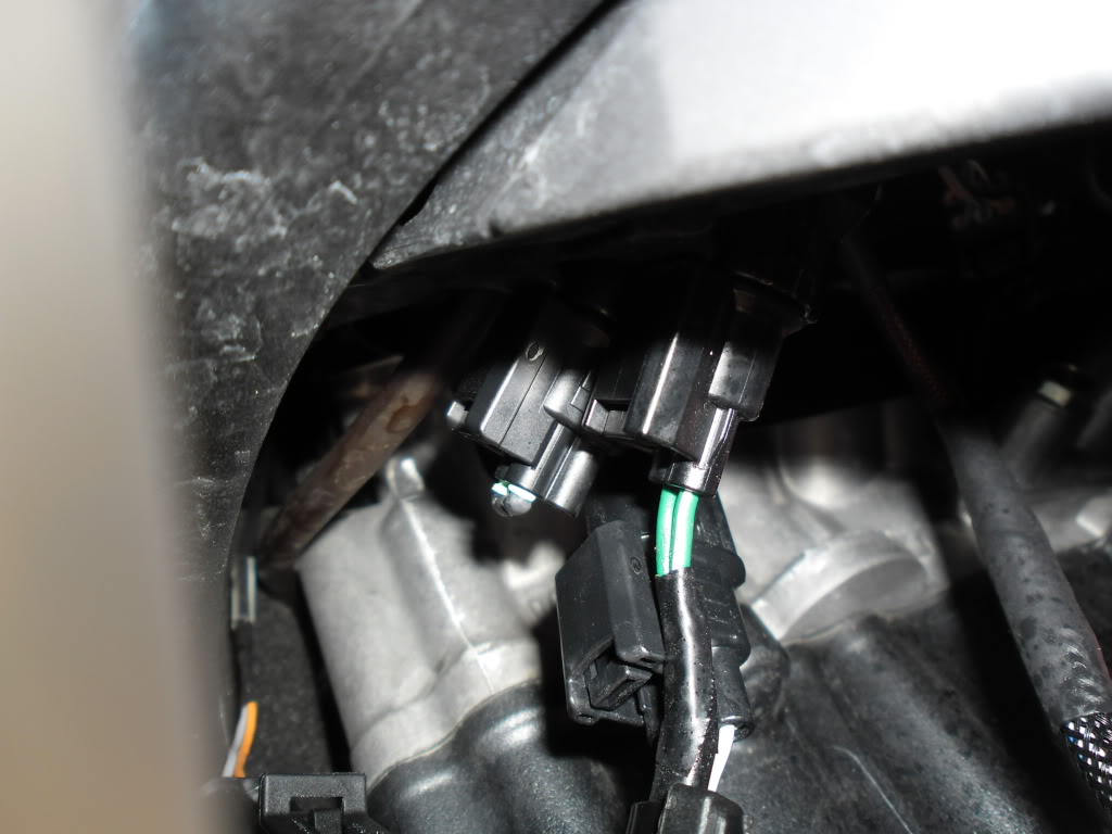

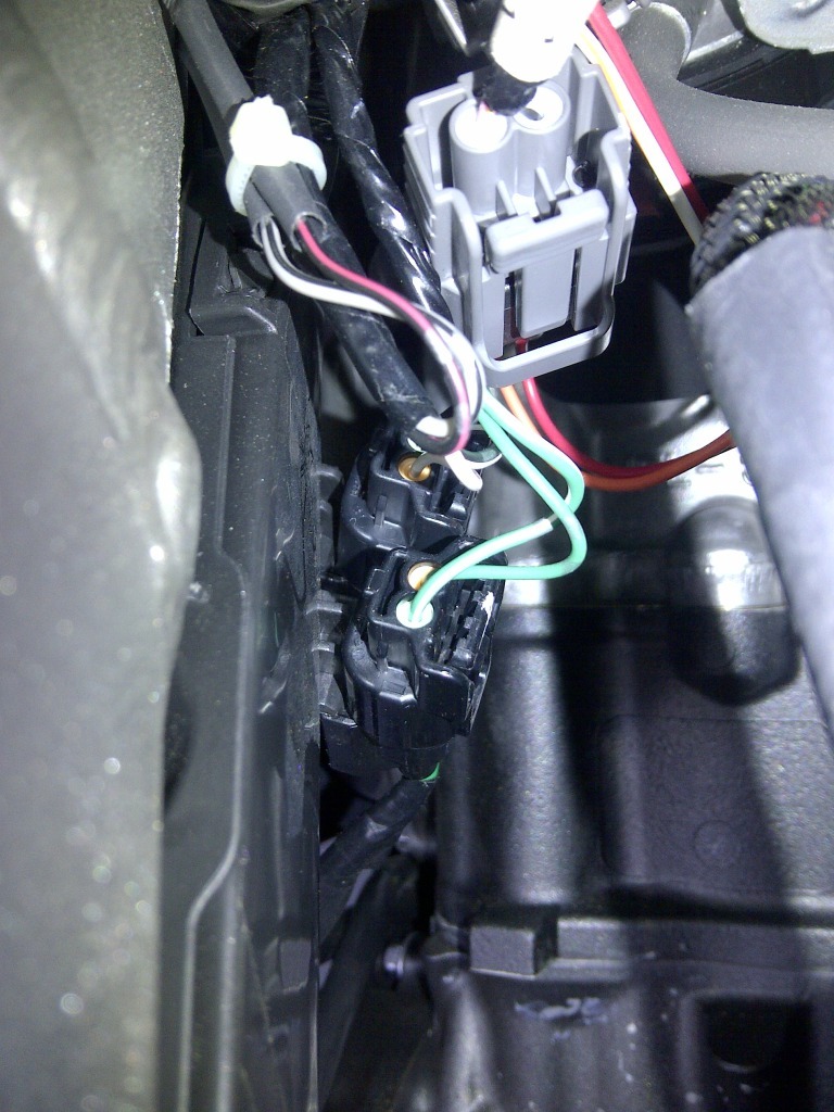

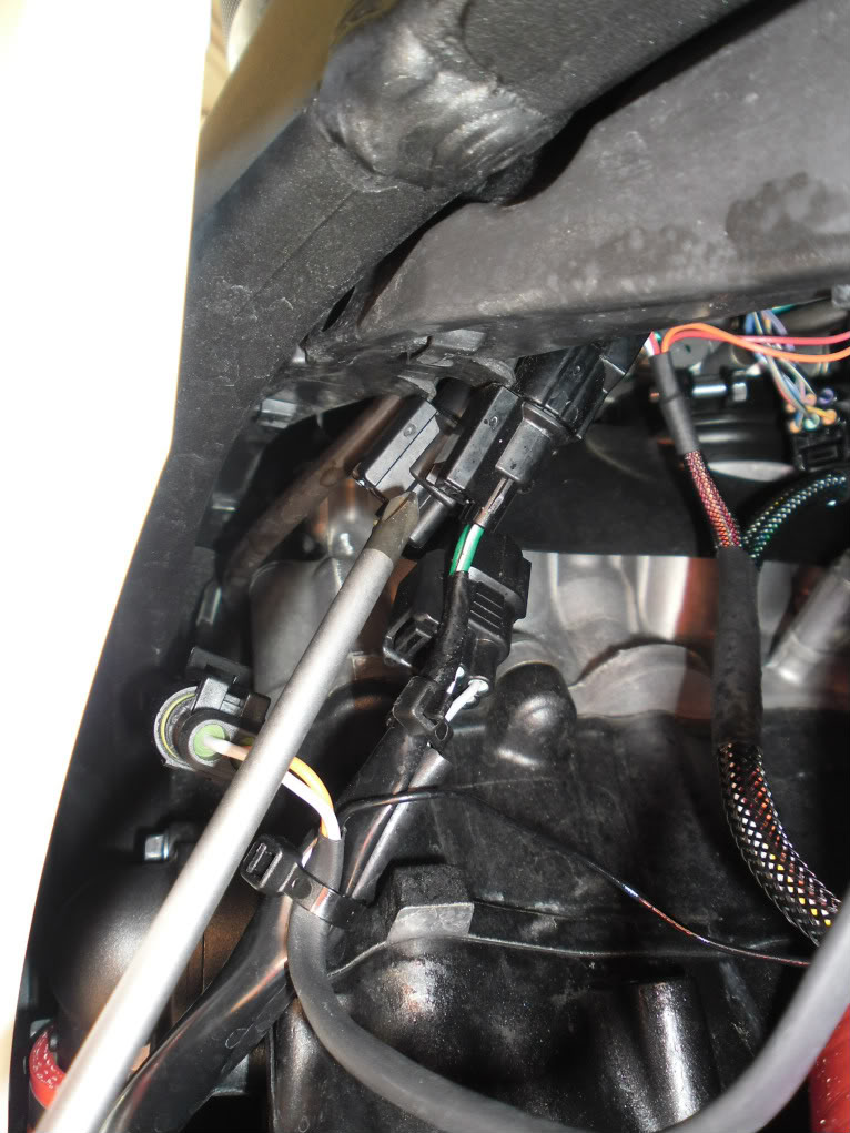

Left side forward of the gear lever mid way along the bike behind the mid fairing two plugs unplug the one that's connected to the exhaust plug. I found it easier to remove the tank to fit the PCV it will save you time in the long run. It's not to hard to do there's a good explanation on you tube to watch and if you need talking thru it ? I can pm you my number if you like as I have done it 3 times now but I am very happy with it now Sent from my iPhone using Tapatalk
When your fitting the power commander follow the cable from the sensor up to the connector . Excactly were Jamie said thou . If you put your fingers behind the frame on the gear shifter side of the bike you will feel it . There is 2 next to each other

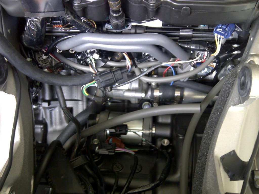

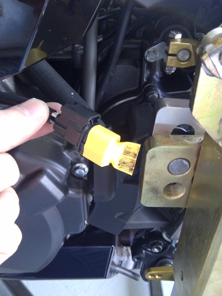

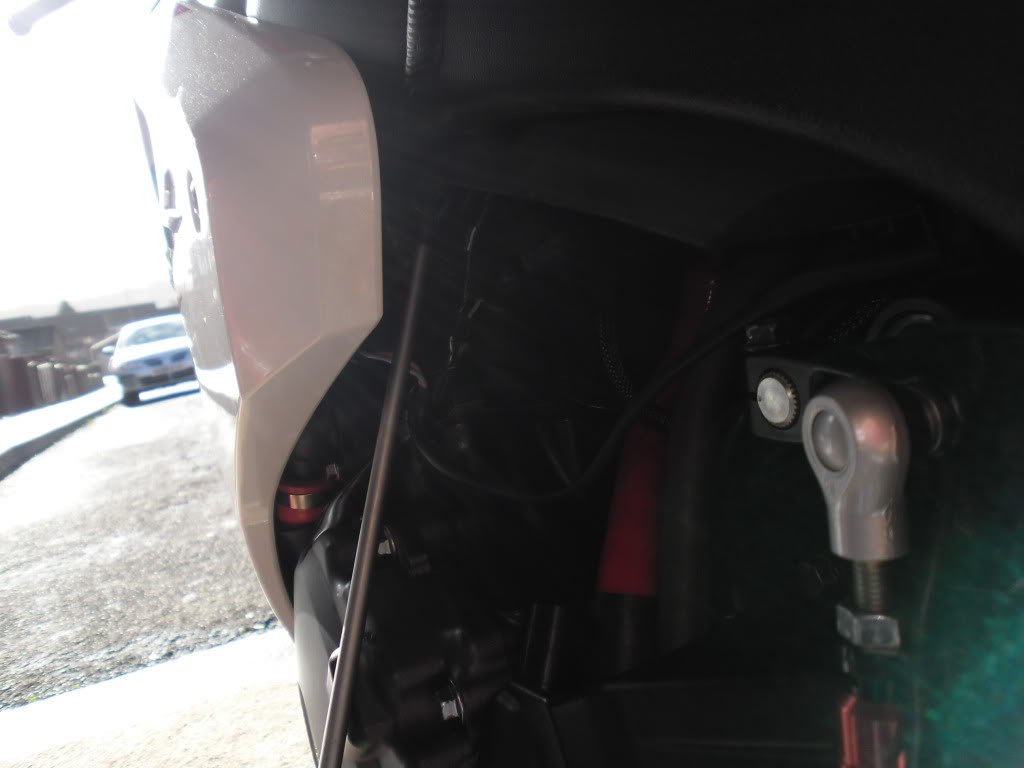

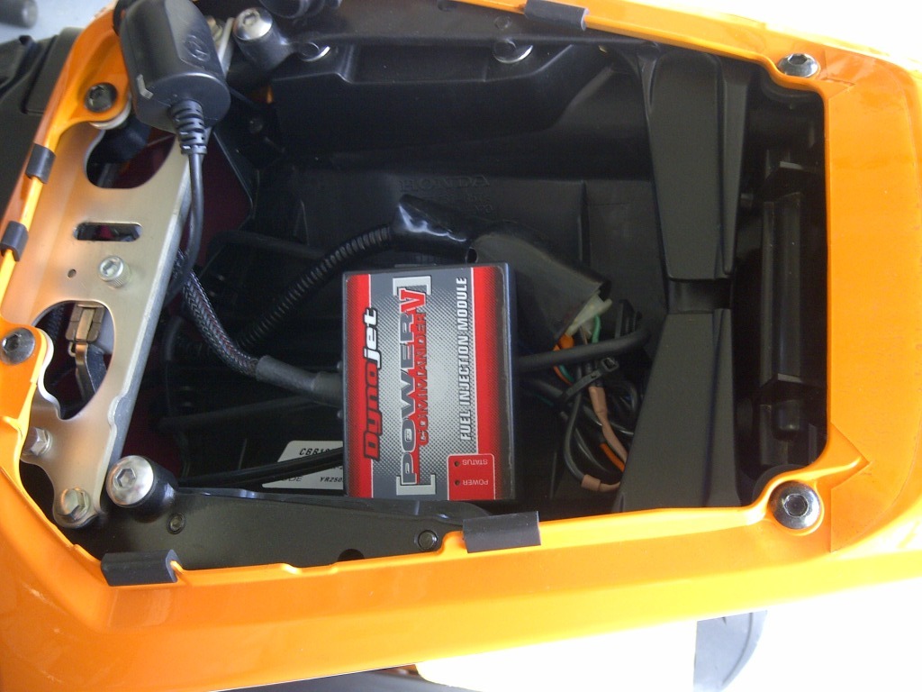

Picked up my PCV from Damodici this morning. Top bloke! He gave me a showing of his Blade and RC8. Fantastic pair of bikes. I can see me buying an RC8 one day. Thanks to Jamie for the photos of the O2 connector position and Dan for the eliminator and help. All fitted now. Just need a dry day to test. Here are few photos and video of parts of the install: Video CBR1000RR PCV fitted - YouTube Bit of heat shrink to waterproof the connector left from the O2 sensor
