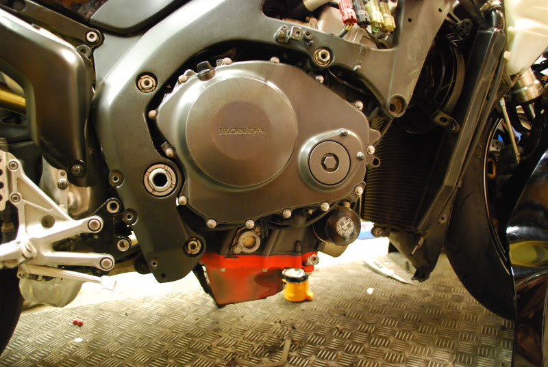

    Look what I've got
    Red modded sump!
    And..............................it's not a cure guys!. Still signs of corrosion around the retaining plat sump plug.
    When I had the ehgine in bits I repainted the sump black with LOADS of paint in that area.
