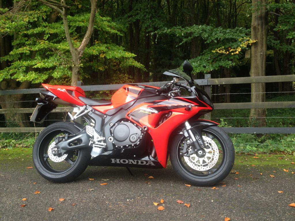

    The weekend i bought her.. Totally standard ! Beautiful !!
    Kept it totally untouched for the first couple of months...

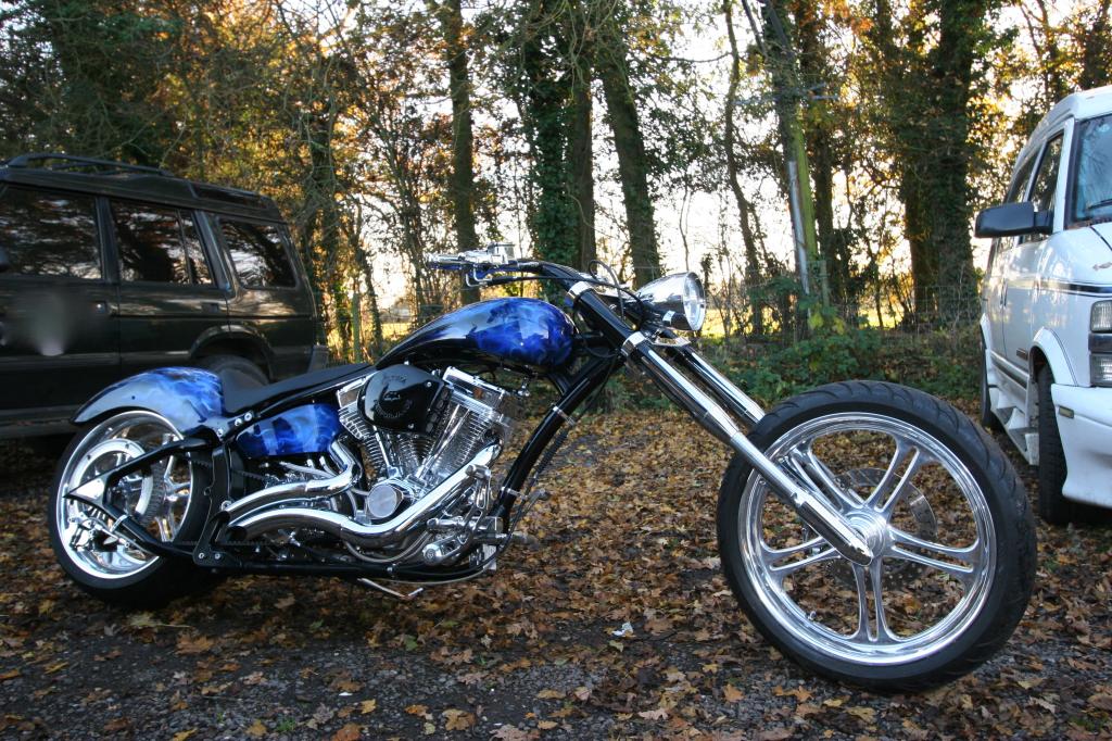

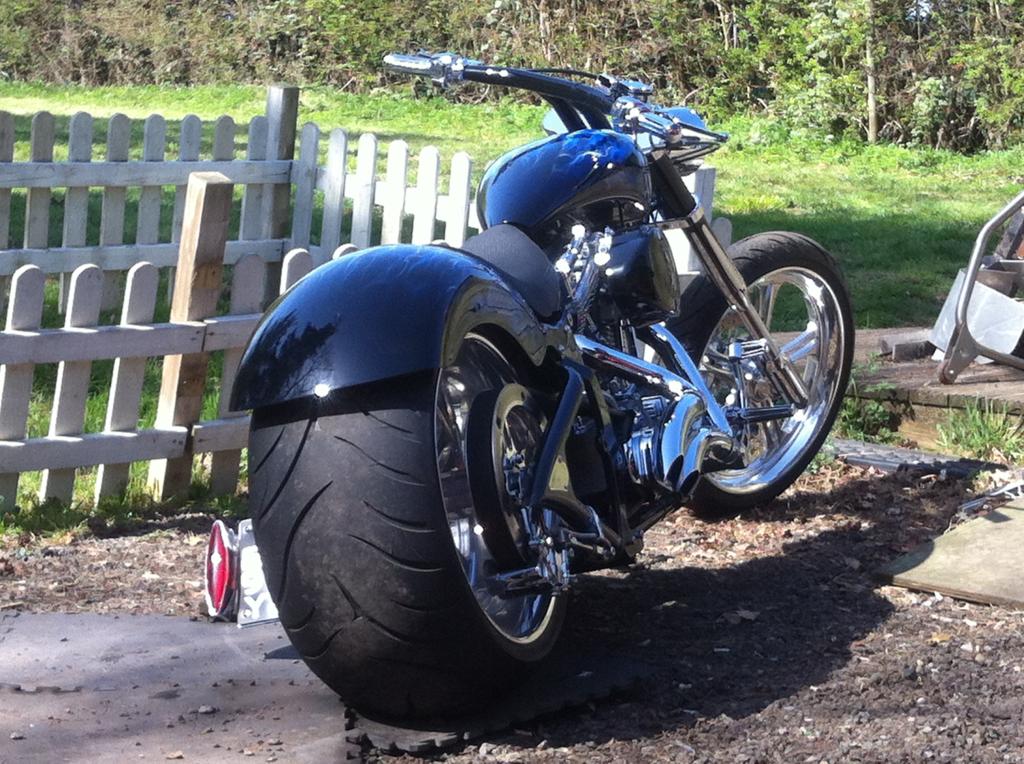

    My career path changed but always had bikes around me. I got heavily into the custom bike and chopper scene for a lot of years and have built lots of customs but i always got the calling for speed and sports bikes and had love affairs with a few Hayabusa's as well along the way..
    The last chop i built myself... Huge labour of love and expense !

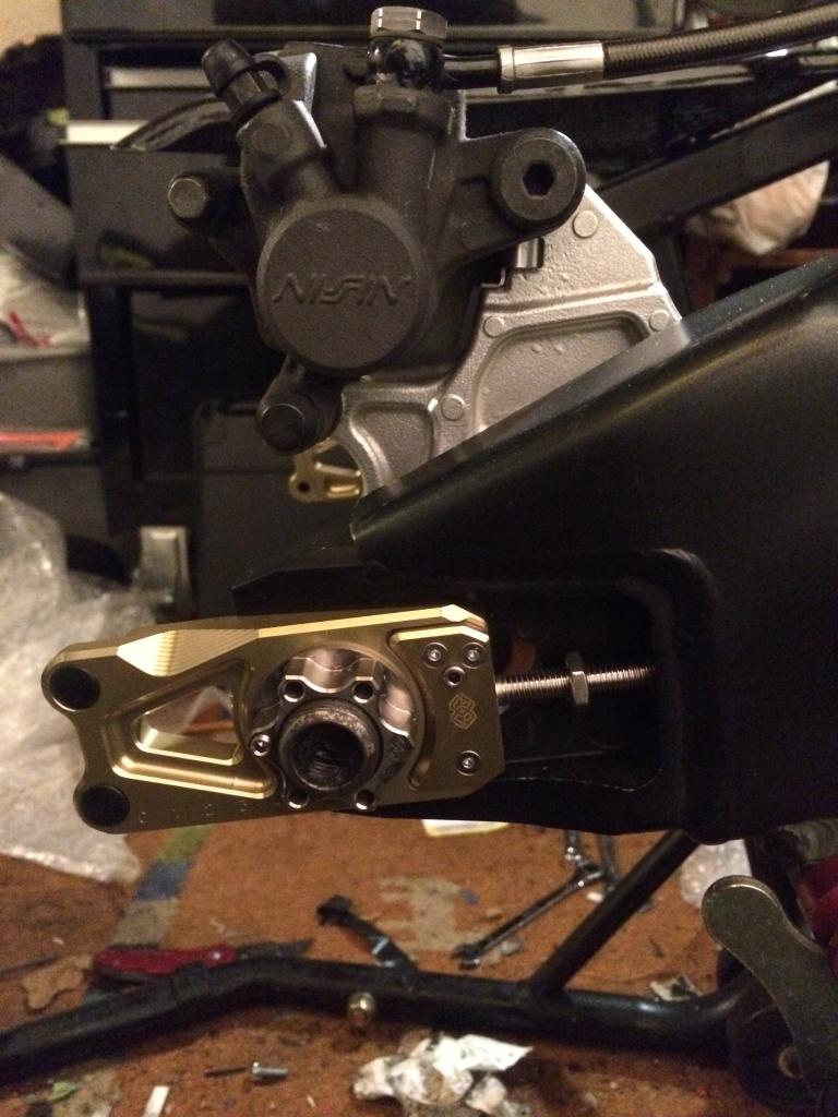

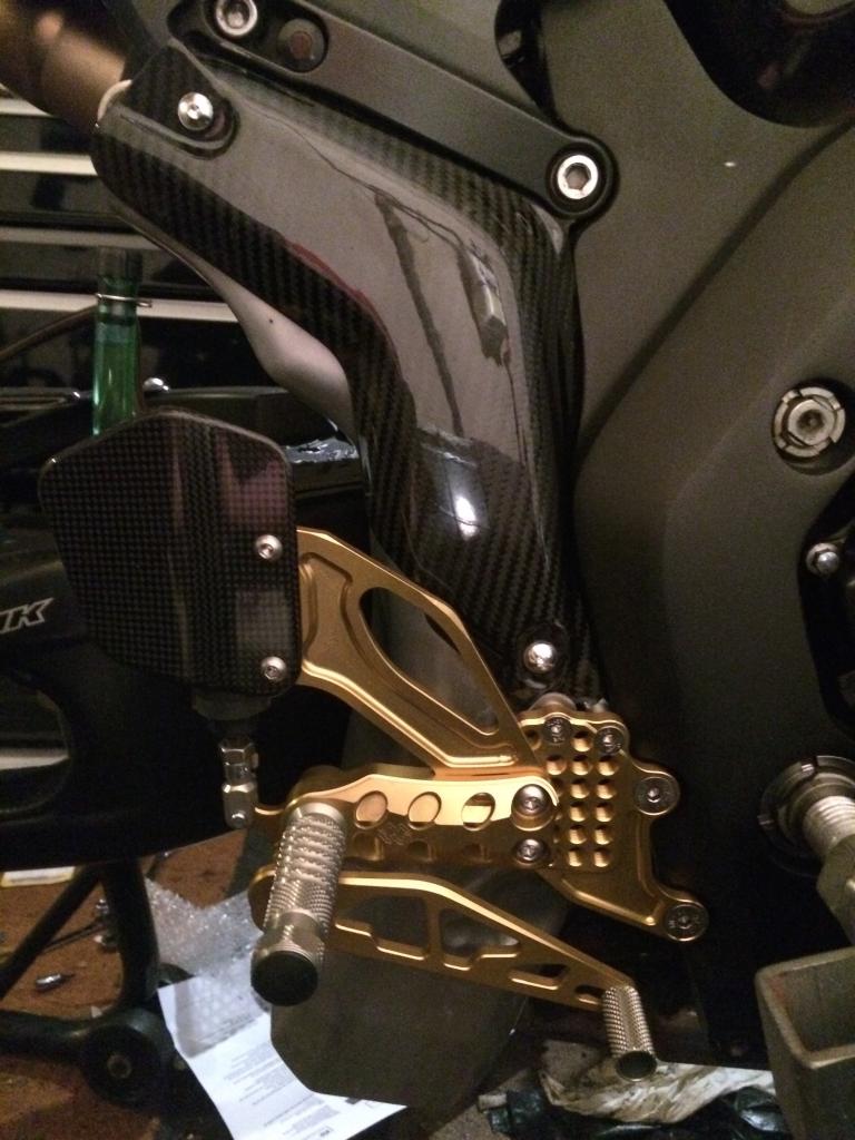

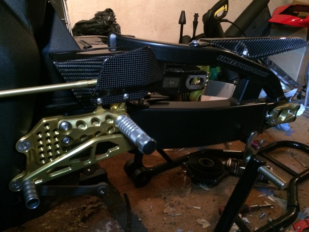

    Fitted the Gilles Rearsets and carbon chain guard.... Hugger had to go back to power bronze as didn't fit and waiting a replacement. :([​IMG]

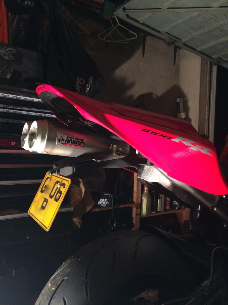

    This is gonna have to come back off as kit was missing a brake light holder, so waiting for that to get sorted by demon tweeks..[​IMG]

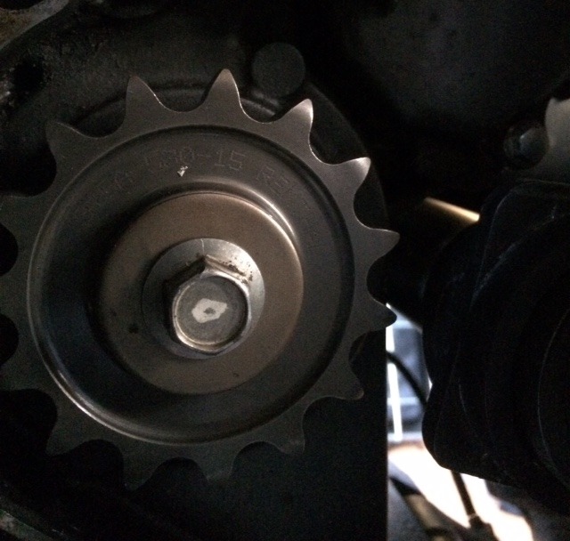

    Thank you mate, and you've been a big help all the way ! Great minds think alike, and put the 15 in yesterday ;)
    First time in years I've gone by the book and actually used a torque wrench, and its made me realise how much i seriously over tighten everything... 54 Nm felt like finger tight for that sprocket...

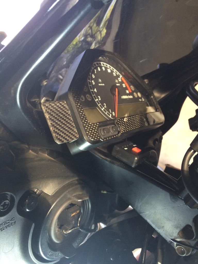

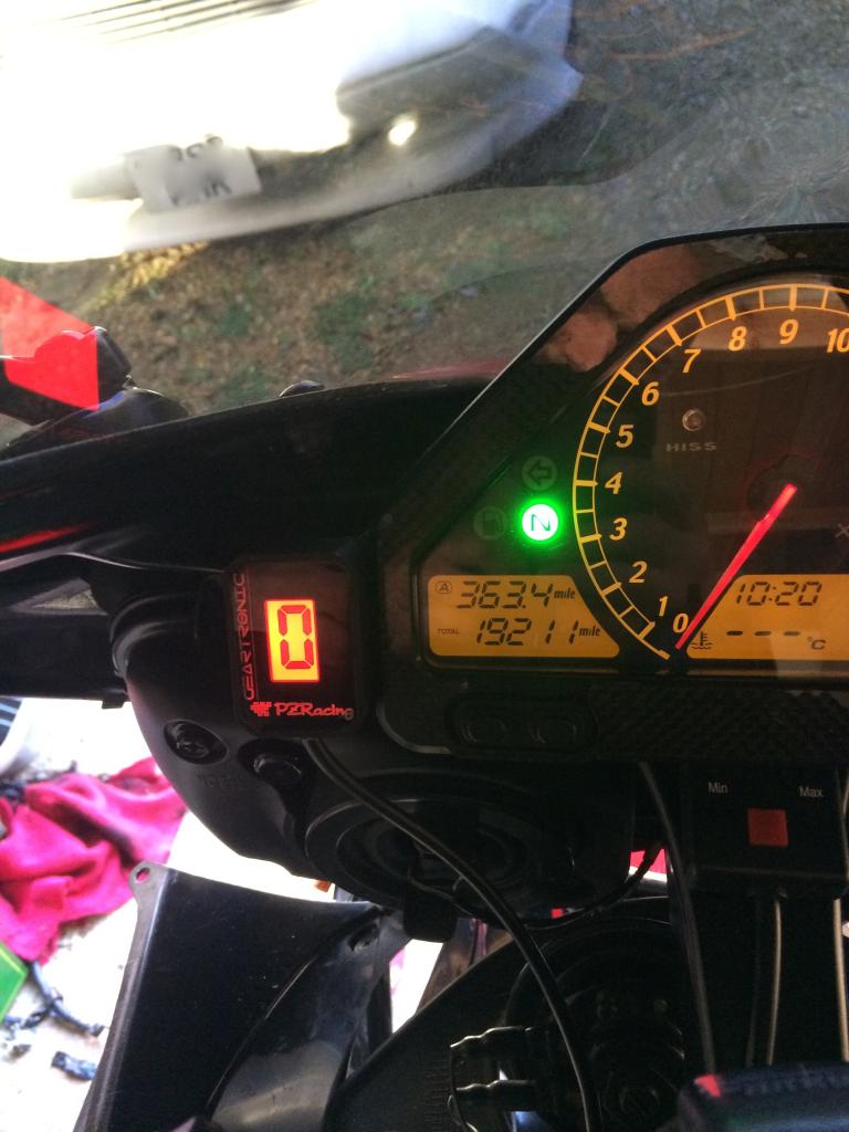

    Made a little bracket out of carbon and mounted PZ Racing gear indicator on the dash..[​IMG]
