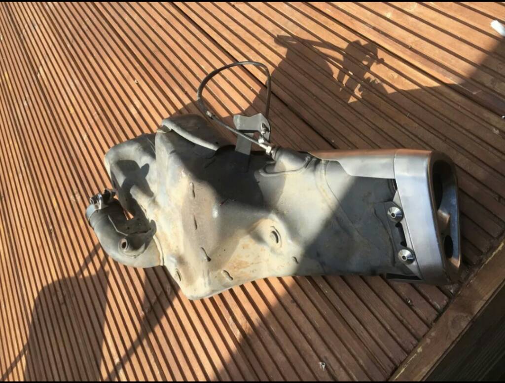

    Looking to remove my Leo Vince can and buy and get a standard system on.
    Think I may have asked this..but can't find or remember..
    So I have found a can for £35.
    Does this need a link pipe also?
    Also what about the sensor? As I don't have this in place on the Leo Vince link pipes..
    Any other parts needed.
    Thanks

    Link pipe no as its one unit with the ten tonne box on but the sensor yes
  3. Slick
    Slick Elite Member
    Nov 11, 2012
    2,491
    1,241
    no link pipe needed.
    Ask the seller if the link gasket is still resuable, if not you will need a new one. Also check the exhaust band is in good condition, mine just fell off when I fitted my yoshi.
    It may be cheaper (and easier) not to bother with the sensor, just keep the o2 eliminator in place and bung the hole. I can imagine rerouting the sensor to be a right PITA if not you can buy this
    http://www.ebay.co.uk/itm/Honda-CBR...hash=item1ea0dcde37:m:mwI4Lqw0yfuVlVabMSvT58A.
    Not sure how the exhaust flapper has been disabled but you may have a servo buddy in there, if the servo is still there reattachment of the servo cable is pretty straight forward

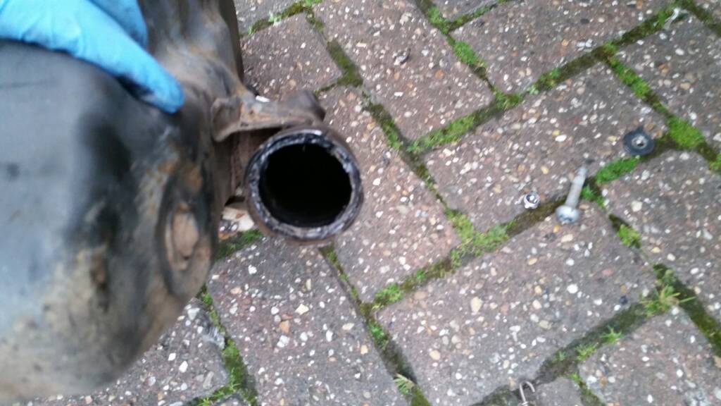

    Okay...why is it so difficult to get the pipe in..?
    Inside of the pipe on the exhaust end is getting in the way..
    Guessing its the gasket?
    Do i need a gasket?
    also clamp was all seized and i could not get it loose..so need a new clamp as well..
    bummer - sunday so will have to wait till next week

    No, it is a carbon black wound wire tube which slots into the pipe.

    okay, i had to take it out and came out not in one piece ..does it need replacing?
    as the leo vince link pipe did not have anything like this in it?
  10. exuptoy
    exuptoy Elite Member
    Feb 24, 2015
    2,786
    1,154
    Yeah or it will not seal. The LV was an interference fit.

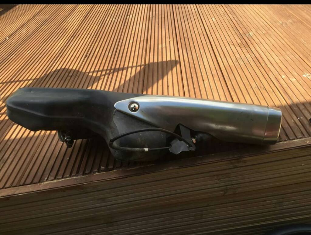

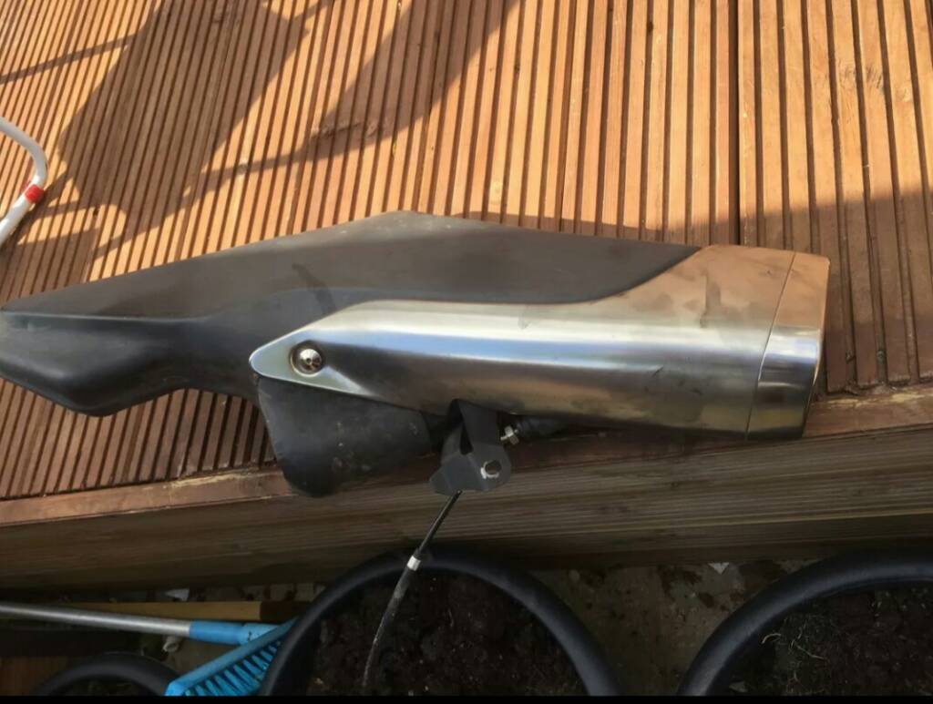

    What is this wire coming out of the exhaust..? were does this go

    1,154
    If you have the servo under the seat then it goes around the servo actuator and is connected to a flap in the exhaust which opens around 4k. The flapper mod is basically disconnecting it from the servo. Just tuck it up inside the seat subframe out of the way. The flap is sprung to fail open.

    The cable will be for the valve under the seat. It routes up behind the footrest.
    The motor is under a plastic panel, you can see it above the hugger if you look up, it has three plastic screws I think.

    20
    Don't bother connecting the flap cable to the servo... not needed at all so wouldn't waste my time with it
