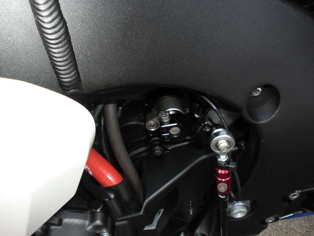

  14. johncbr
    johncbr Active Member
    Mar 3, 2012
    95
    10
    it looks like this
    this is wot it looks like
  15. arthurbikemad
    5,371
    3,579
    See the little logo on the support mate, thats Gilles, and they make the shift support you image shows.. Back to the seal myself I have not seen any problem with them I asked about the PAIR system as it has been known that the dyno bod blocked the wrong hose at the airbox, one is the crank breather the other is the PAIR/SAS system... An easy mistake IF someone was new maybe..? No big deal and you have it sorted.. :)
    EDIT JUST SEEN MY POST IS A PAGE LATE....lol
  16. Jamiestrada
    Here is what the 08+ Gilles support looks like
  17. PeterT
    PeterT Active Member
    May 17, 2011
    1,050
    247
    Aghhh lovely, thanks for the pictures Jamie.
