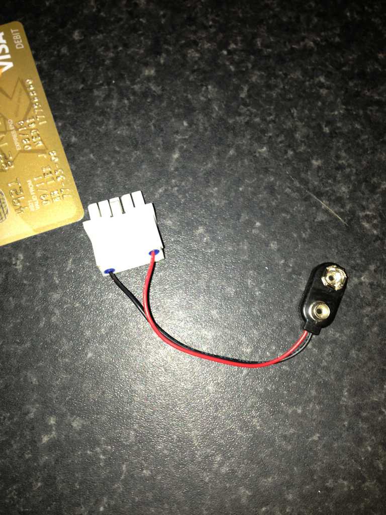

    2,314
    I have a power lead mate send me your address ill send it ya

  12. wedgiewolves#223
    wedgiewolves#223 God Like
    Apr 7, 2011
    3,955

  15. wedgiewolves#223
    Apr 7, 2011
    3,955
    2,314
    Na don't worry about it only sitting in a draw buddy
