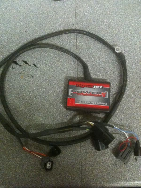

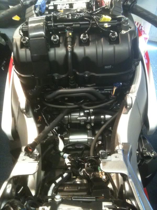

    Hi peeps right ive fitted one of these today that i got off ebay a english version second hand! now its got a map in for a racefit shite exhaust and mine has a standard can and k&n for now!
    Thing is my bike is 2011 model and on the uk dynojet site they dont list past 2009 i am guessing it will be the same but there is only 2 maps both with cans! what would you do?
    confussed!!

    After speaker to me mate via text who is head 4stroke devolment at Dynojet uk :) he put me onto martin the lad that does the dynos up there!
    And guess what i still could not work it out to much stella last night lol! but after realising that the english maps came after the usa performance cans etc i spotted it.
    managed to do 40 mile on it today Bloody weather and all i can say is its MINT the bike is crisp and smooth with no guttless feeling anymore at 3 to 4000 rpm pulls from 25 mph in 6th no probs just need a yoshi r77 and gilles rearsets now and i am done ;)
    BArgain at 170 notes delivered damn i love ebay 15 month old uk spec :)
    Ready to fit
    In goes the map 1 am this morn haha!!
    One thing i will say is if you do your own map check the throttle postion and reset if need be mine was 98% open at full throttle..
