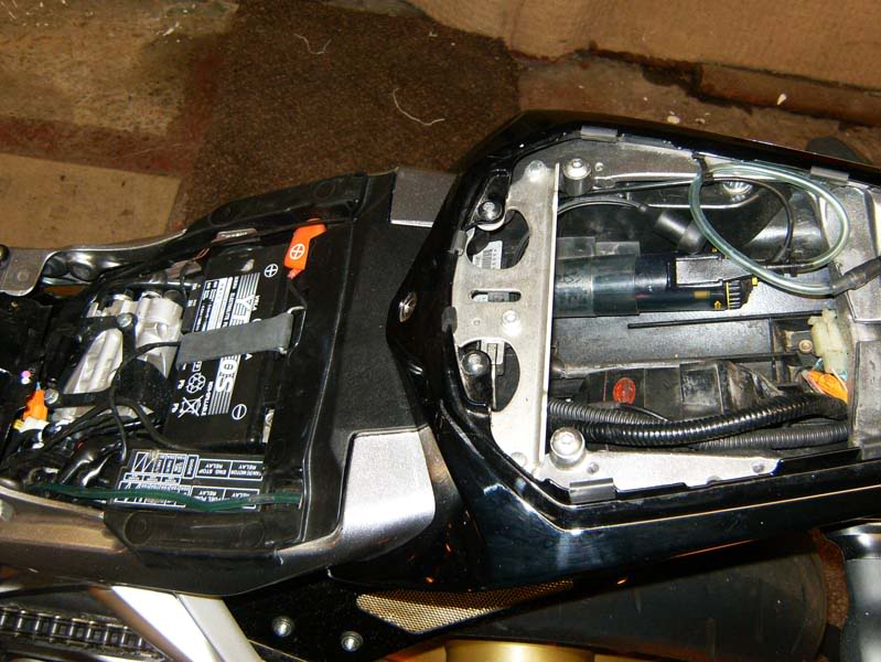

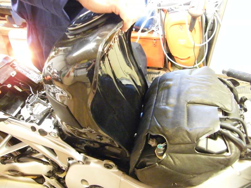

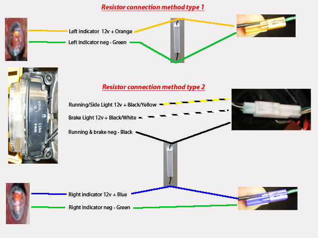

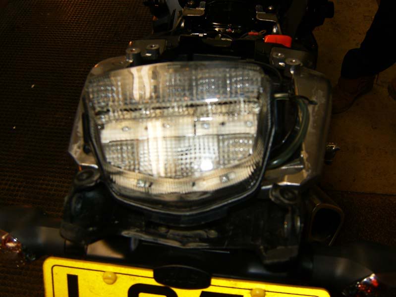

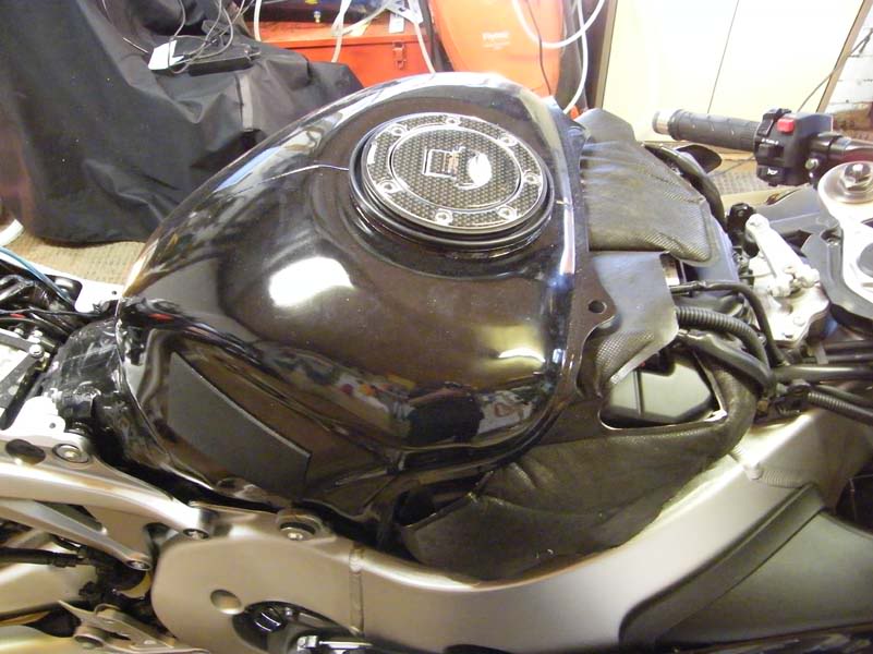

    Hi guys heres the pics from the garage night as promised
    First off the pic lot for the LED rear light install

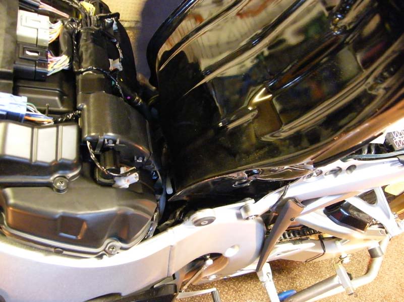

  2. ColinBR

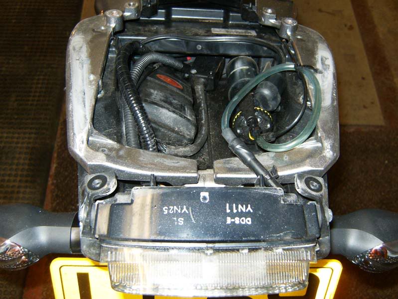

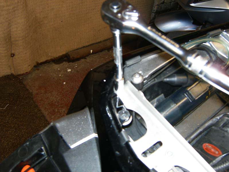

    More pics of light fitting

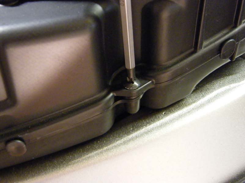

  3. ColinBR

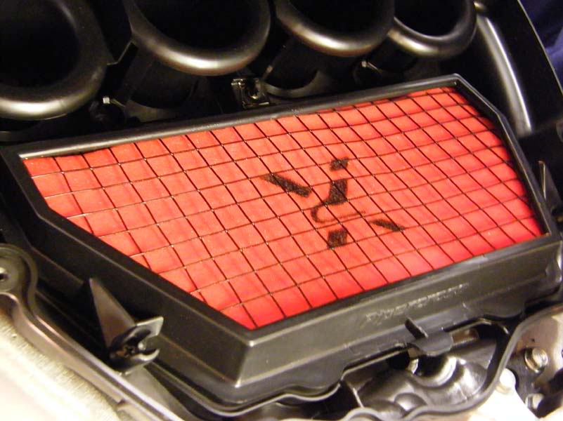

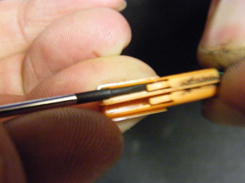

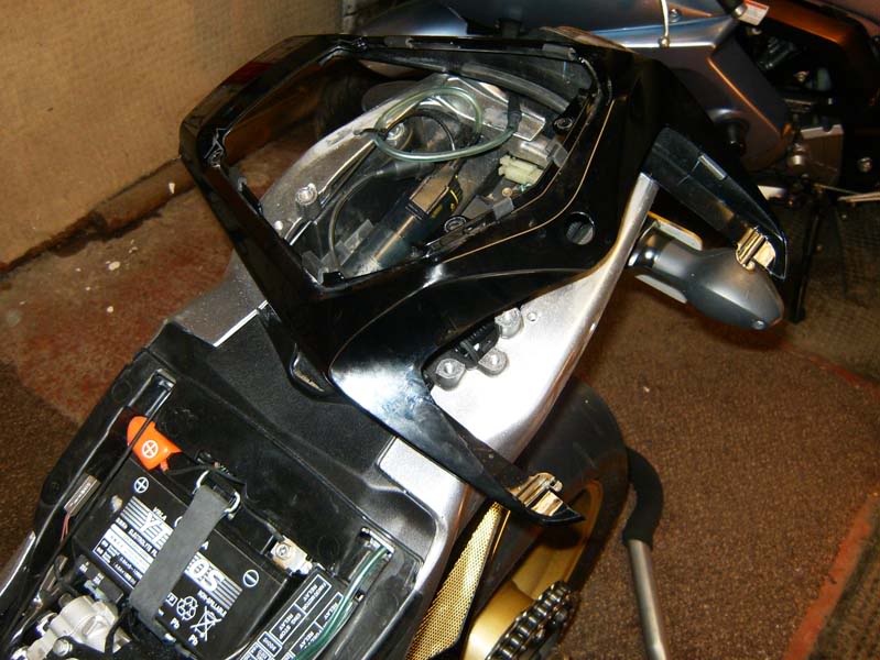

    Filter Install
  4. ColinBR

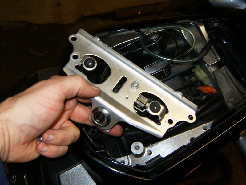

    More of filter
  5. tanstair
    tanstair Active Member
    178
    29

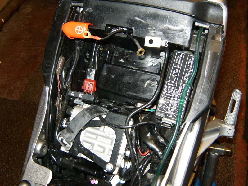

    A scot-oiler how many miles you do to warrant that ? :pleasantry:

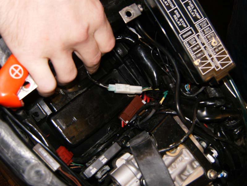

    nice work with the addition of wiring methods :biggrin1:

  8. Benn The Pig
    Sep 21, 2011
    2,794
    546
    Great pix Colin, are you re mapping as you have changed the filter? What's that bike lurking in the background????
  9. ColinBR
    Hi Benn
    I'm just waiting to get my exhaust, then I'll get the bike custom mapped. I wired in a map switch for the powercommander at the same time so I can get the bike tuned for different maps.
    I'm still undecided on which exhaust to buy. Either the akrapovic or the yoshimura slip-ons.

    Great thread Colin. I've just been looking at the very first picture and noticed something I've never realised before.
    With its mirrors tucked back like that the FireBlade looks like Sonic the Hedgehog.

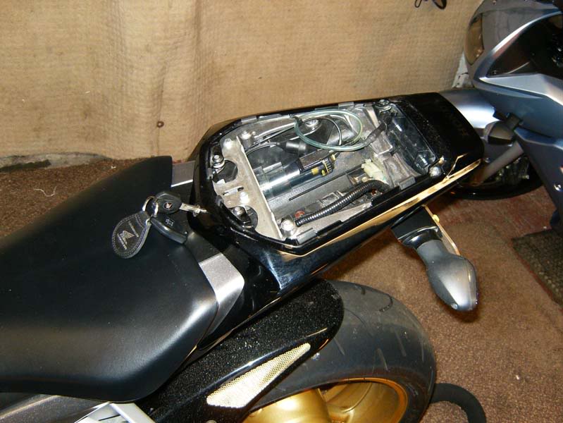

  16. Bats
    Bats Active Member
    May 30, 2011
    1,039
    337
    How the fook that sand got in with the alarm and oiler i will never no!! ;)
  17. ColinBR
    All that got in the last ride out I had.
    The r&g tailtidy I had fitted has a much too big hole in it where the wires goto the lights. Which let's the crud in. Needless to say it's now off and I'm making my own bracket and putting a rubber grommet in the hole for the wires, like they should've.
  18. tanstair
    178
    29
    I agree totally. Just ripped my R & G off too, way too much metal, making my own from scratch, including a way to hide the wiring without the need of using cable ties.
    I hope to see a picture of your finished product :)
