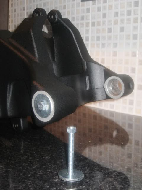

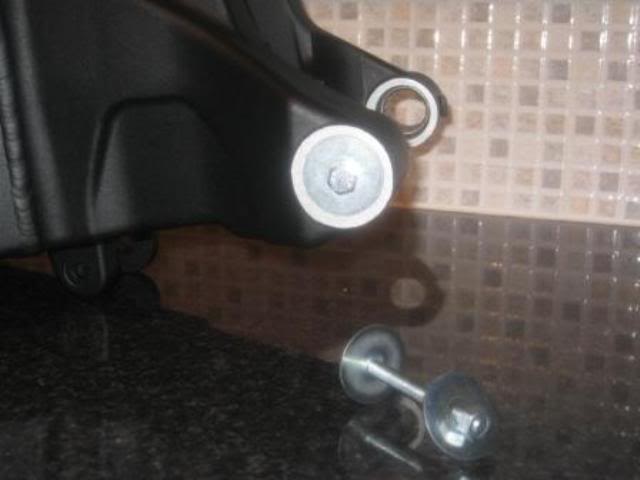

    When I had my swingarm powder coated on my CBR600RR, I removed all grease from the bearings and used a long threaded bolt, nut & washers to seal off the bearings.
    The powder coaters stripped the swingarm, used silicone tape around the edges of the washers then powder coated without any issues whatsoever.
