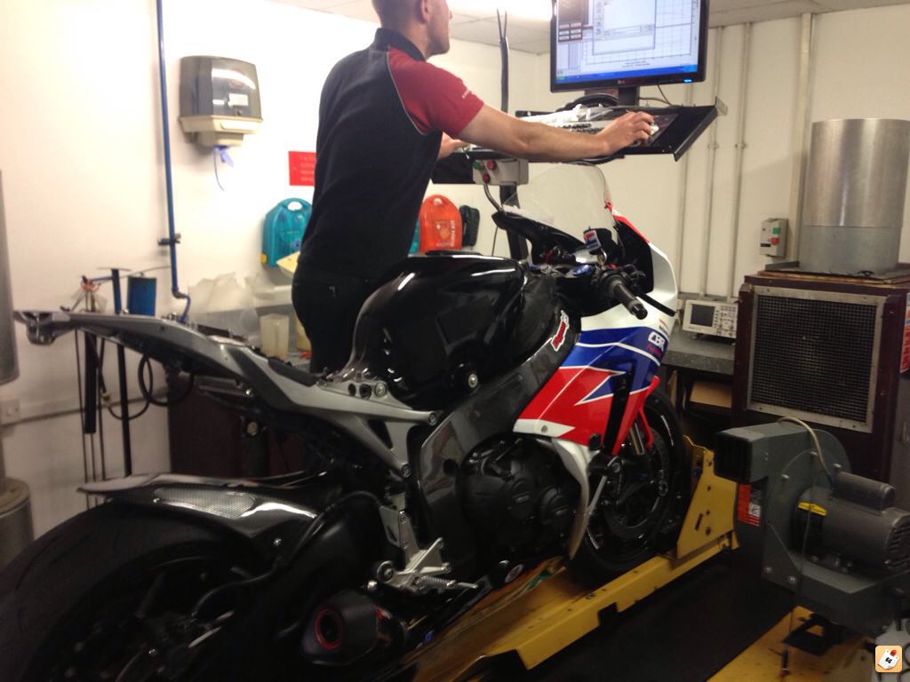

    I had mine dyno ed by Richard at dynojet baffle in baffle out map he charged me £20 I think for the switch but he fitted it and mapped both so I though was fair enough [​IMG]
