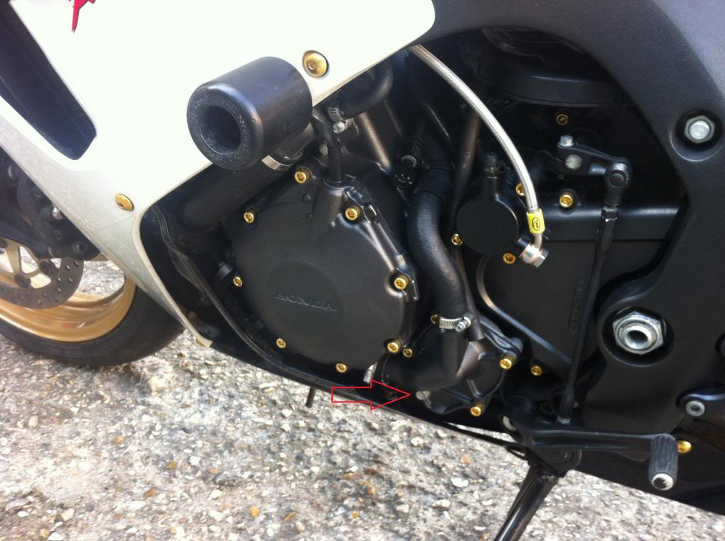

    OK, all bolts on for fairing screen & engine... apart from one !
    Anyone know what this one is, as I undid it it started seeping neon green fluid, so I quicky done it up again... being an HRC it could be raw kryptonite ;) or maybe coolant fluid? I can's see me undoing and putting a new bolt in without loosing quite a bit of fluid ?

    Coolant drain bolt?

    Yep it's the coolant drain bolt :)

    It'll give you the excuse then to change the coolant while your at it mate. 2 birds with 1 stone.

    If you are quick you wont lose much coolant mate.........just go for it

    Lay the bike over on it's right hand side Crash Bung and an old Duvet then swap out reet rapid, then top up Coolant if needed

    Yeah its coolant drain you will be sweet quick swop make sure put washer back on and only slightly butt it up only takes about 10nm
