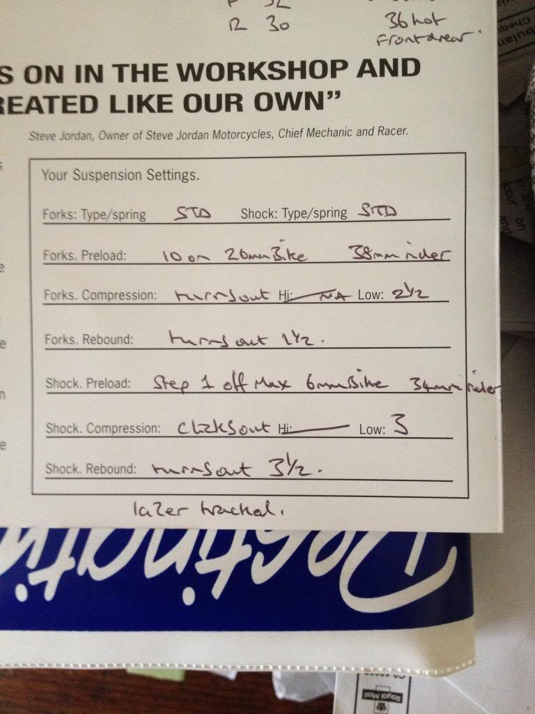

    Heres the set up card Steve gave me. At the moment I'm 104kgs without riding gear, so anyone else around that weight with a RR6 or 7, it might give you an idea to work from...

    Had mine done at FTR in Bury St Edmunds and totally agree with the comments above worth every pennny and strangely enough the settings on my RR6 are very similar to the ones on yours Blackness
