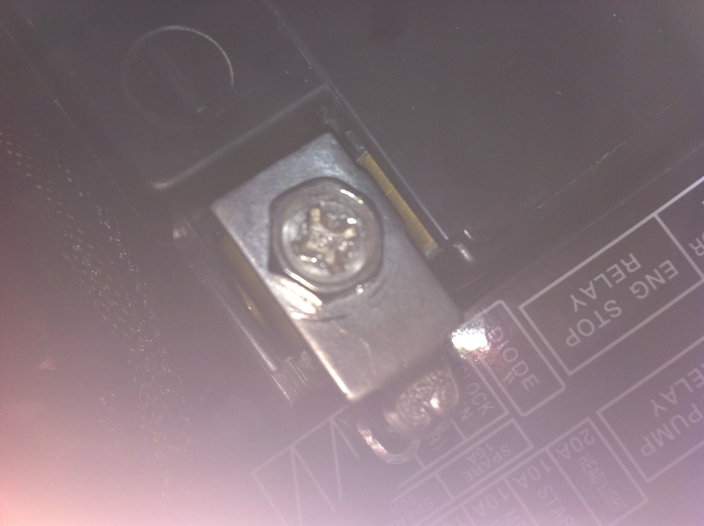

    how do I get this out of my neutral terminal before I completely chew it to bits, it's stuck fast !
    is it a case of a large flat head and a hammer ? i was worried about damaging the terminal

    Looks as if it's bolt head use a socket or is it flush?just a nut under terminal

    Agree with oust above, isn't that an 8 or 10mm socket?

    10mm socket. There's a captive nut underneath. Before you reassemble it just nip upstairs, in the drawer by the bed you'll find some Vaseline, just give it a good smear of this.
