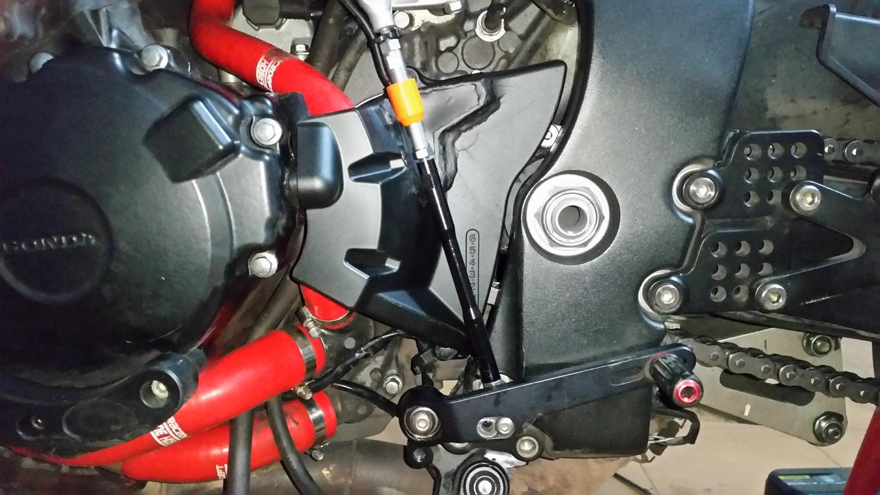

    Can you undo the pinch bolt on the gear shaft link , slide off and rotate 180 ° ,,,, just wondering .

    I always thought that. I dont know if the shift rod will be at such an angle that it interferes with the sprocket cover or something?

    Good point ,,,, I've never tried it
    At a glance at the picture it looked the simplest way

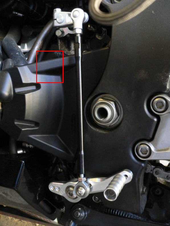

    Yes... All you have to do is rotate it 180º. Did it mine.
    However, you will have to either remove the cover or cut it, since the rod will "occupy" roughly this area
    I ended up cutting by cover, and then made a rather "crappy" plastic welding with other pieces of plastic so I could have the cover on, but without an hole.
