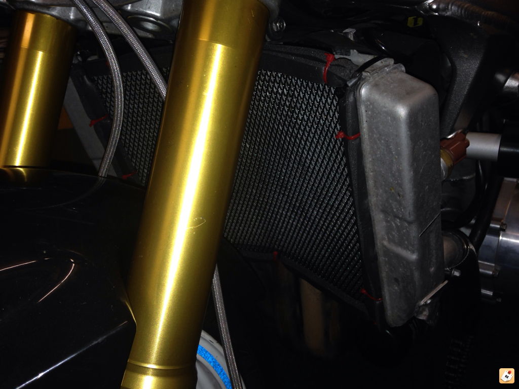

  6. Jap_STi_3
    Jap_STi_3 Member
    Dec 10, 2013
    579
    406
    This is how R&G Have put the two together.
    Hope it helps a little.
