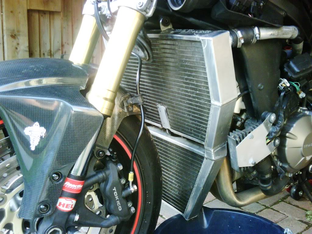

    Hi Dave,
    Heres a picture of my full size rad on my 600rr which I managed to get a couple of holes in :rolleyes:.
    Because it's a 2 core model it was going to cost a small fortune to have it re-cored.
    I used used Evo-stik metal epoxy putty which cost £5.49 from Halfords Halfords | Evo-stik Hard & Fast Metal Epoxy Putty
    After using it, it never leaked again. you can smooth it and even drill it as well, stuff from the God's.
