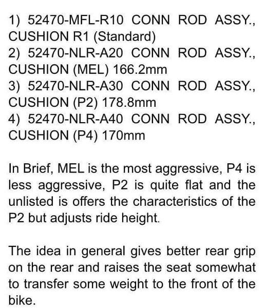

  8. RC45
    RC45 Active Member
    Jul 26, 2017
    435
    299
    Interesting how Lust offer all those options but don't include an indication of what the changes in specific linkage and dog bones will do.
    This is referring to the HRC options: McPints preferred Roads setup is the MEL dog-bone and side plates.
