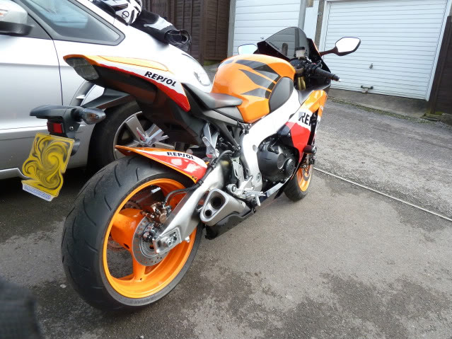

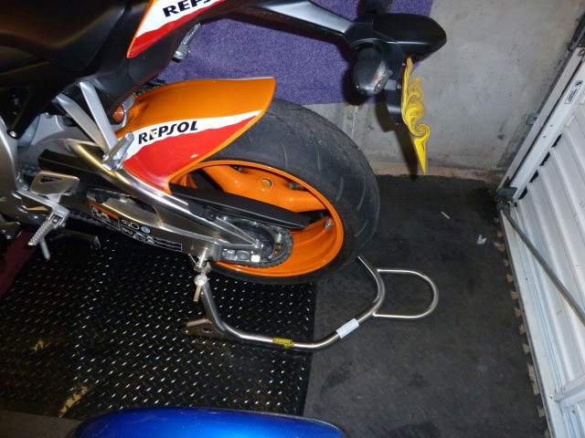

    had my Honda repsol hugger fitted and after 1700 miles not a issue. just fitted a washer to the bolt by the abs wire and works fine

  15. Remal
    Sorry does not show much from the pics i have online but where the ABS wire is on the right hand side of the huggger. I just fitted a washer to lift the hugger over the abs wire. I keep a eye on it to check its not rubbing and its been fine. They are old pics before the tail tidy and can was fitted
