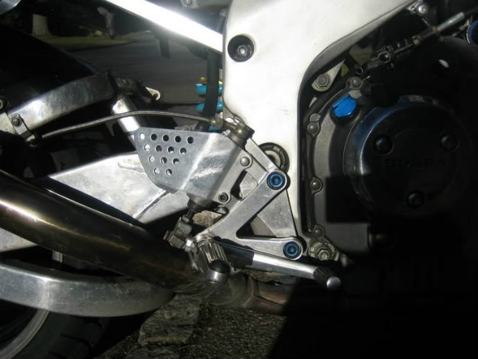

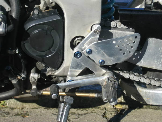

    I made my own lowering brackets mate, but they aren't adjustable?

    I have dodgy knees , so I brought them forward and down 3"
    No reason why you can't make yours adjustable for height using adaptors and possibly a spare gear linkage rod, but don't forget, one end has an M6 LEFT hand thread!!!
