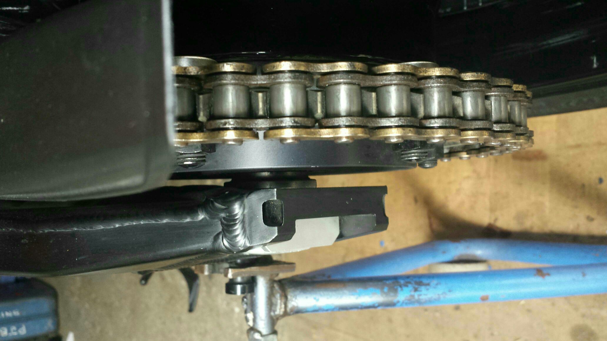

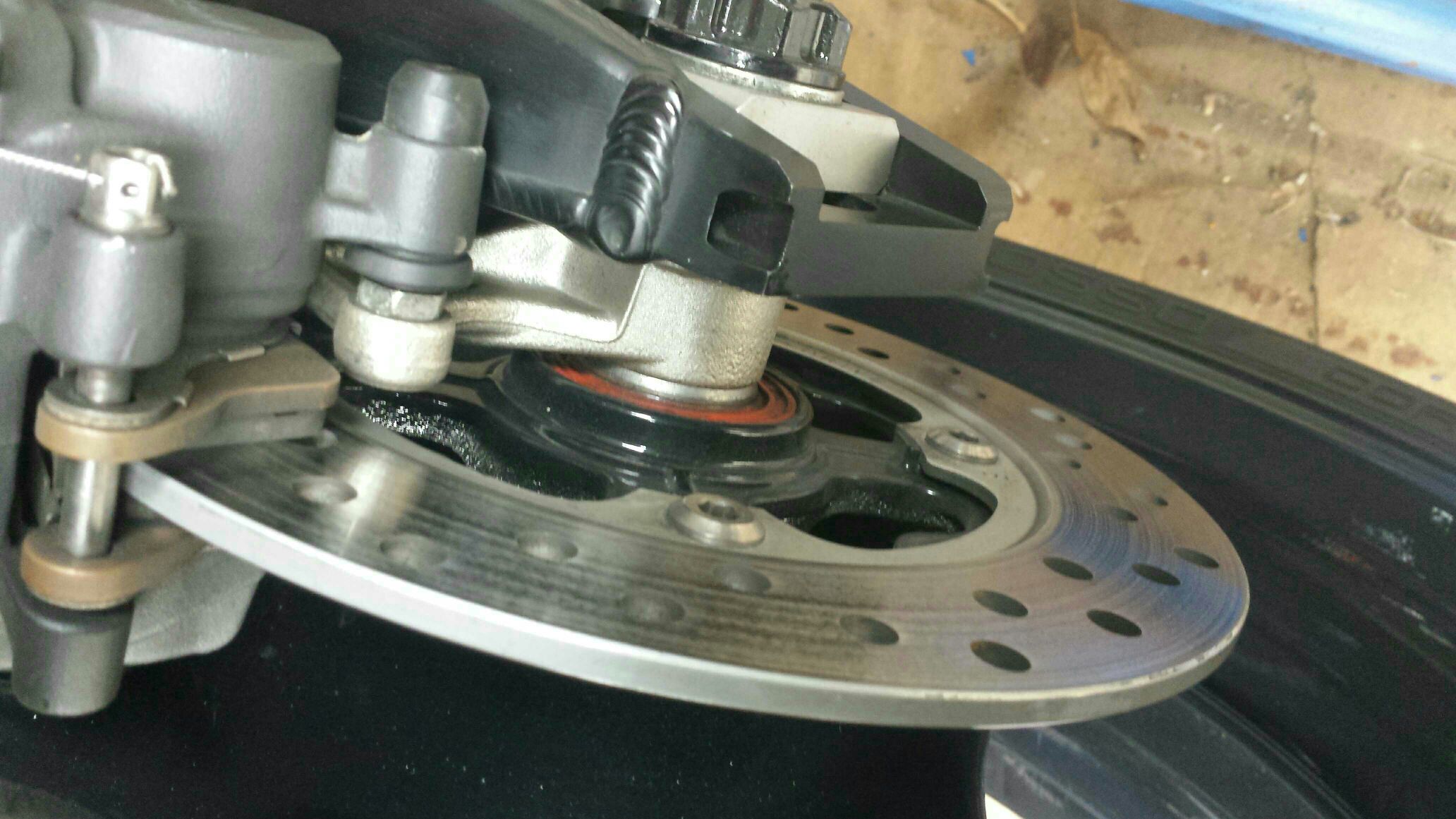

    If your on a 08+ blade then the brake side spacer should be approx 3mm proud of the dust seal[​IMG] remember that the spacer is different on the chain side ie it is a collared (flanged) type.[​IMG]
