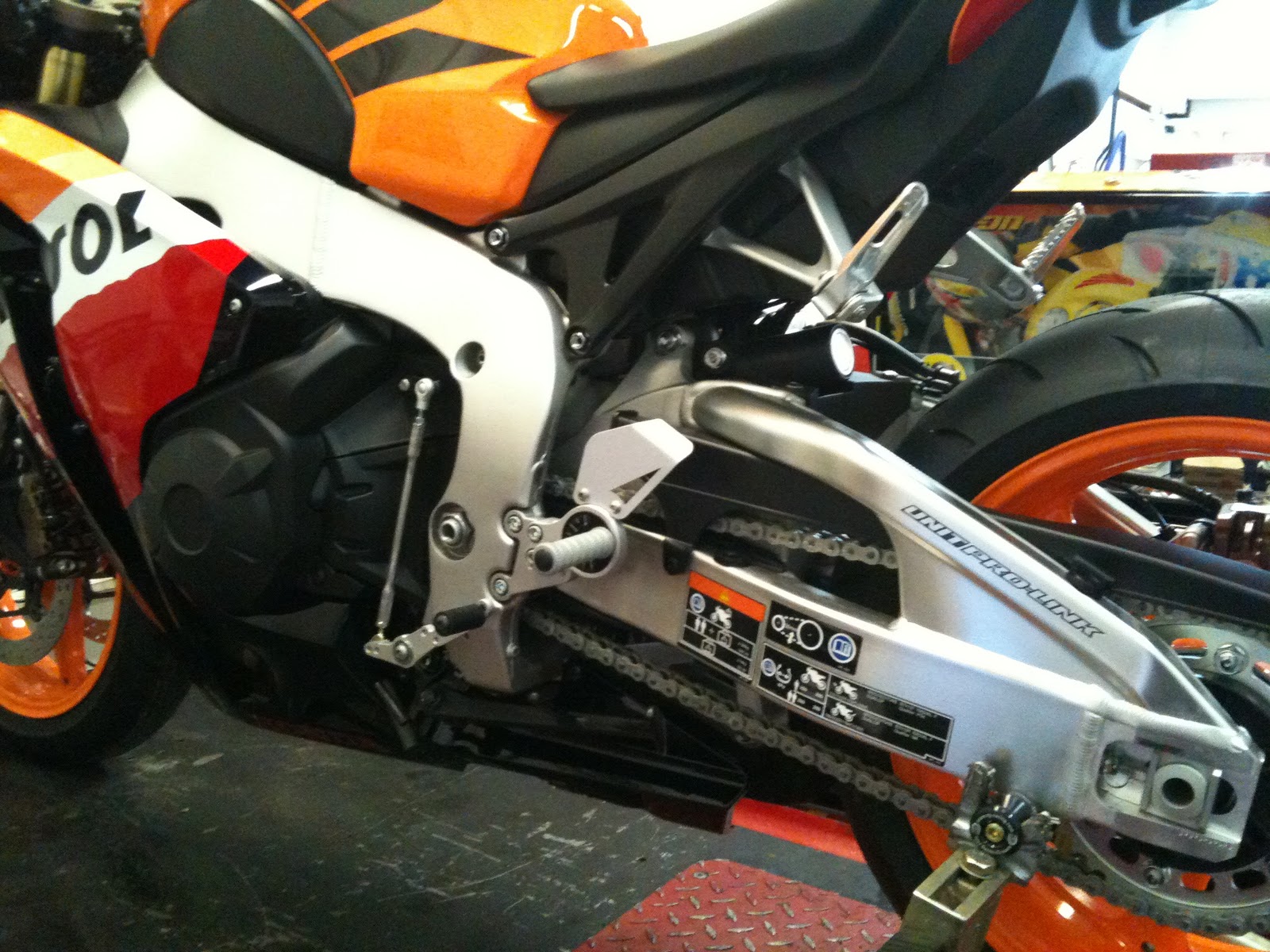

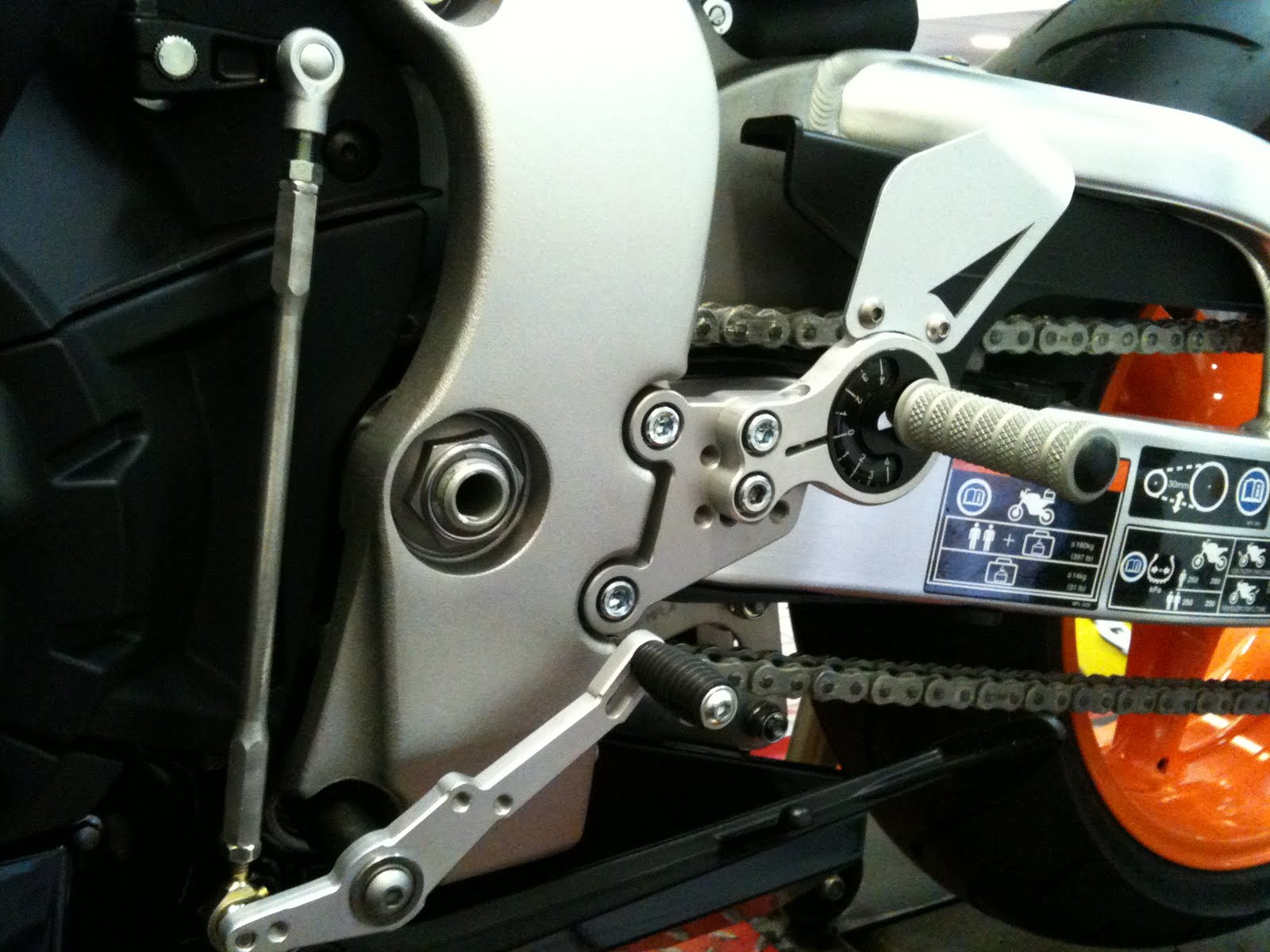

    StudioReinert
    Pictures fitted to a Repsol Blade

    The silver is what i was thinking to match my silver frame. it says in the description " carbon heel plates " but its in brackets.. ill email them to see if it is an optional extra

    Looking at the photo I think you need to fit the shift rod to the next hole back on the gear lever. The rod should be as close to 90 degrees as possible with the shaft on the gearbox.
