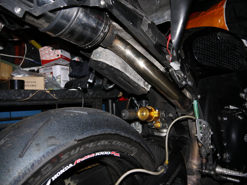

    Just had a quick look under the tail and the previous owner has indeed removed the heat shield, but riveted a different type on the exhaust side of the battery cover.
    See below, but bear in mind mine is a track bike, so you may need to consider your plastics.

    ive just taken them off and found the plastic side cover that you can replace with carbon is now only held on with one screw, do you advise running without one, (or does this burn into leathers) or is there a way of mounting for two screws. thanks.
  9. Muffking
    5,837
    2,831
    It's probably held on with one screw as the rear foot peg was removed, which houses one of the other mounting points for the heatshield cover. You can make up a P shaped bracket to hold the cover on properly, or just remove the lot as is the case on my track bike.

    Ah yes its because I removed pillion sets, thanks both of you for sorting
