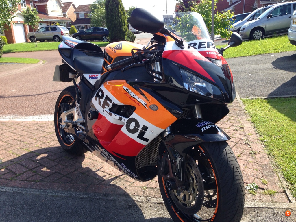

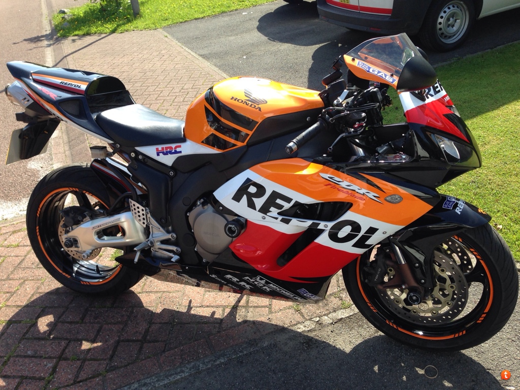

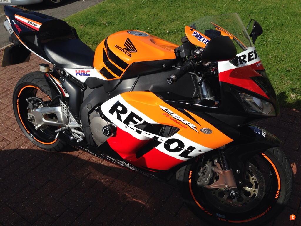

  20. F1reblade
    F1reblade Active Member
    May 30, 2013
    363
    130
    Right the fairing is on, eventually. Took me about six hours all in but this could have been reduced if the previous owner had used copper slip on some of the bolts e.g. Front fender and rear hugger. The finish is very good considering the price paid but there is very little in the way of heat shielding and foam padding in certain areas so time will tell how that pans out. The fit was very good with a little fettering although I had to take the mid fairings off about five times as I used the original inner plastics and the well nut kept falling through the hole which had clearly got bigger over time. With hindsight I could maybe have used the new plastics but hey ho. I bought a new stainless fitting kit as some of my old fixings were corroded but you will need to take old rubbers and fittings from the original fairings. My tips would be the same as previously mentioned in that taking your time is important and patience is a virtue (not one of my strongest qualities). Some of the plastic clips on the inner fairing next to the radiator can be time consuming to line up and had me using words that made my wife laugh, I reckon I even made a few new ones up :) anyway not at all bad quality and for the 05 model putting it all together was really not that bad. I would definitely recommend it to anyone thinking of changing due to the oem's being chipped or pitted. If anyone has any questions please ask and I'll attempt to answer and I'll also attempt to add some pictures to this post lol. [​IMG][​IMG][​IMG]
