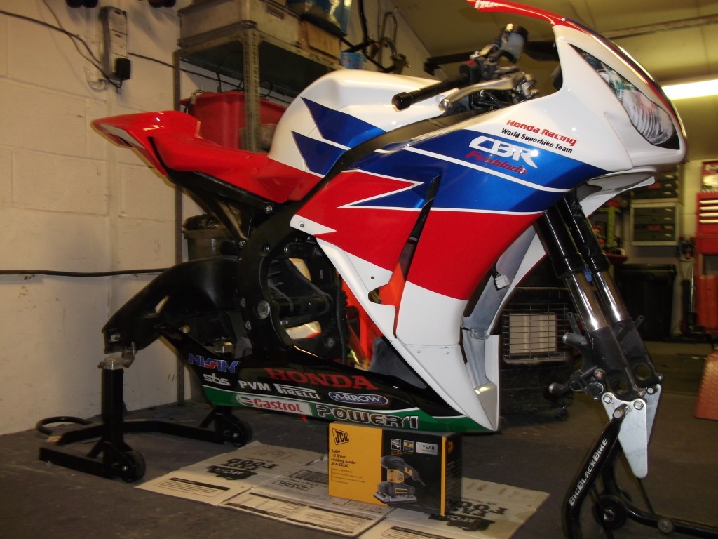

    So I should get my painted track fairings back next week so plan to strip my bike down ready for fairings and conversion to track bike .
    I am planning to put a day time mot on it so will keep the horn but tape up/cable tie up all lighting wiring etc.
    What do I do with the air intakes as at the Moment they fit to the road fairings but as track fairings are pretty basic there is nothing to attach them to .
    While I have it stripped down I will remove rear pillion pegs.

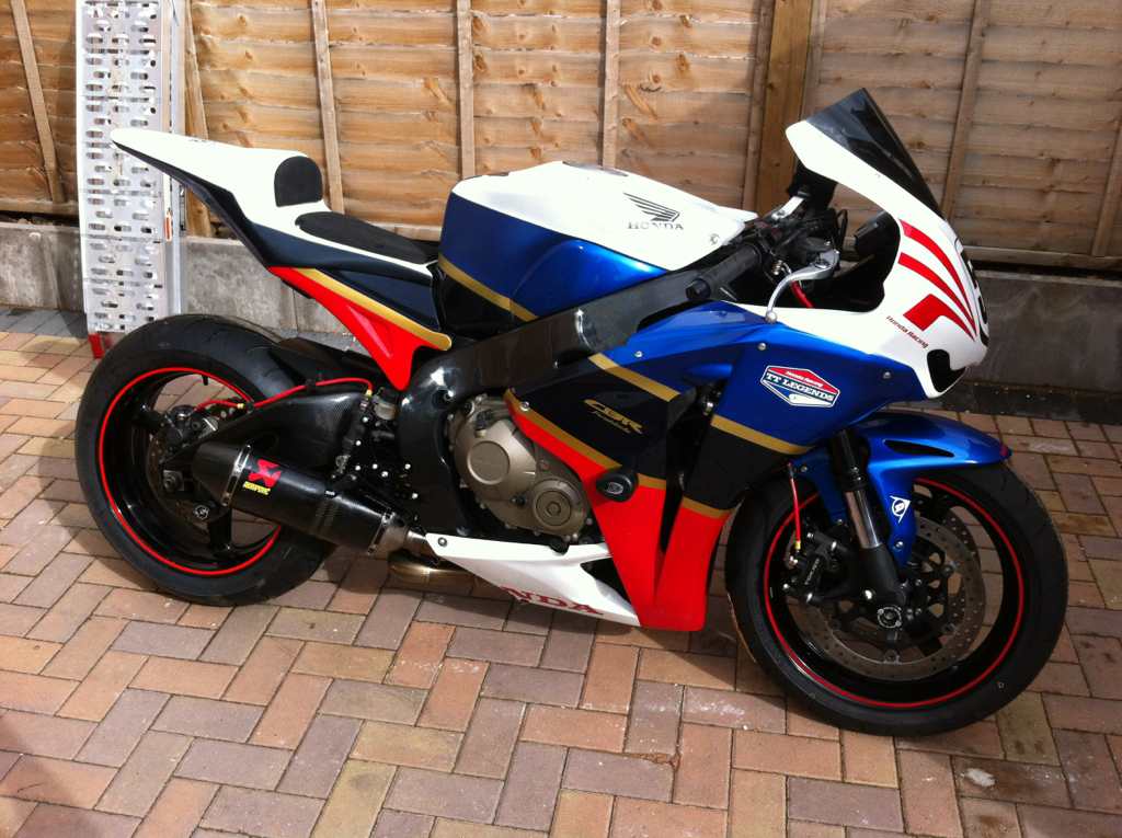

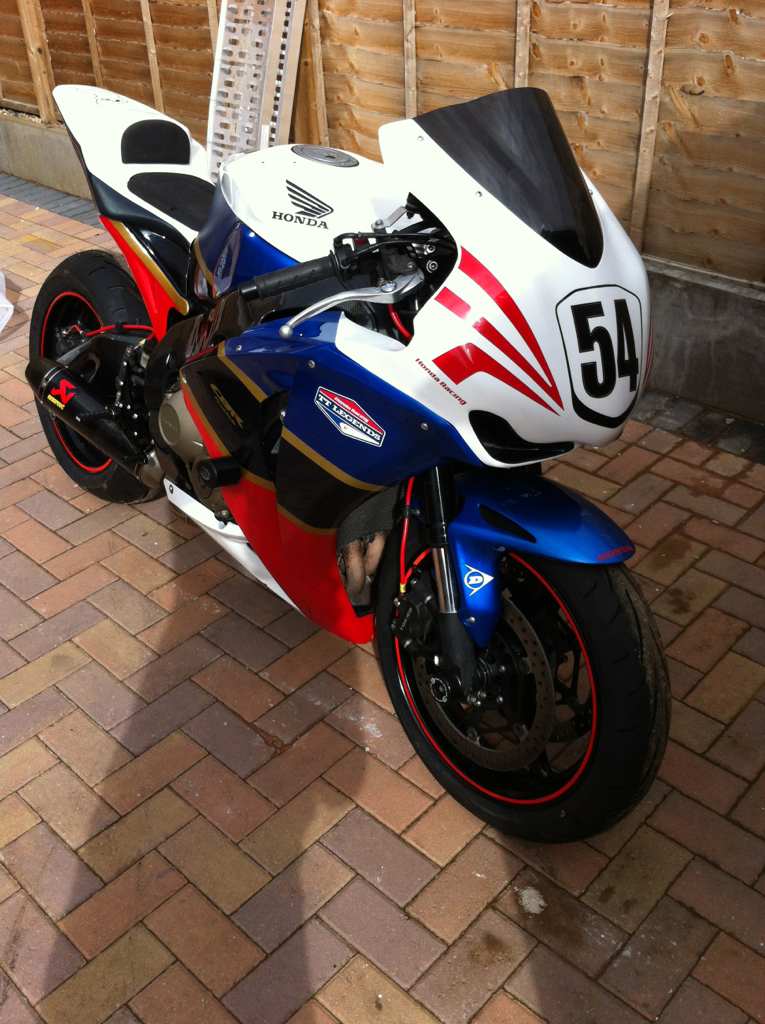

    TT legends with a wsb flavour .Sexy or what :D
