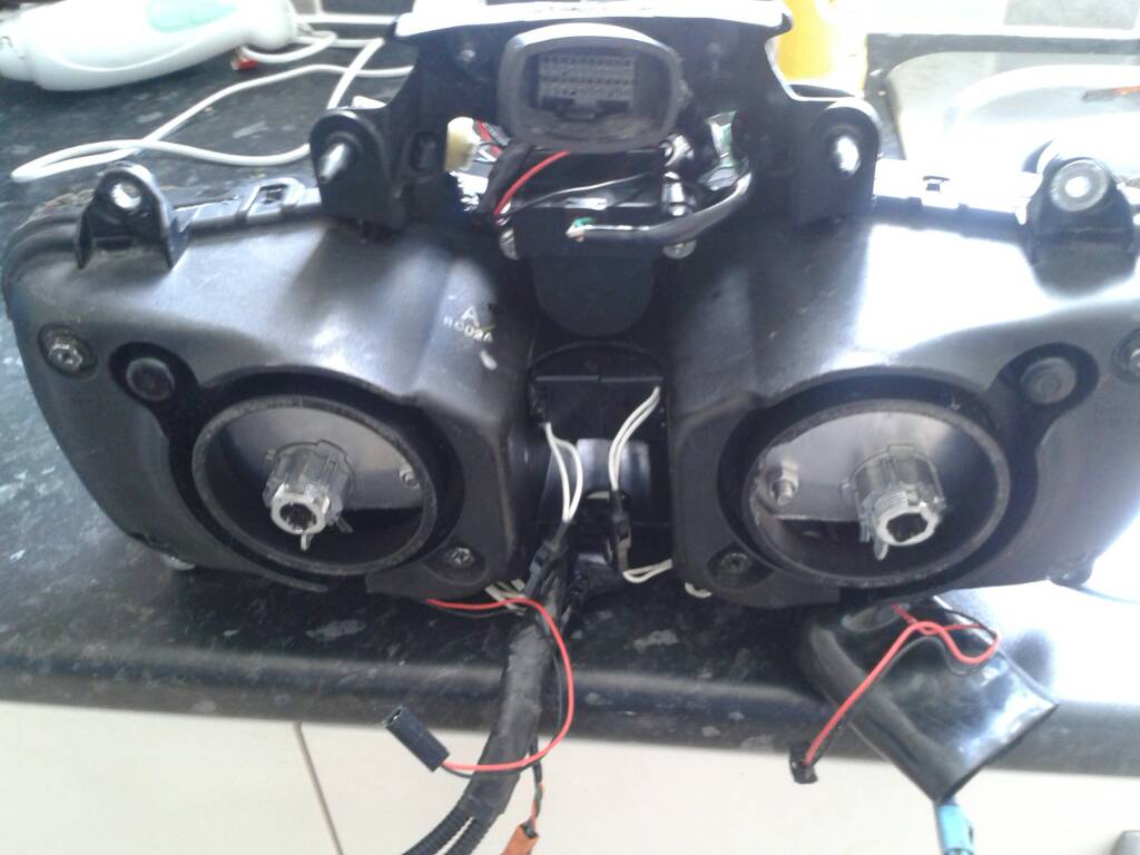

    If he asking how to take off nose fairing he not experiance in stripping that part of his bike! tilt sensor and light unit have to come out. And behind tilt sensor is Phillips screw to take light unit out. Its an easy mistake to do. Ie the comment. [​IMG]

    I have fitted a few projector light in blades and friends of friends have reinstall them back in bikes and not started. So I've been an checked them out an they have had the tilt sensor wrong way:confused: as I've said easy mistake to do :eek:
    So if he stripping nose all the parts have to go on new nose fairing :)
