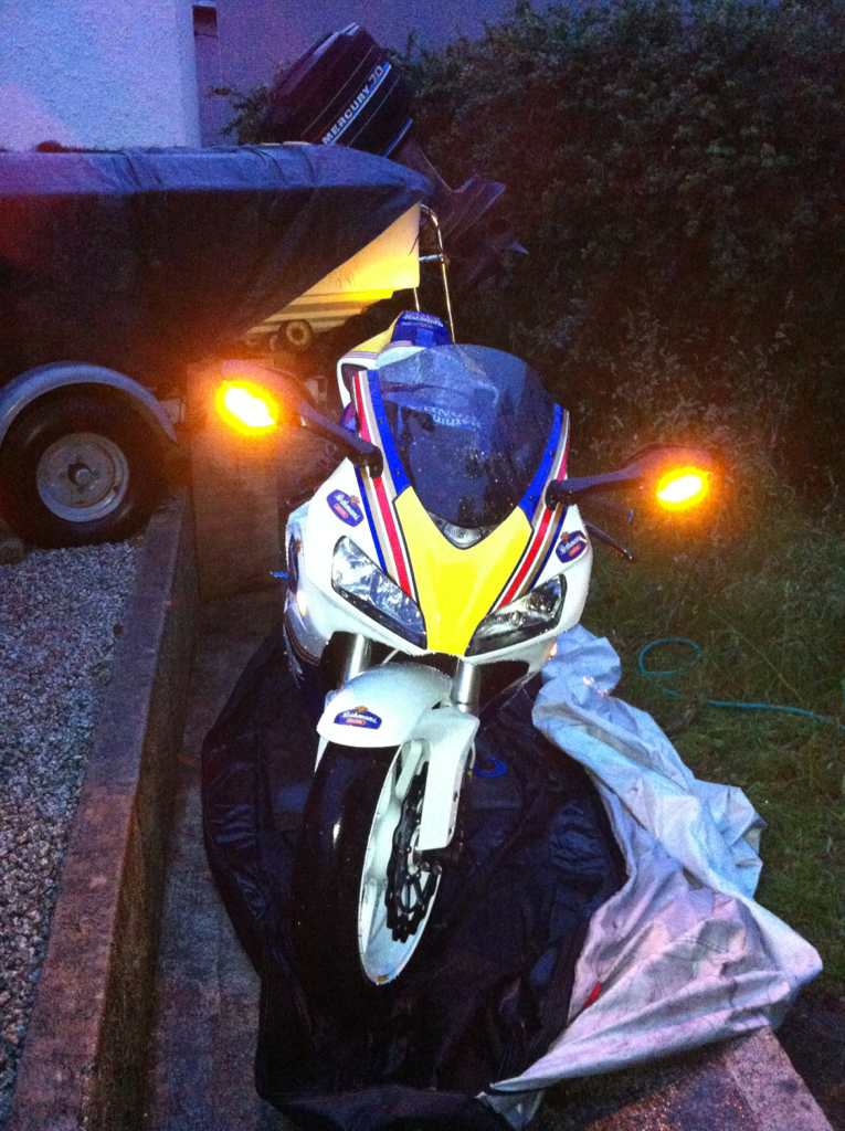

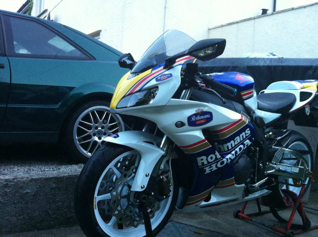

    A very late thread revival, but here's the final results of my mirror swop!
    If you notice the picture with the indicators lit you can barely see the flush mounted side indicators, so I'm well happy with the improvement.

    I went with the ones from the 2011 ZX10R as I think the angular lines of the mirrors fit in well with the angular front of the 04-07 blade.
    They took a fair bit of work to get fitted and the paint where I had to repaint the arms after removing some metal isn't the best match in the world, but they'll do for the time being.
