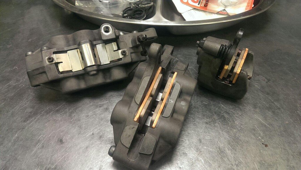

    You need a tool, check eBay for the pliers or expanding piston removal tool, sometime compressed air works, a little heat helps too as it softens the seals, I rebuild them all the time and have both tools, the tool makes it easy!

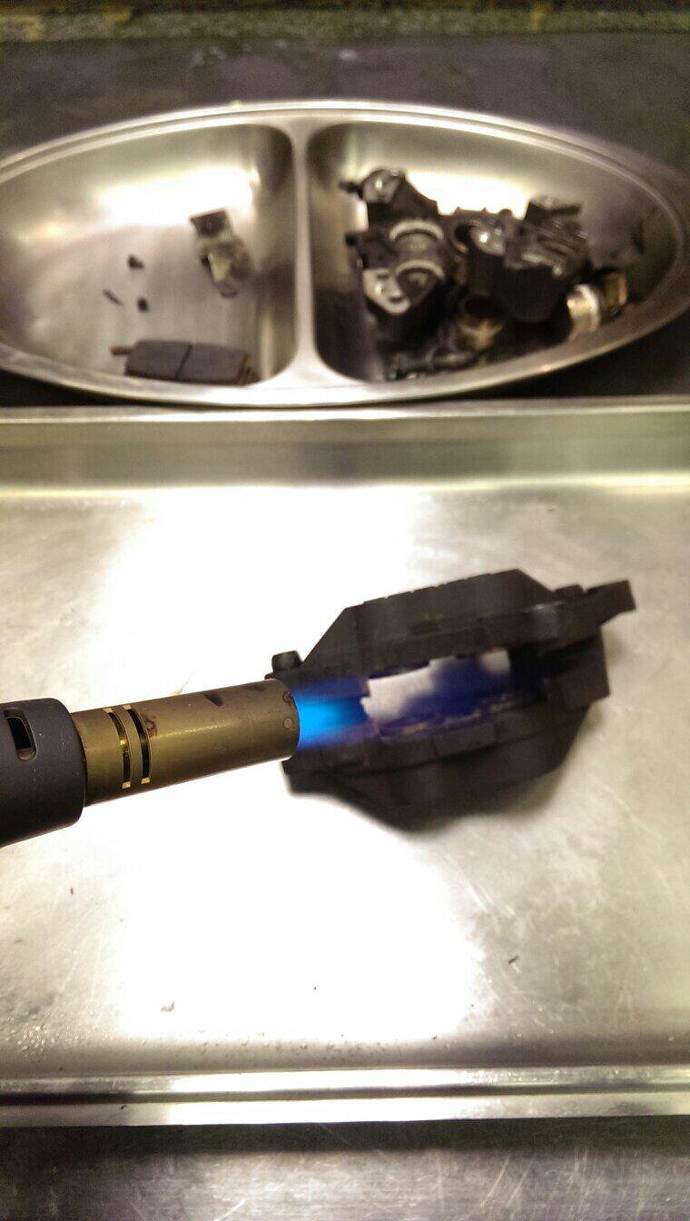

    But before you try all that put the piston back in your vice & heat the caliper body before you try turning it.
