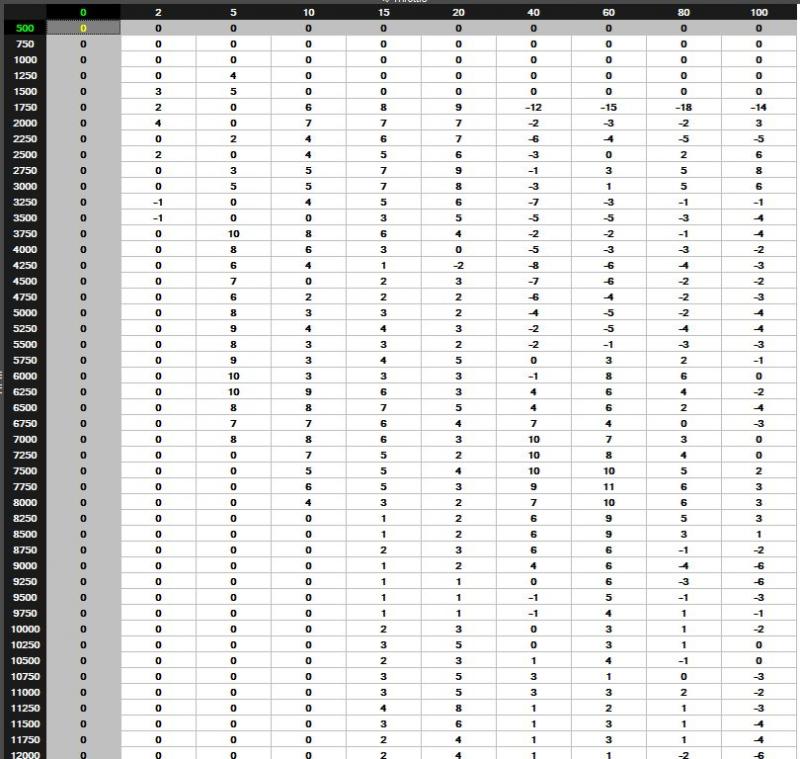

    The PCV map doesn't really do much in that area see generic map for a standard blade
    Most of the benefit may come just from the disabling of the O2 sensor ie the bike wont run closed loop.

    That's not the correct map for mine ... I know as I've just downloaded it :)... one sec.

    what map is that, I'm using M16-002-501.pvm
    2009 Honda CBR1000RR European model
    Stock exhaust
    Stock or aftermarket air filter
    Dynojet o2 eliminator fitted
    perhaps it' been updated.

    M16-002-001.pvm
    2009 Honda CBR1000RR (European Model)
    Stock exhaust
    Stock filter
