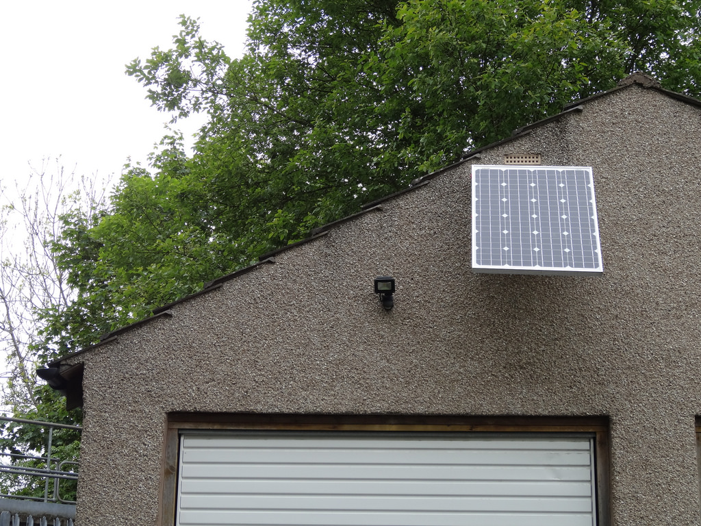

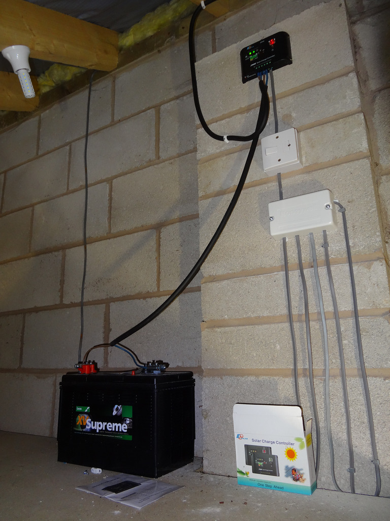

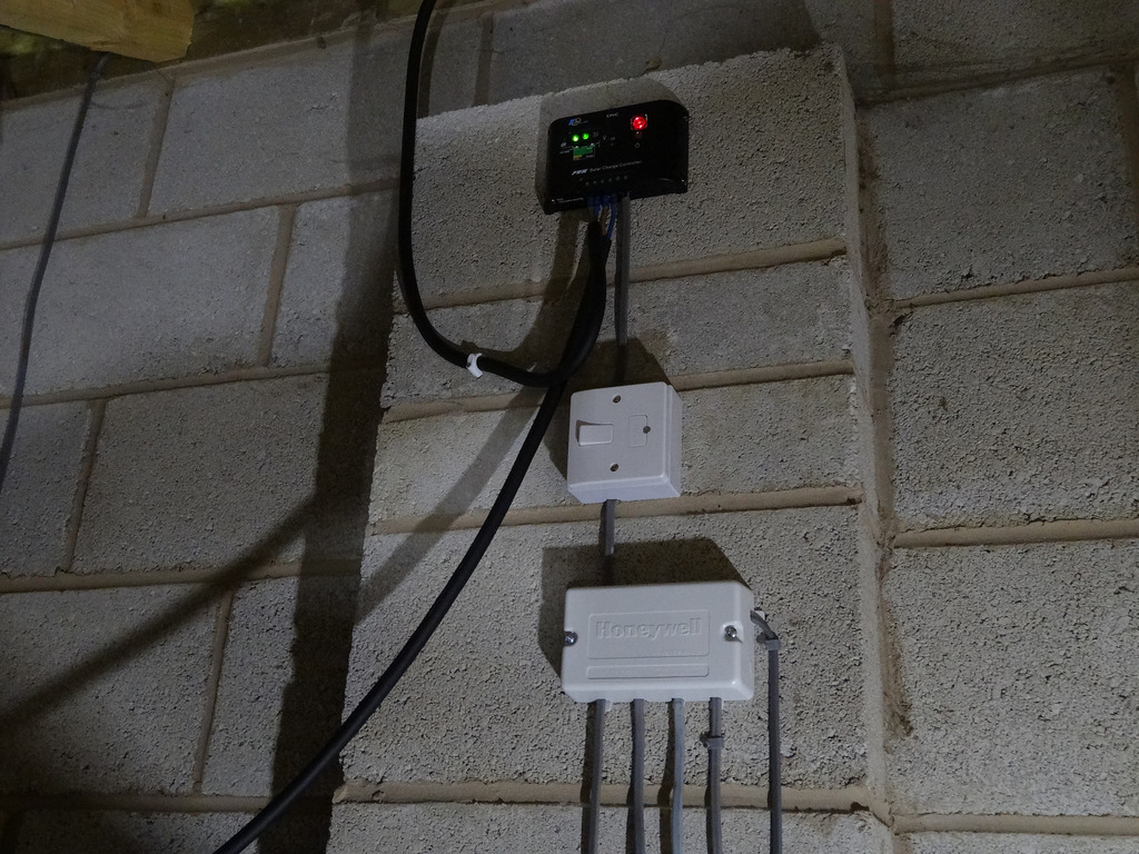

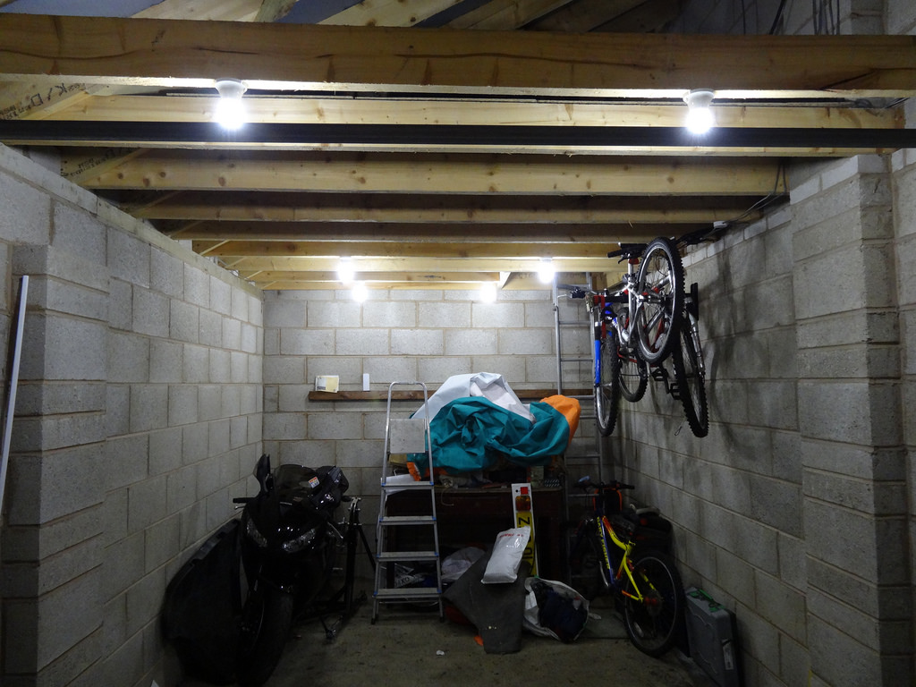

I finally got around to putting a few pics of the solar panel and lighting in my powerless garage. Don't be fooled by the diminutive size of the outside PIR, the performance of this little floodlight is quite impressive. The panel is oversized to take into account a few additions I have planned for later. DSC01553 by rushforthk, on Flickr DSC01549 by rushforthk, on Flickr DSC01547 by rushforthk, on Flickr DSC01545 by rushforthk, on Flickr
I did think about vandals but (touch wood) I live in a reasonably safe area. By the way these panels don't need sunlight just daylight

It depends on a few things. The place where you get the kit from should help, but it helps to know what you are going to run off it. For instance how many total Watts you will be using. But in short I have a 100 amp hr battery and using a very blunt conversion means I can run a 1 watt lamp for 100 hrs or use 10 Watts for 10 hrs. I currently have 6 lamps at 7 watt each that should give me over 2 hours of lighting but I left them on the other day (admittedly it was during the day so the battery would continue to charge) on purpose for over 3 hours and they were still going strong when I got back. There is a safety device built into the charge controller that is designed to turn the lights off should the battery get too low. The battery needs to be a leisure battery. Everything is 12 volt.
