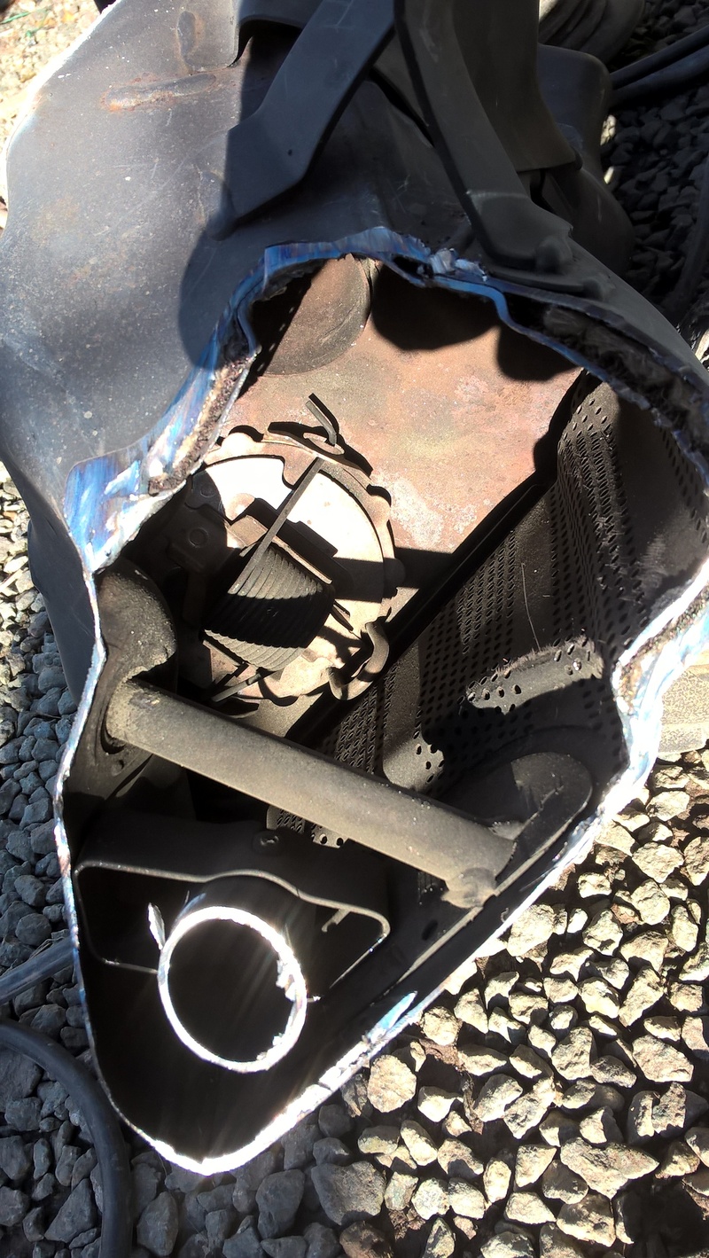

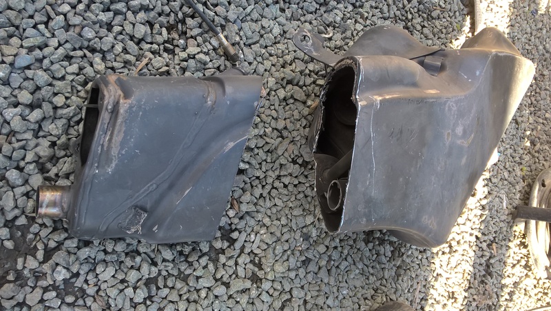

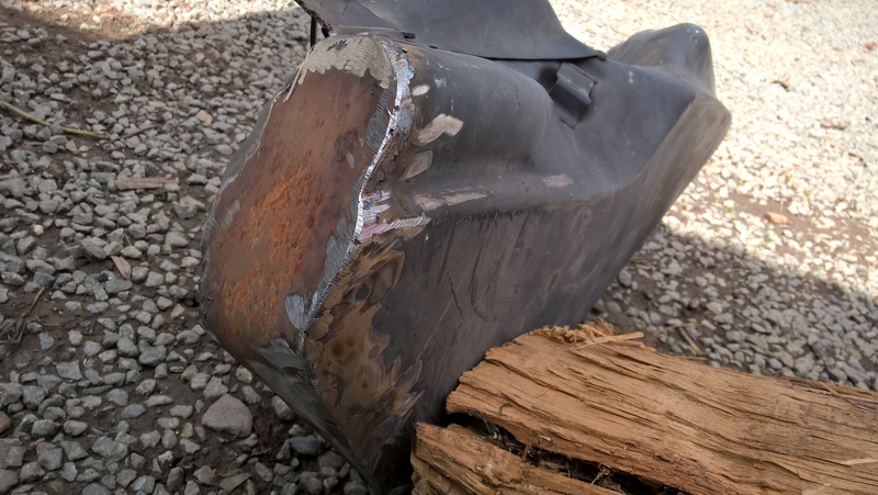

    I bought the bike as damaged, it had been slid down the road,,the original exhaust was smashed on the end, I bought a replacement from on here and, well as you all know they are a bit tame,fluffy sounding so I have modded my crashed exhaust.
    I cut 5" off the end , then cut a 4" hole in the side ,cut out the cat and drilled 7 10mm holes so the gases can short cut the whole silencer but still stop some loud noise.

    I've just bought another standard can too! My plan is to cut it open and gut it, then maybe put some pipes in it, so it looks standard but sounds nice.

    weld the end over
    oh and remove the over pressure relief valve

    I know where you are coming from Dave, but don't worry about it,,we will play
    I found the Titanium header pipes at a scrapyard, they had a complete four into one set ,off what they did not know,so they cut it up to see inside,doh
    Anyhow , as for the sound , I am very pleased,,i did not want full straight through,had that,had ear ache travelling to Mugello.lol
    in the Swiss tunnels it was good,,no this is so much better than original but not troubling the ear plugs, a very nice deep rumble.
    Very pleased.
