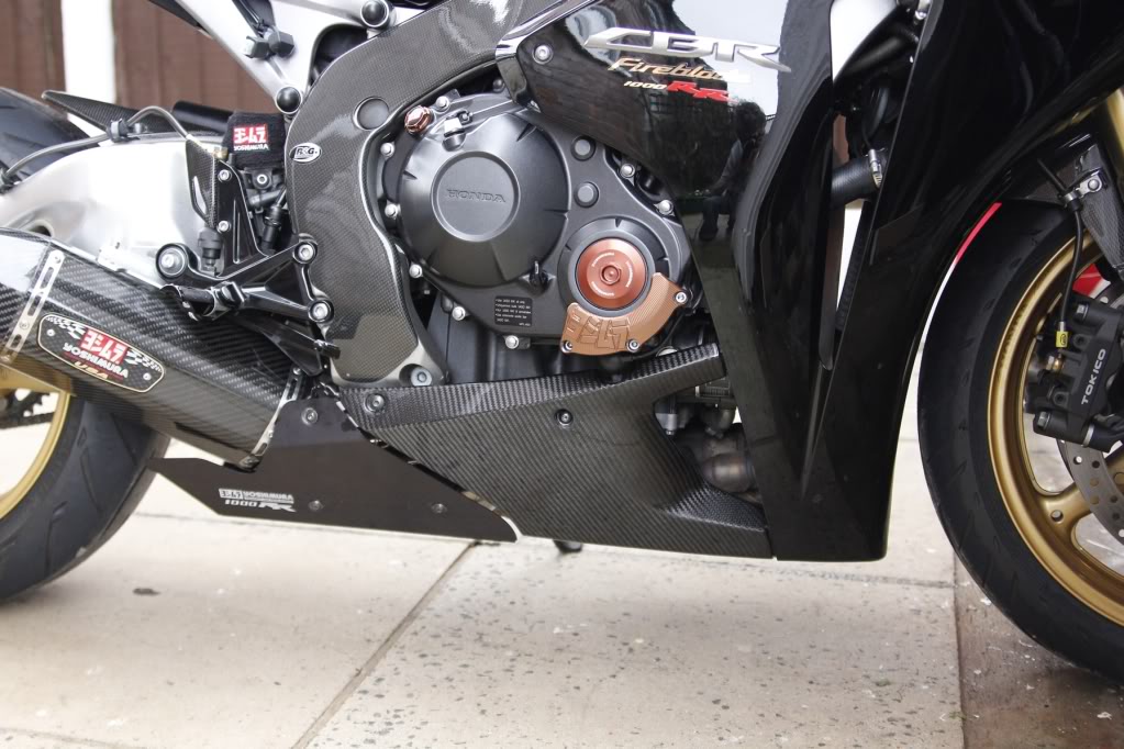

Eyup, I would like to spray my rear sets black, can any of you suggest some paint?? I know powder coating will probably get mentioned but I'm buying tyres and a PCV this month so wanna keep it on the cheaper side... Here's a pic of my bike.. I think black rear sets would finish the look what do you think?

i would get them powder coated, a really good option if you dont have the extra pennies this month, bike looks great by the way
