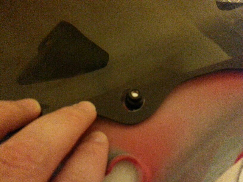

    I have got an aftermarket double screen .....
    the holes in the screen are about 15-16mm
    The holes in the upper cowl are 5mm ....
    the well nuts i have (even at full tightness) will pass through the 16mm hole .... how do i mount this screen
    All the screens i have had in the past have been the same as the stock one!

  3. ColinBR
    What brand of screen is that?

    It's a cheap Chinese one... I think

    was it miby made for a race fairing mate? cant think of anything else, the rubbers fitted from the OEM unit into the Powerbronze screen I fitted and were tight push fit had to put the rubbers in hot water to make them more pliable for fitting.

    Yeah thats what i'm used to ....
    but i have seen other screens with the same style fittings!

    Couldn't you get some stainless washers that the rubbers are a tight fit into, then push the rubbers through them so holding the screen tight

    fletch can you not just use the original OEM screen with the aftermarket fairings?

    Washers will leave metal against plastic, leading to vibration fractures, which is what the rubber is supposed to prevent. Nylon and rubber washers is the only alternative I can think of.

    It looks like MSA screens are the same ....

    I can vouch for MRA screens if that's what u mean.
    I have them on both the blackbird and fireblade and they fit perfectly.
    German engineering :)
