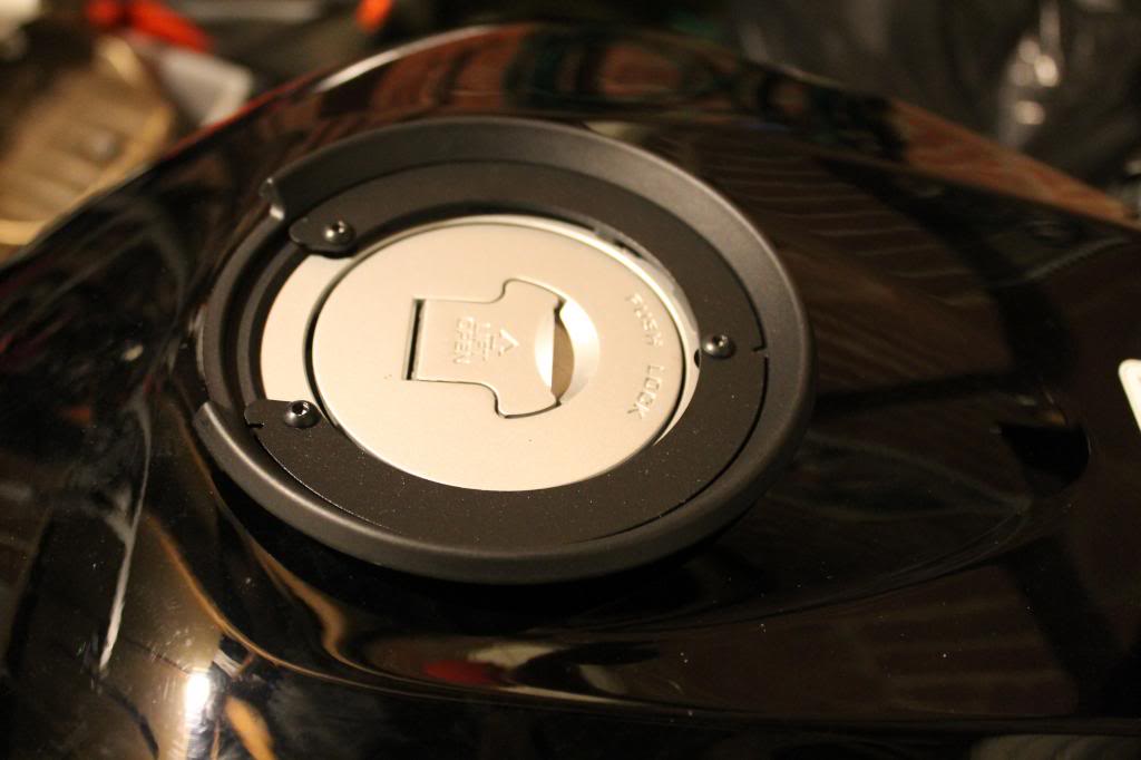

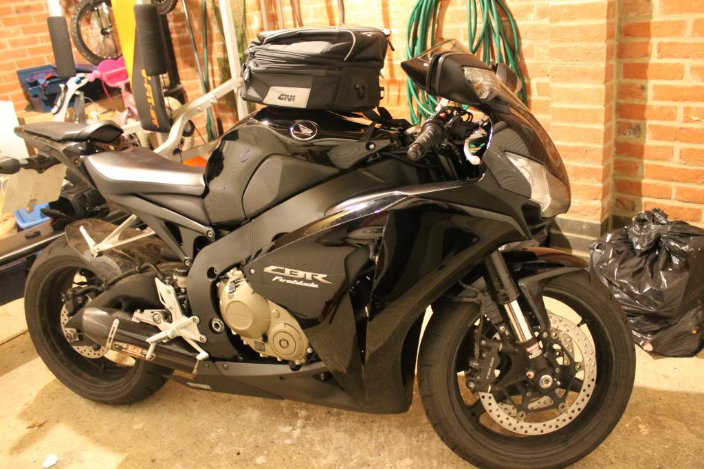

    Sell it on ebay and buy a Givi qiucklock tankbag.
  3. Dave V
    Dave V Elite Member
    Jan 5, 2012
    2,345
    1,865
    +1, tank lock systems the nuts.
    The only think is if you have a carbon pad thing of the petrol can you'll need to get longer bolts

    Tank lock is a good system but even with longer bolts to go through the carbon pad the fixing ring gets bowed and the bag comes off at shall we say 'higher' speeds FFS! thanks to the strap I still have the bag! - I took my carbon pad off and it worked as it should even at double the national speed limit - private road I think it was... :)

    I love my tank lock givi
    Mines the 25l version but not recommended if you have a beer belly lol
