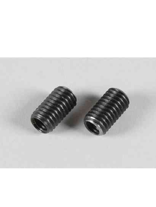

Hi, Anyone know where I can get these in the UK please only found in Europe so far... Want to go from M8 to M6 only need 1 Cheers
Would it not be easier to get a new bolt made to fit the requirement that you are asking? What is it for?

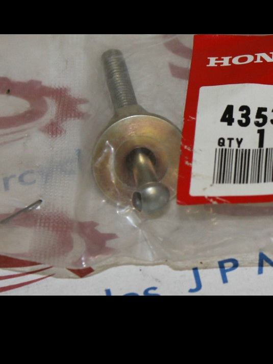

No. It's for a rear mastercylinder push rod that uses M6 thread to go into a Gilles tooling brake cylinder adaptor that accepts M8, so need to reduce the adaptor down to M6 to accept the rod.
thats a helicoil kit matt,more used for stripped threads that you cant re tap (basically retaps the thread,but keeps it at the desired pitch). not sure it would be ideal to reduce the thread pitch.
Still easier to make a new rod mate. One end M8 the other M6. I can do that for you, does it have left handed threads though?
This is the rod But I was just about to suggest might be better looking at the adaptor, didn't realise they were called clevis joint, that's spot on mate should be just what I am after! Thanks for the link!
