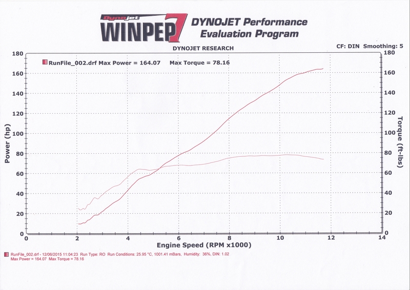

    So....... After Honda claimed a very slight power increase on the 2014/2015 bikes of about 2bhp what was the difference, having fitted exactly the same items.
    The results show a gain of 1.5bhp (164bhp compared to the 2011's 162.5bhp), but a very slight loss in torque of 1.8 lbs (78.16 lbs Torque on the 2015, compared to 80. 02lbs on the 2011). But you can quite clearly see the smoother and better power delivery in the lower rpm range (2k - 6k rpm range).
    Ambient temperature was 19deg.
    Humidity 93%....... This didn't help...LOL.
    All off this means not a lot really, and I fully appreciate these figures are altered by weather conditions, ambient tempreture, humidity, and dyno's vary over time. Today we had an ambient temperature of 19 degrees but 93% humidity, not the best for giving big figures...... But Hey Ho.
    But at the end of the day, the ride is very smooth, no flat spots, no hesitation, and the biggest difference over stock is how smoother it is at low rpm. My bum dyno cant tell any difference in acceleration, but I can tell the difference in the smoothness of the power delivery, as said especially at low rpm.
    Money Well Spent for me, and it just makes the bike even easier to ride.
    Love it.

    Yes, I ran it there with your map, but it was running slightly rich in most places. Which suited me, that meant I didn't risk running lean and doing any damage on the way there.
    But still a good base map for them to modify.
    What Torque and BHP figures did you get with your map....... and was the power and torque curves similar ???

    Good result Jim

    Yep, happy with the figures Steve, but more please with the smooth power delivery.
    Would have liked to do an overlay of the two power graphs, but that's way over my computer skills and the graphs are slightly different too.
