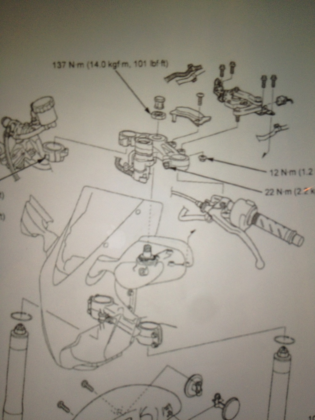

Hi All, Trying to find the torque setting for my 2012 Blade top yoke nut. I have seen on other forums the figure of 103nm and another which states 137nm. Can anyone give the correct one please Cheers Dave
Diff Yoke/Triple Clamp on the Showa BPF Forks fitted to MY12+ Bikes hence the confusion. 137 NM it is.
