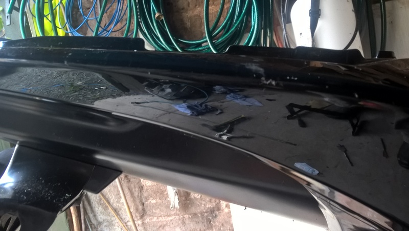

    I have looked at the seat ,tail unit of my 09 blade and noticed two cutouts in plastic tail trim under the seat
    And thought I could fit some flat steel in there to make a pannier stay.

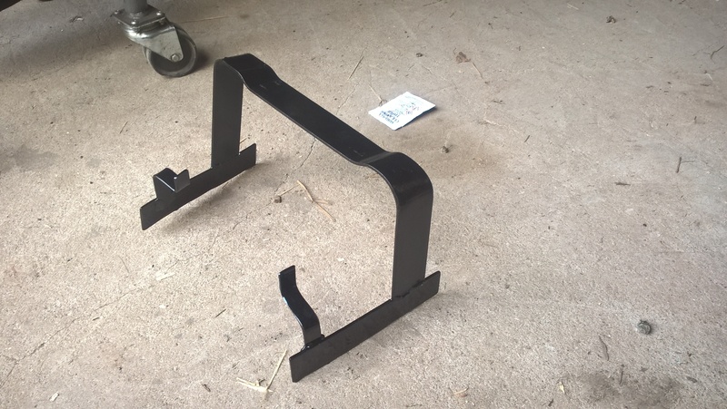

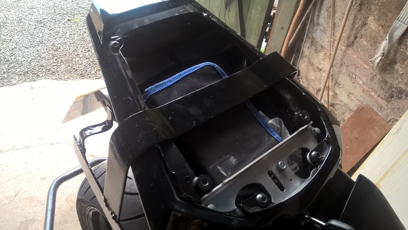

    So I made this

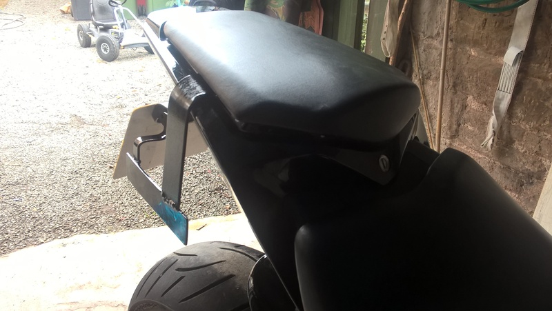

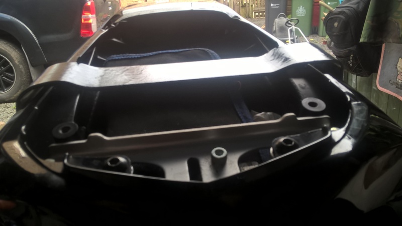

    And it fits nicely under seat unit , seat locks it in place, it then stops the panniers closing in towards the wheel

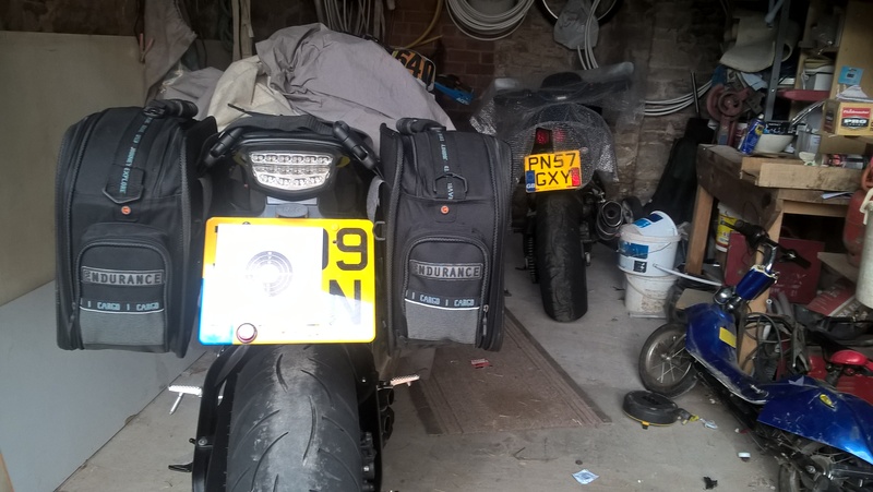

    So now the panniers hang tidy,,lol
    I recently fitted an intergrated rear light so I could remove the indicators as they were also fouling the panniers.They can go back on after the euro trip.
    Seat fitted

    Neat solution to a degree, but think someone needs to go to Welding School! :eek:
  5. Slimwilly
    Slimwilly Member
    Jan 25, 2016
    408
    109
    Partly user error , partly poor quality welder ,lol
