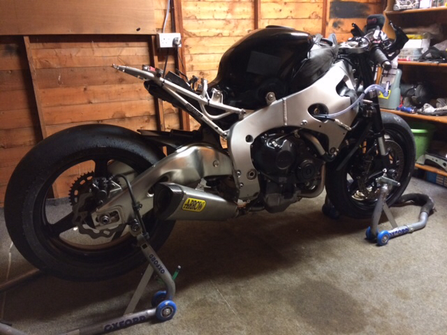

    Finally got my HRC bottles and bracket through. After a bit of fiddling about, I managed to get them fitted and all plumbed in
    Ordered some carbon frame guards from Pro Fiber this weekend so I'll be fitting these during the week, if I get a chance.

    Fitted full Arrow SBK system this evening
    Got offered a set of ex TT Legends fairings from Michael Dunlops 2013 bike. In real nice condition, so bought them rather than instead of going with my original plan. Should be with me before Christmas.

    Where does the 2nd bottle pipe go to?
  17. RepsolRuss
    RepsolRuss Active Member
    Feb 24, 2012
    487
    209
    Second bottle pipe goes under the rank. It's a tank breather :)
