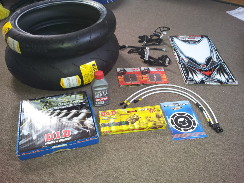

So this is what i have bought her over winter, getting most of it fitted tomorrow as i am finally on holiday so should be able to get some pics up tomorrow night
They are diablo rosso corsa's (55). I actually bought them a few months ago when they had £25 cash back on them
Dunlop Sportsmarts deal ends 27th Feb. Monday £209 +£7 P&P for the pair. You can have either the 55 or 50 rear profile also if interested ring chris via Clevedon Motorcycles and mention remal and the 1000rr.co.uk group buy
