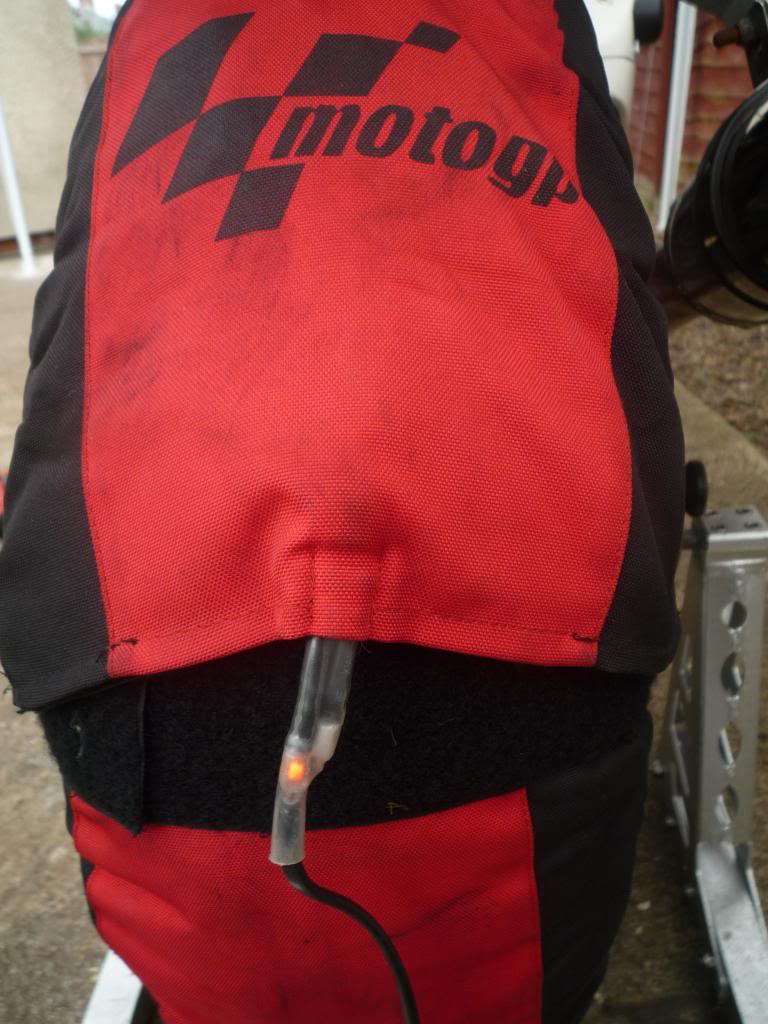

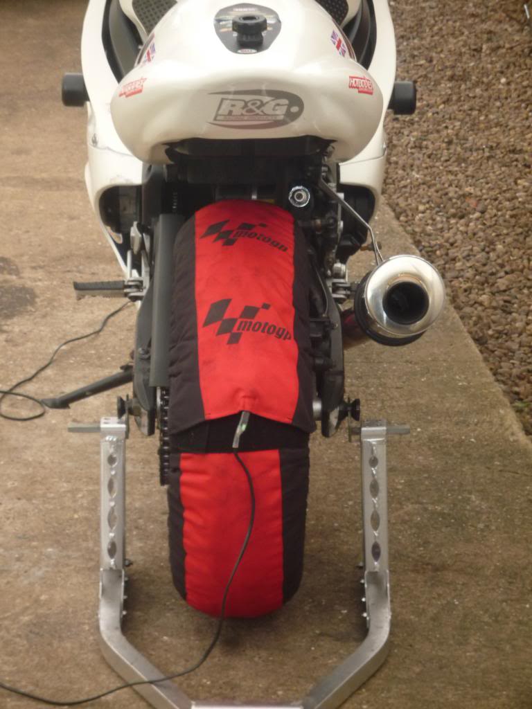

    Been out testing the tyre warmers that arrived this morning. £80 for a 2nd hand set off ebay (wanted a decent elasticated set after reading peoples comments on the forum).
    They get proper hot, I can almost burn my hands on them. The bonus is that they run off my little 720w generator to, so I'm sorted for Cadwell now :)
    The questions are:-
    1. How much towards the edge of the tyres are they supposed to heat, as the edges feel much cooler, especially the front.
    2. Am I right in thinking that the red light is to tell me that they are warming up and the green light is to tell me that they are up to temperature, as the red light doesn't work on the front and the green light doesn't appear work on the rear (although I can tell the state if either lights are off).
    3. I was going to change the Pirelli Dragon's to Michelin Power One (2CT), but the Pirelli's seemed softer when warm. Any thoughts on if I should fit the Power One's and just trust them?

    1) The warmers will cover your 120 front and 180/190 wheel fine, they will be on the wheels for 30-35 minutes between sessions so will heat the whole tyre fairly well, you can get skins for the sides so its completely contained. When you come off track you already have heat in them so the warmers just keep you ticking over, the idea is to get the heat right into the rim of the wheel from what I've heard. They also put the tyre through less heat cycles, so increase the longevity of them. I always give it a lap before I start leaning right over.
    2) Yes the red light means they are on.
    3) Any tyre you put on is gonna soften up when up to temperature, I'd try the power one's and see how you feel. I've always ran SCs/Sc2s/Racetechs so far, both have shit loads of grip.

    1 - They should heat all the way around the tyre
    2 - Red means thery'e heating and green means there on temp
    3 - No idea about those tyres, I only use race tyres(slicks, racetecs, SC ) not street tyres...
    You will find that the motogp tyre warmers don't heat up to the proper temp 80°, I've tested different warmers and these ones only get the tyre to about 60-65°...
