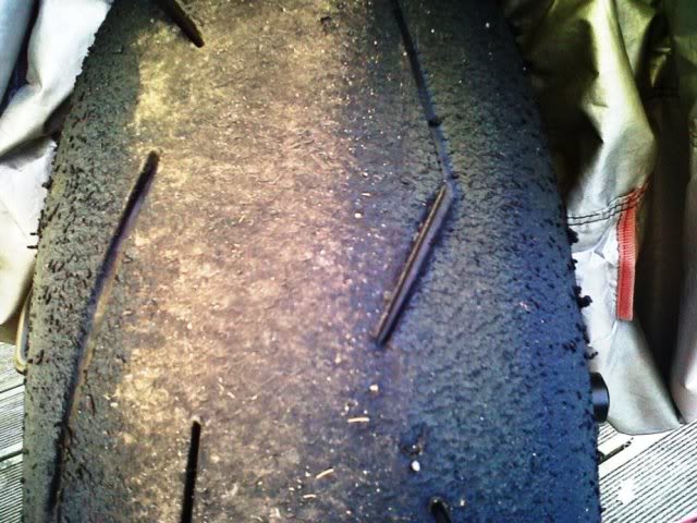

    i know this sounds stupid! but as my rear tyre gets hotter it seems to feel a bit slippery i didnt notice it before as ive only got the confidence to lean further since my suspension was set up
    has anyone else had this with theres? its a pilot power 2ct on an rr5

    er, no. lol. Might be.stating the obvious, but is it old? Or, could be that its so new its not been scrubbed in on the 'fun bits'?

    what pressure are you running, i ran 2cts on my zx-10 2 years ago and had no real issues, just naff all in terms of feedback from them

    On my 600r when I ran 2Ct's on the road, I set them to 32F & 34R Cold. On track days, I ran them 30F & 32R Hot.
    When I started to really push the 2ct's on the track, the would slide when you tried to hold high corner speed or fed in the power whilst on it's side. This was with a bike set up for me with Ohlins rear shock and moded forks. When I reached their limits thats when I changed to sticker Super Corsa Pro's, everything else being right, you may have reached their limits as well ;)

    I have had a couple of bikes that have felt like this and found out from the tyre shop that if the previous owner had done lots of comuting or up right riding the tyres will sort of square off which created a big drop off to the edge of the tyre giving me the same feeling your describing, 2 new tyres solved this straight away

    Might sound daft, but are they on the right way round? Check the arrow on the sidewall, should point in direction of rotation.
