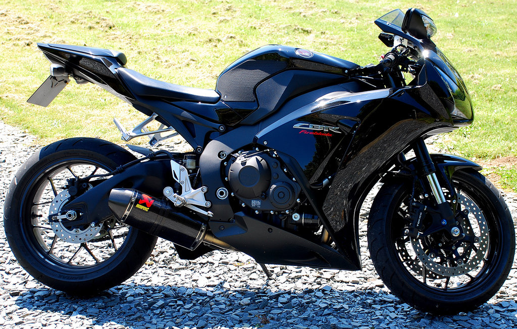

    Recently fitted a full Akra race system and the bike runs fine. I expect a PC and map would make it better but I'm not going to bother (yet) no need for the time being.
    Untitled by (MrB), on Flickr
    As said above, disconnect the exhaust valve cables and the lambda sensor will be fine.
