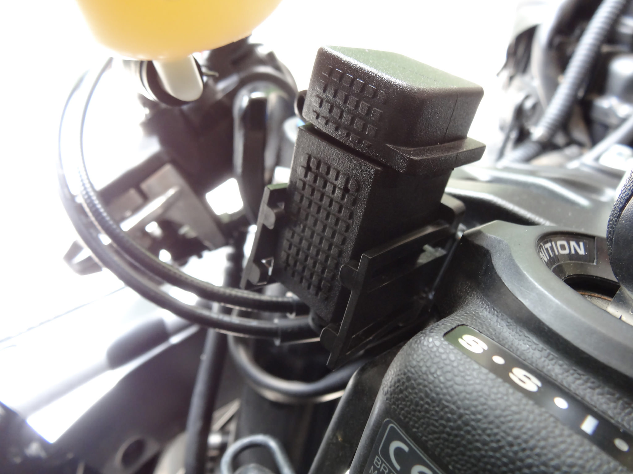

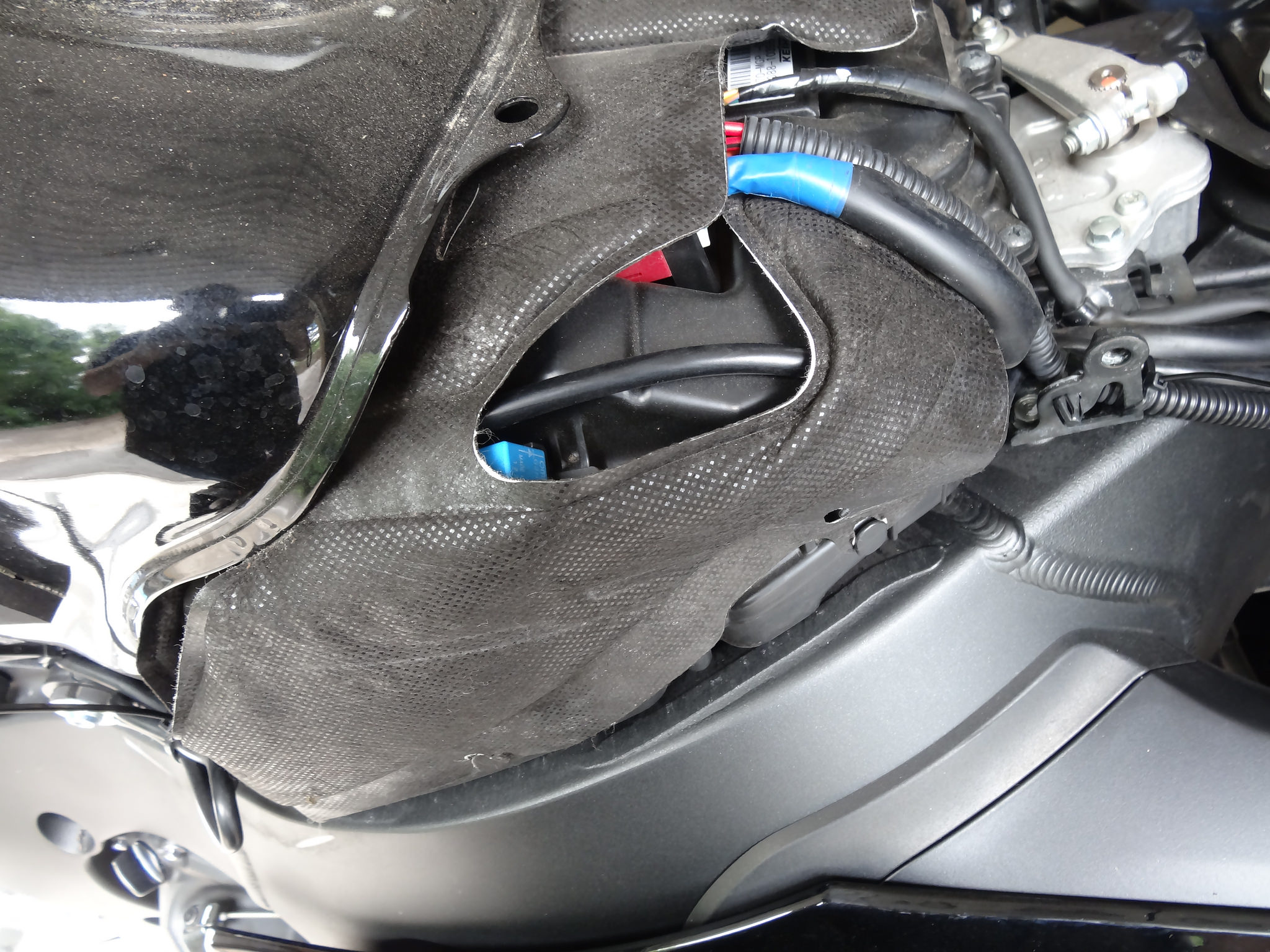

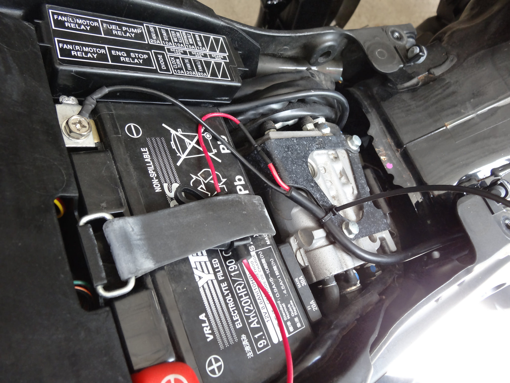

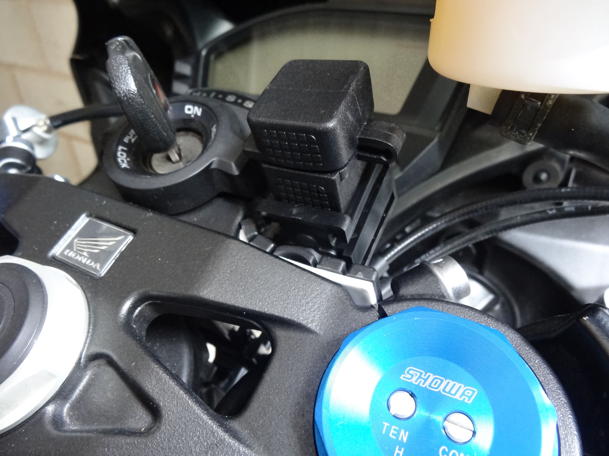

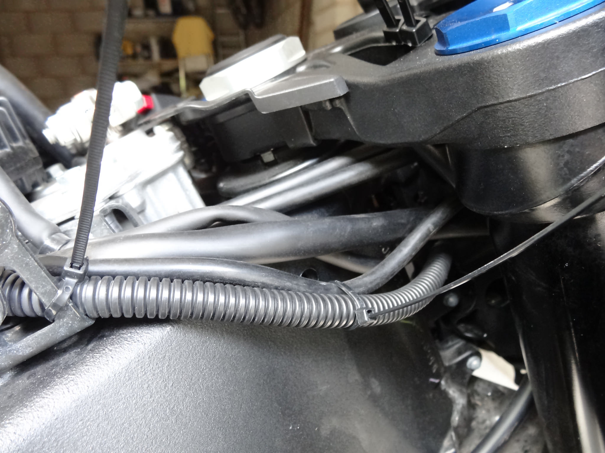

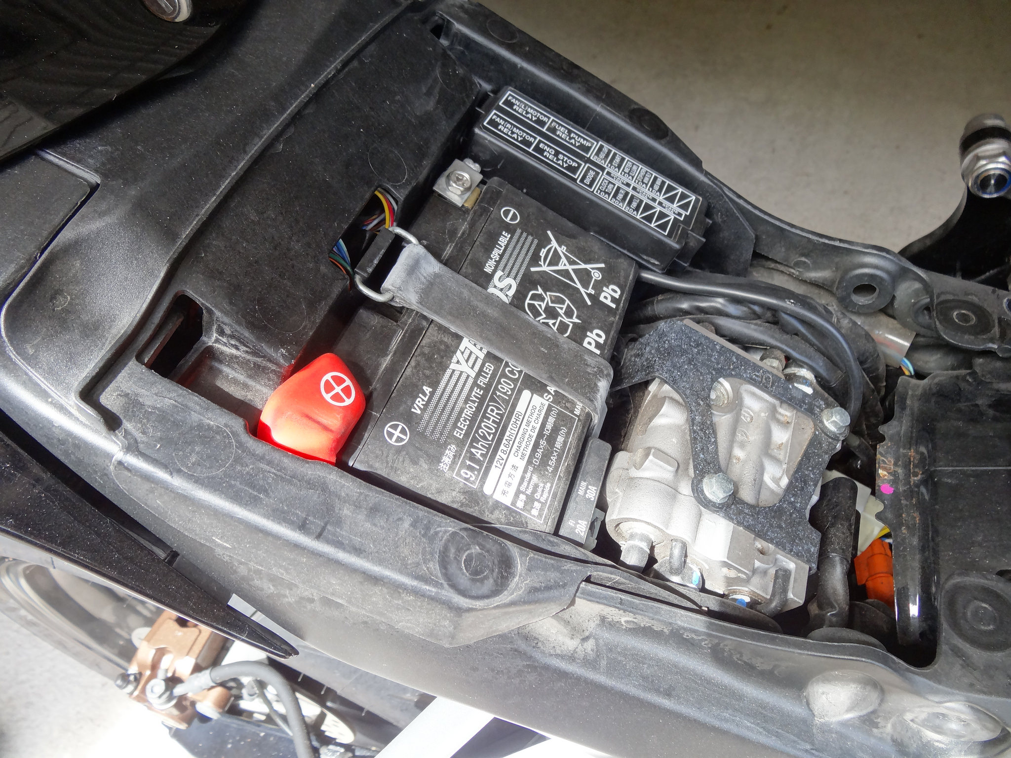

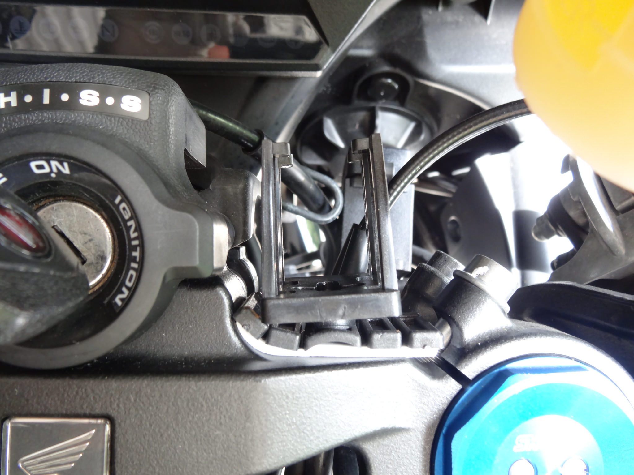

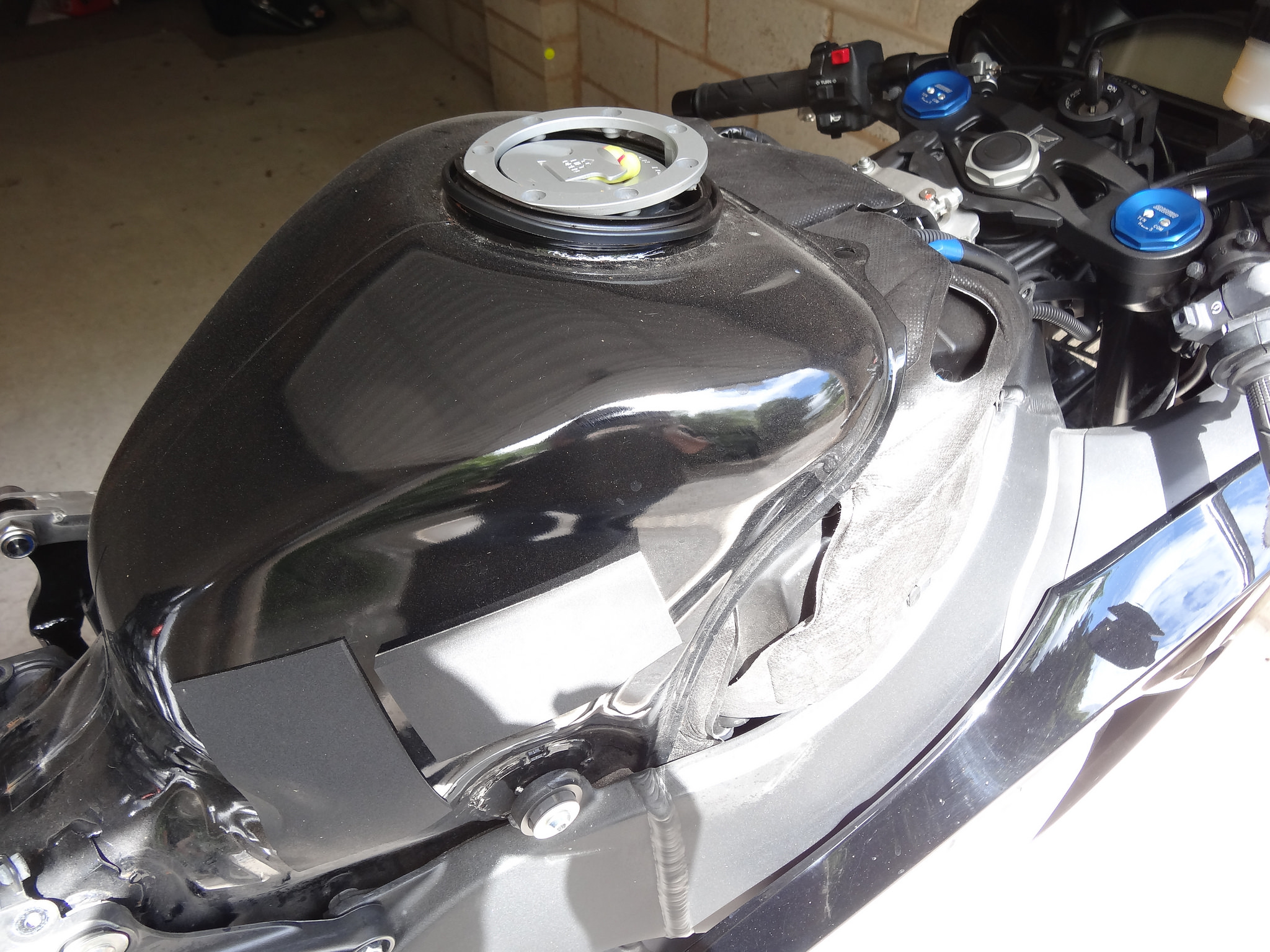

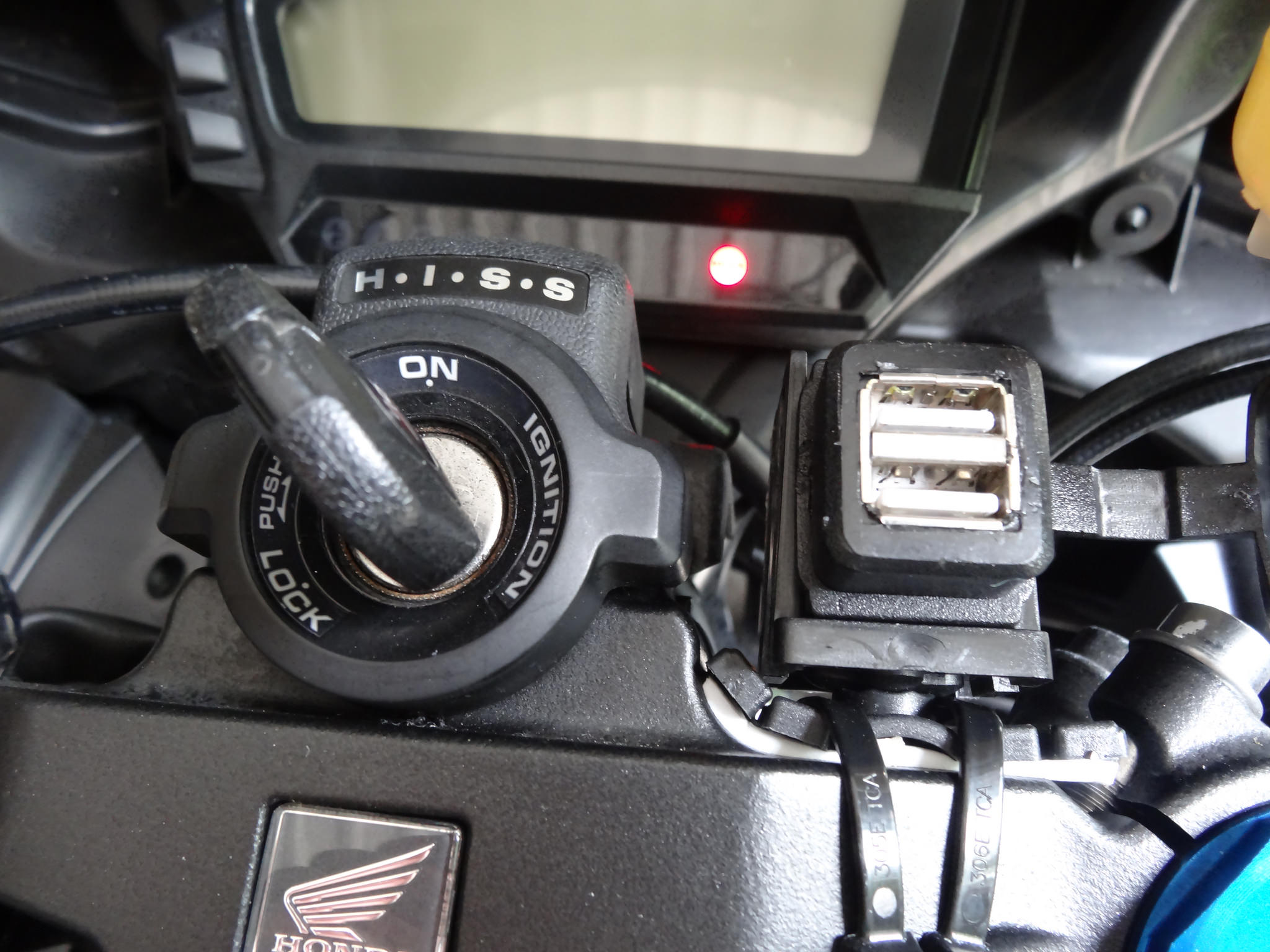

    Just be aware the battery capacity isn't that great on these bikes. I have had a flat battery a couple of times resulting from the addition of three USB ports. I have now added a switch to turn them off. As far as I'm aware the USB ports are working all the time, using the built in transformer to reduce the voltage from 12v to 5v, unless you have a clever USB that only performs this task if it detects a load. I ended up with a flat battery recently whilst on holiday having just connected the tom-tom and my very flat camera battery. I have now installed a switch and I only turn it on when the engine is running. However the USB supplied with the Telferizer I leave on all the time, and so far it hasn't given me problems, but I'm always apprehensive when pressing the start button.
    Here's a few pics of the installation. These pics are for the installation of a twin USB charger bought off eBay. This is now on a switch as I think this is the one that flattens the battery.

    I have the same USB plug from Ebay on mine as Kevin does. I had to put in a switch to as it flats the battery.
