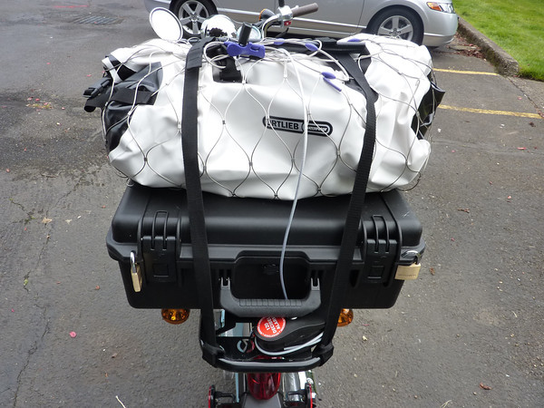

    If you just want to keep your luggage safe have you tried PacSafe? It's a lockable wire mesh that tightens over your bags to keep them & their contents safe.

    Thanks for the response. No offence please but two padlocks banging a cheap B&Q tool box is not what I would put on a Blade in a million years :)
