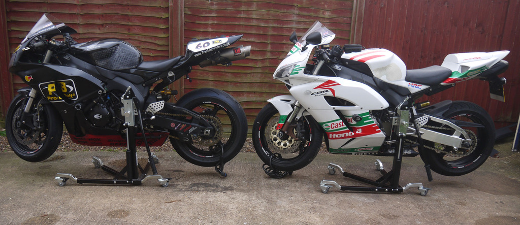

  7. Muffking
    5,834
    2,831
    Both mine measure M8 105mm.
    No problems getting them off the ground ;)

    164
    What a cracking pair! ;)
    Thank you for the measurements. I WILL get this working :D
