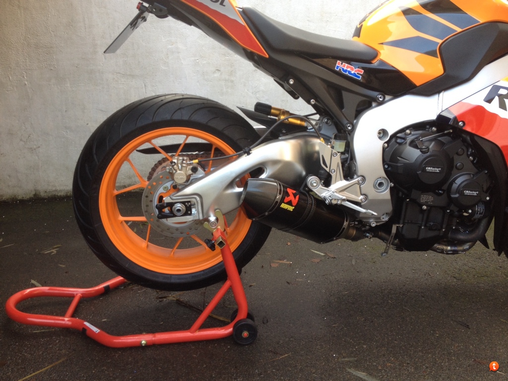

    Been looking at a couple of ohlins rear shocks on ebay and wondered what the difference is between these two model numbers?
    HO788
    HO931
  2. Jamiestrada
    Here we go ..... I think
    Ho778 is mk 1 version I have the preload adjuster is positioned on the shock
    Ho931 is the mk 2 replacement and the preload is normally mounted on one of the rear peg bolts
    Obviously the mk2 ttx is improved over the mk 1 but both good and for the riding I do and occasional trackday !

    Apparently there was mk 1 0788 and 0888 one for non ABS one for ABS (0888) they then released mk 2 0931 for both but people wanted 0788 style back so released mk 2 0788
  7. sps170373
    sps170373 Moderator
    May 24, 2013
    7,860
    3,092
    Ah ok cheers Jamie, just wanted to make sure as going to buy the HO931 as have seen it at a great price that makes it a steal
  8. Jamiestrada
    That's the latest so you can't go wrong really plus fits either bike :)
    Worth every penny IMO the ride on my bike is noticeably better and not to firm etc
