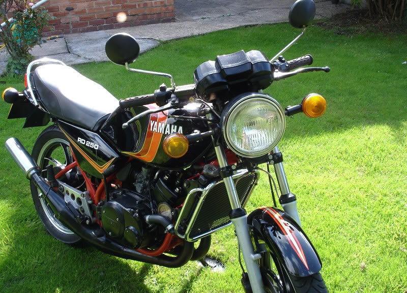

    thought its about time I got round to putting some piccies up of my 250 lc
    1982 uk bike matching nums
    boought it as a runner but boy did it have some surprises install for me :shock:

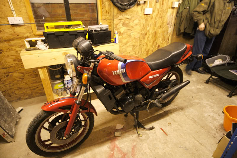

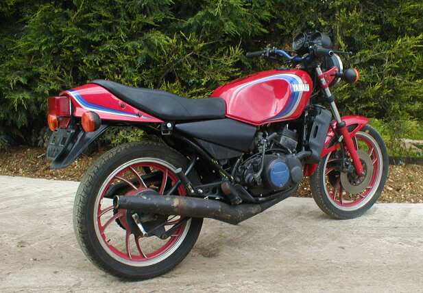

    original add picture ooh how photography can hide a multiple of sins

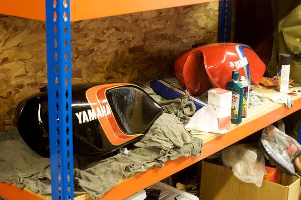

    tank of next to my dads red one of his 350 gonna me mars bars to :D

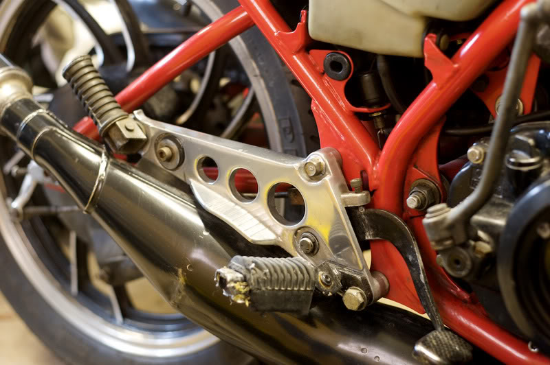

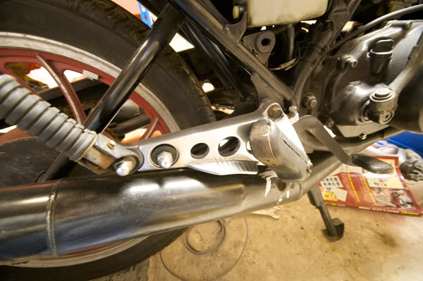

    got the footrest hanger of and cleaned them all the bolts are totally wrong

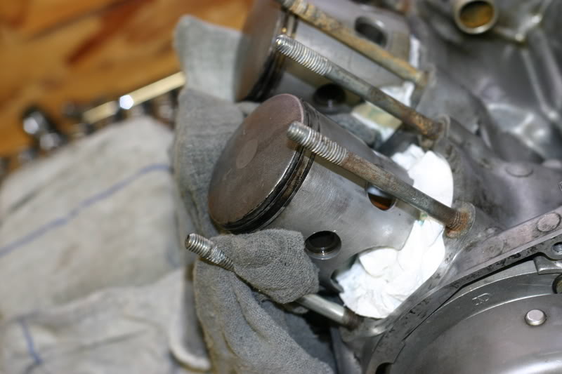

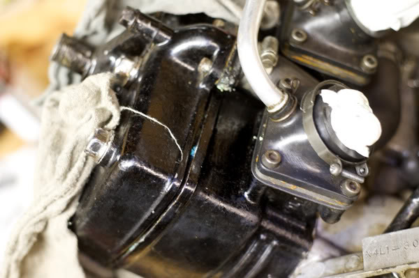

    engine before wazzing it out of the frame the exhaust gaskets had been spraying the entire engine lol looks like it was painted with enamel or something
    on the bench time for the horrors to begin :shock:
    hmm tube of sealant instead of a gasket shoddy lol

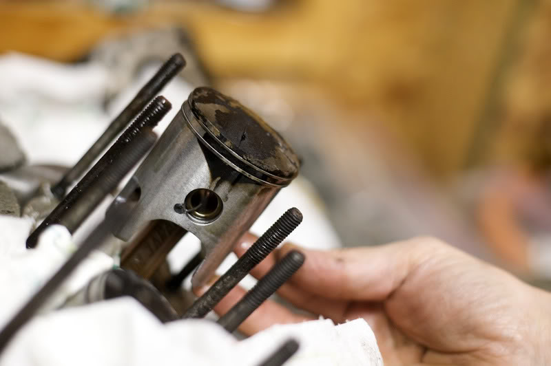

    then was confronted with this......
    oh Sh**

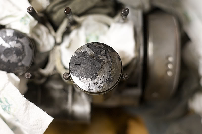

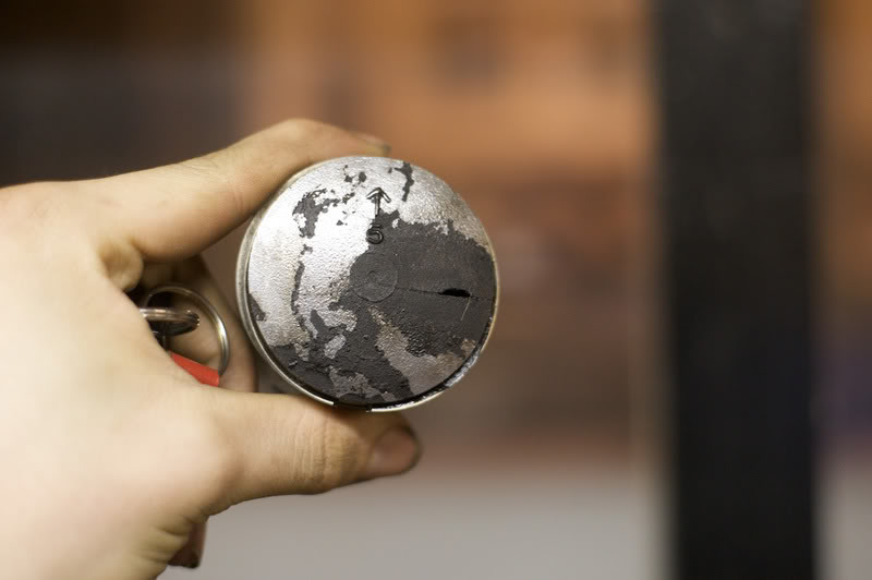

    reckon the cause was a wrong spark plug the previous owner had put in whats everyones opinion on the matter?

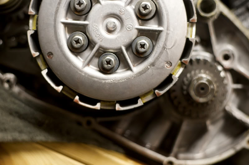

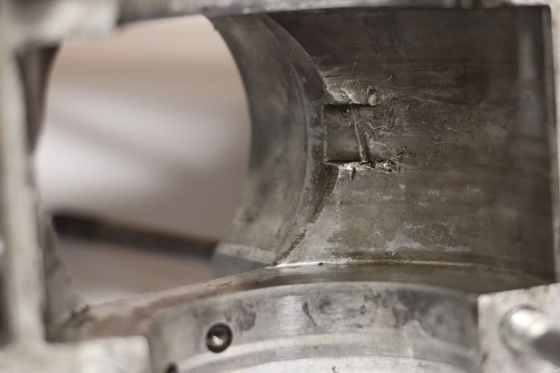

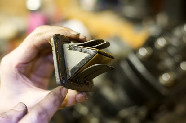

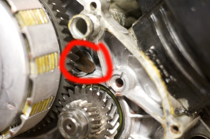

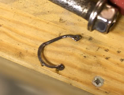

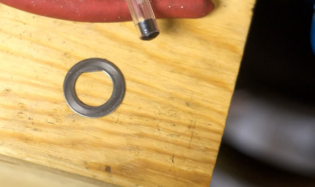

    hmmm metal fillings wonder what caused them - from a circlip and washer flying of the kickstart gearing
    what have we here
    talk about a shock a loose washer
    and this in the same side as well just loose...
    some light marks
    oh the joy

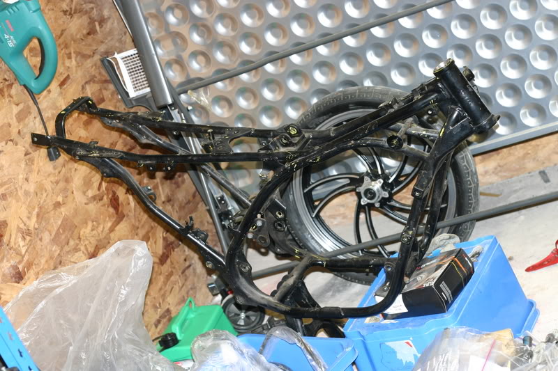

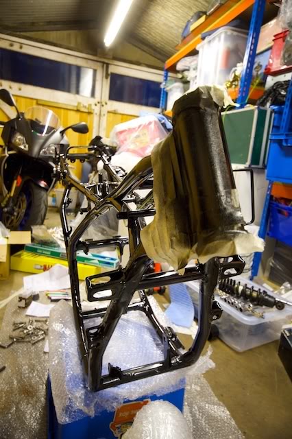

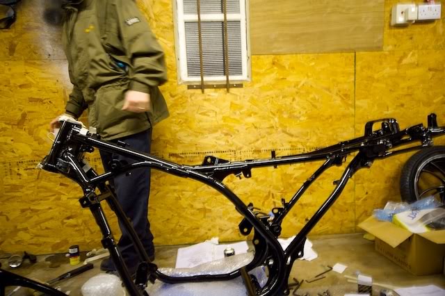

    well just got the frame back from the powder coaters really happy but the numbers were extremely faint so had them mask it so I could fill it in with enamel spray

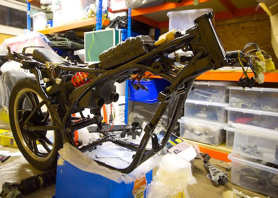

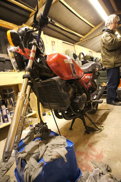

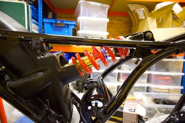

    Bolted the shock on to check for fit
    using a draw bolt to insert the bushes for the swinging arm (b&Q £10 for the bits)
    finished for the night (rear wheel just using it to prop the bike up)

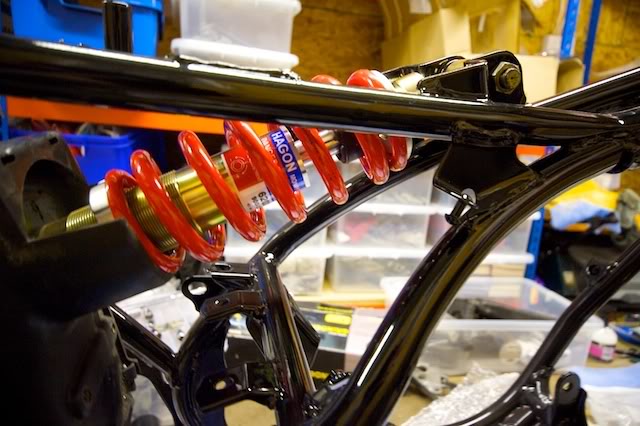

    fitted the shock swinging arm air box with new seals and loom
    all the bolts are stainless steel I'm putting on just using the old ones for reference at the moment. got stainless ones to go on got a kit with them all in for a fraction o the price of yam ones as the price of yam ones are crazy ok for a show bike but for this 250 I plan on riding it so using stainless as it saves a fortune and u don't get the green finish corroding after 2 years got green ones for the bars so it looks good but the rest all all stainless.
    gonna fit the front forks tomorrow with the bars and switchgear buzzing at the moment

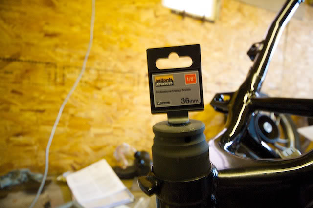

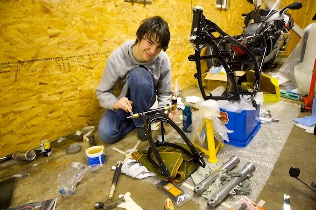

    inserted the bottom bearing cup for taper roller barings but this presented a problem inserting the cup in enough due to the lengh of the bottom bearing cup required a drift phoned loads of bearing companies up and they didn't have a clue what i was going on about gutted
    so a trip to halfords with a vernier caliper produced this a perfect fit
    bearing cup inserted Wooot

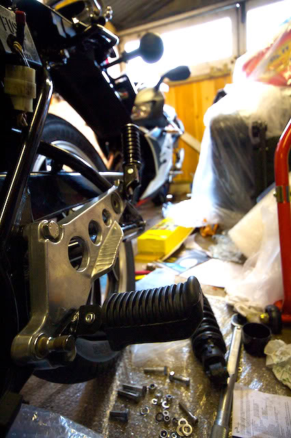

    assembled the foot pegs loosely onto the frame

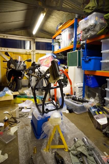

    rear seat cowl on pretty chuffed gonna get the tankset resprayed once the bike is built

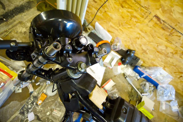

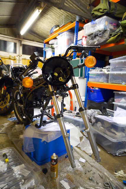

    forks in the yolks ready to put the oil in then I can get the bars on and switchgear can't wait got a really good set of pattern mirrors the other day they look class and a much cheaper option to the gen ones we are putting on the 350 lc
    will be making some rapid progress over the next 2 days will keep u all updated

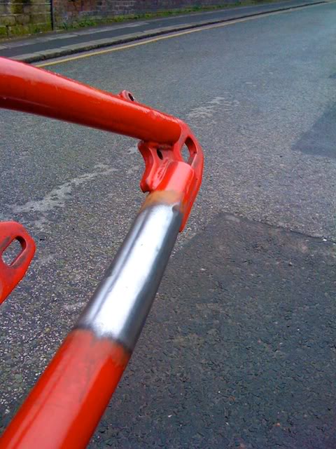

    Just remembered bout these some repair work I had done by a friend of mine who is an ace mechanic races as well was really amazed at the quality of the repairs

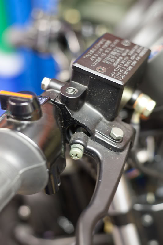

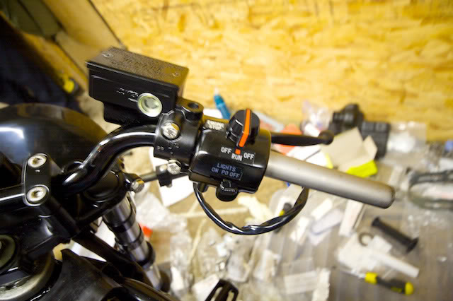

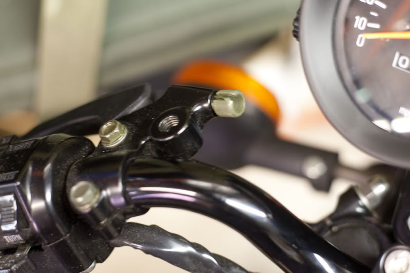

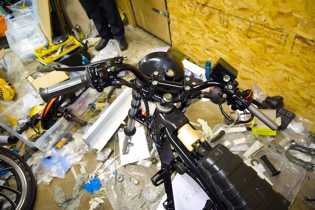

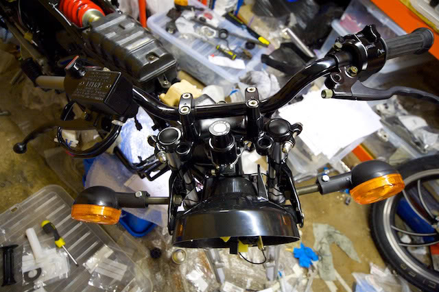

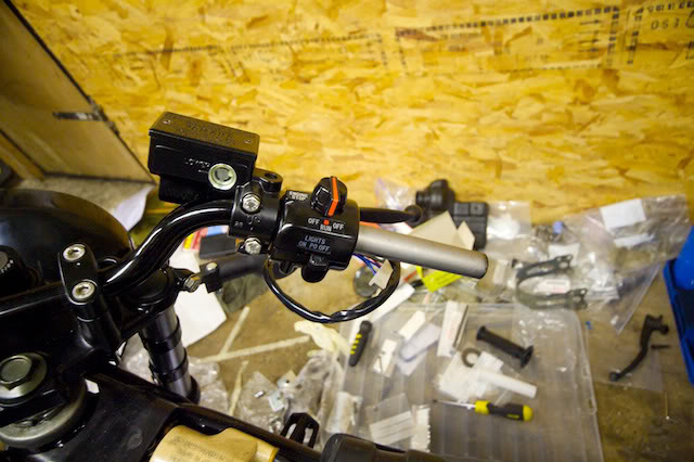

    right hand switch gear roughly on with master cylinder ( know the plastic throttle tubes gotta go on just trying to reduce amount of bolts in bags lol way to many

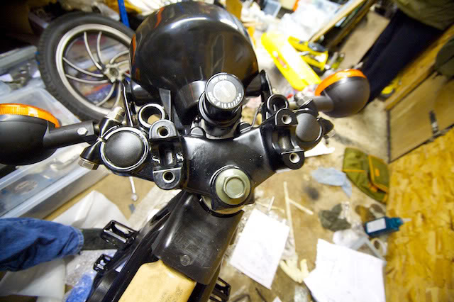

    bars on with left hand switch gear few green bolts pinched from the 350 lc boxes (poor 350 lol)
  5. gixerlc
    gixerlc Active Member
    Sep 28, 2011
    332
    58
    another view of the bars
    Finally where we are up to tonight gonna really crack on with it tomorrow and spend a full day on it

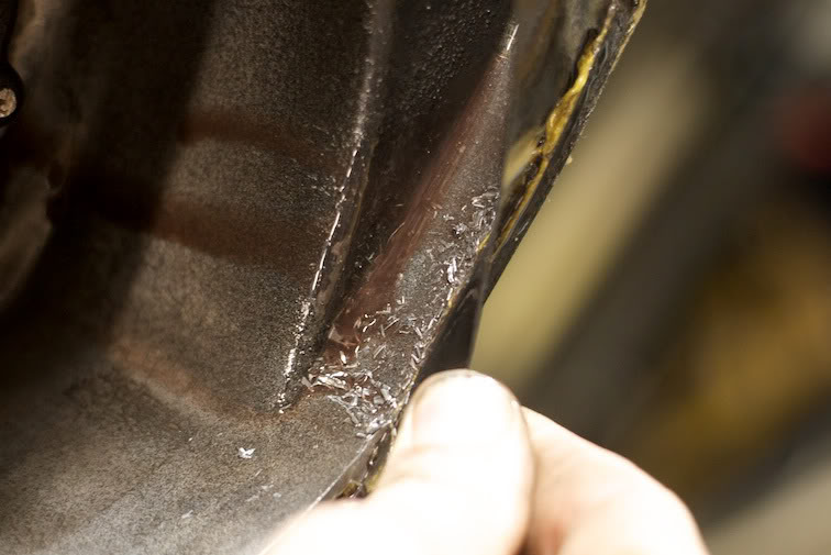

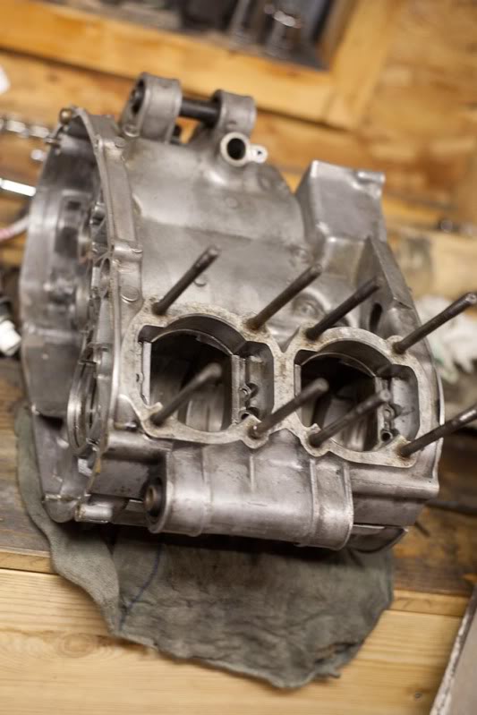

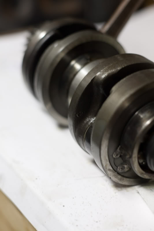

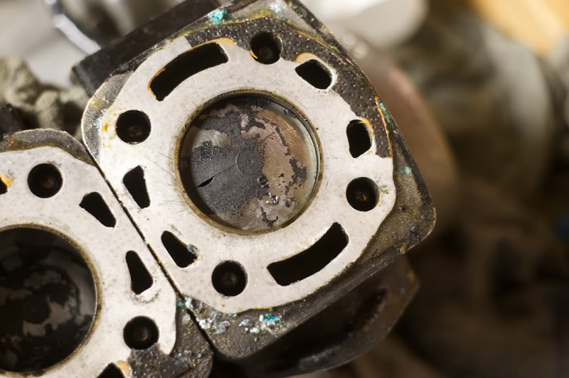

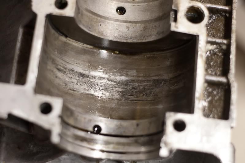

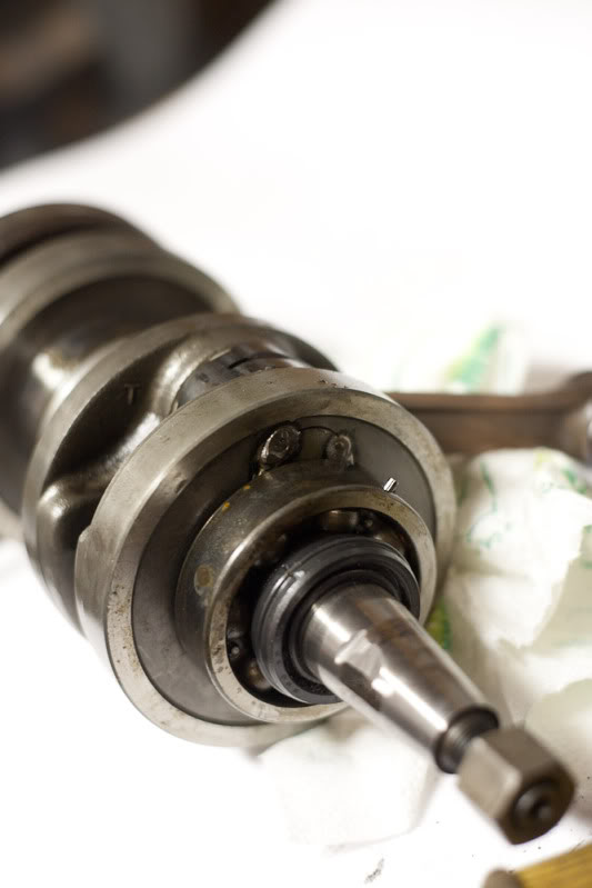

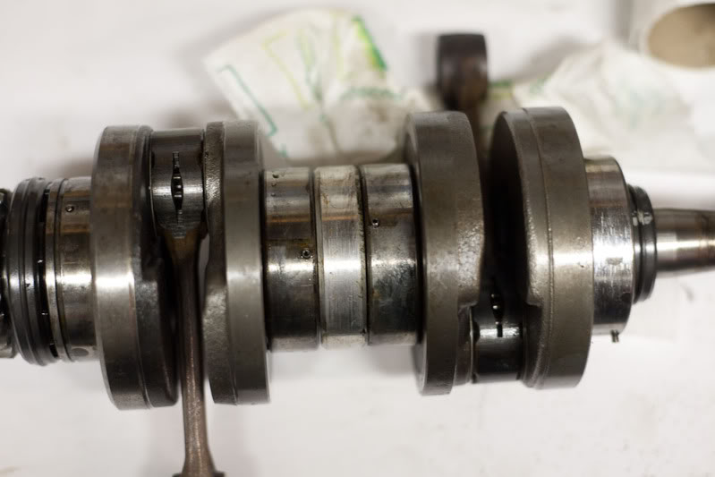

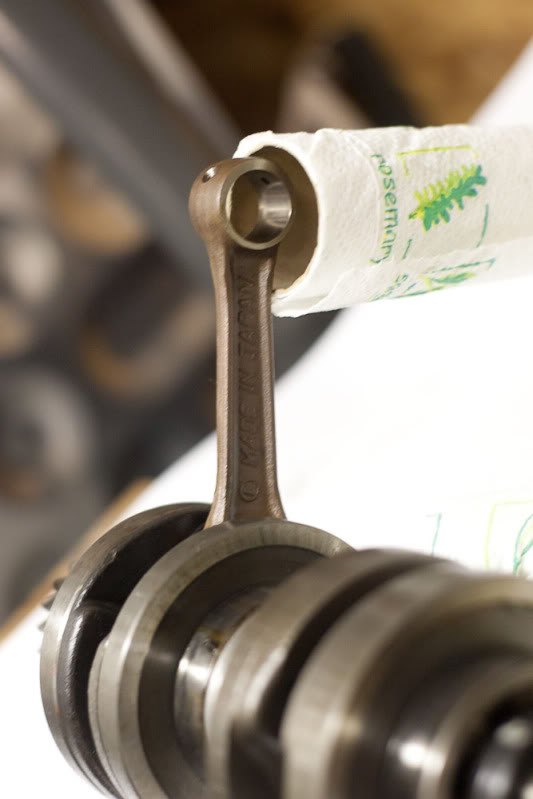

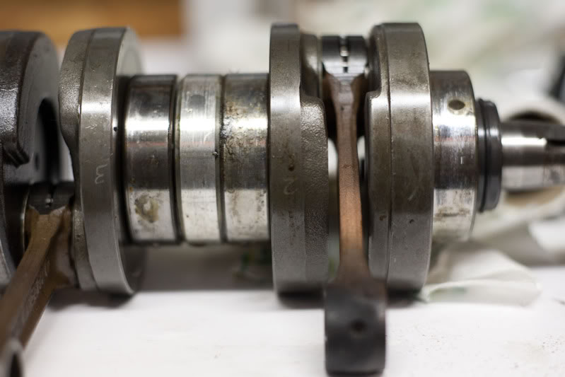

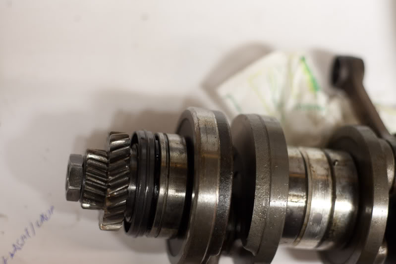

    stripped the engine and split the crankcases tonight its had a very bad seizure at one point as theres some heavy cases in the right hand side where the crank sits on the top and the bottom of the cases whats everyone is the best thing to do leave it or smooth it out Ill get some pictures tonight(monday) going to get them vapour blasted to as they are so grubby its untrue anyone know anywhere near Manchester thats good.

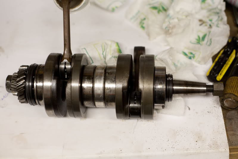

    also trying to decide whether to get a completely brand new balanced crank just got to decide on the make or get it rebuilt steadily been collecting nos parts to finish the bike turns out this is going to be the easier of the two to do to concours. So swapping the hagon rear shock and the second hand loom and pattern headlight onto the 350 lc till i can get genuine for that
    managed to get hold of brand new nos barrels and pistons and a good cylinder head and a nos rev counter and a nos blue dot exhaust
    so still on the hunt for... nos blue dot right exhaust, nos speedo, nos side cases, nos tankset in mars bar black
    amongst other little parts hopefully will have it done intime for stafford or at least most of it together
    Tom

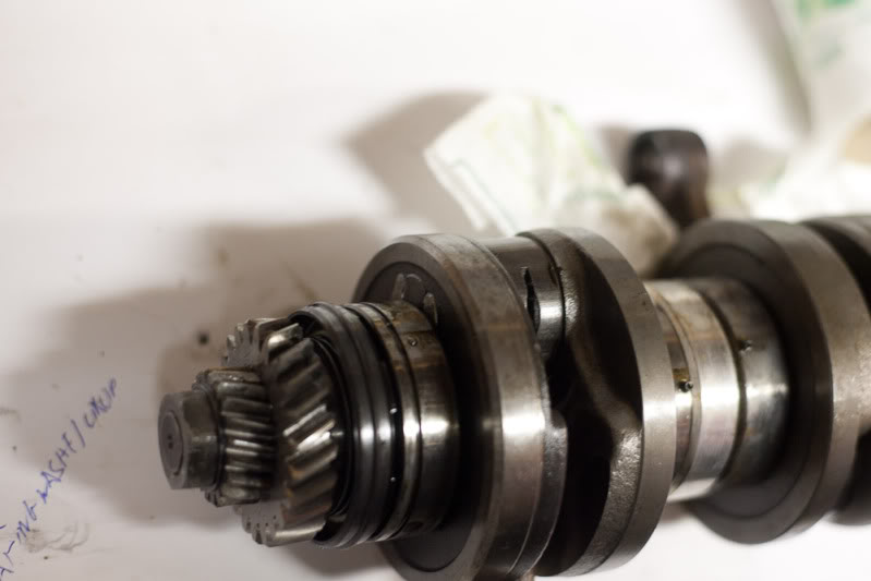

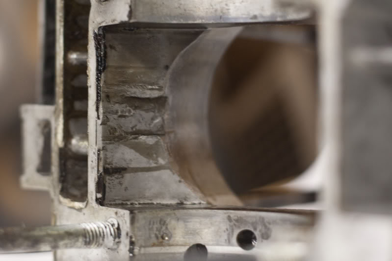

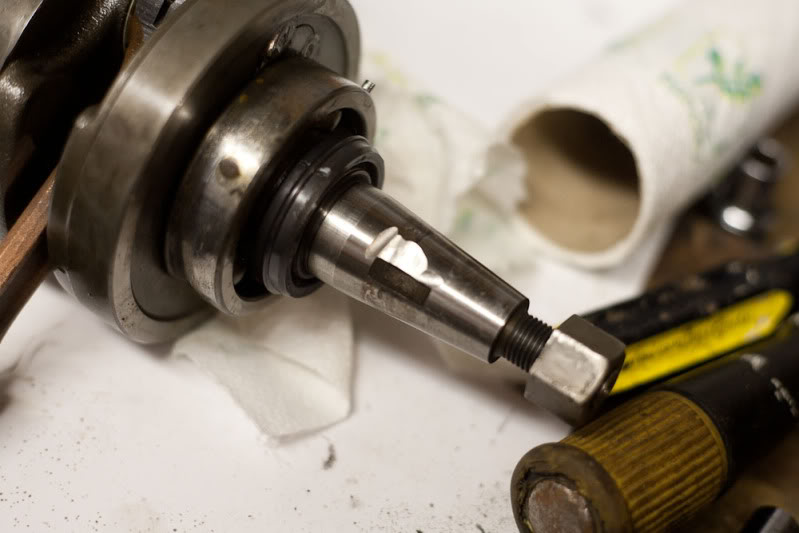

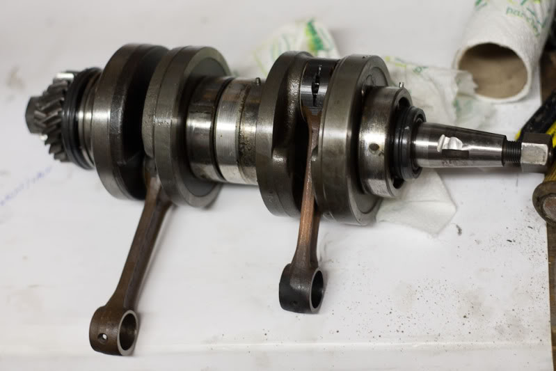

    Finally got the crank pictures took and the ones of the engine dammage whats everyone reckon is the prognossis on the cases and where and how should I get them fixed if needed any reccomendations
    gonna get the crank checked out I think looks pretty decent barring the damage to the stator end will see what the crank people say though before I dive in an get it rebalanced and rebuilt if it needs it
    plan for this week is to strip the carbs and drop them and the engine cases in for blasting after deciding what to do about the case dammage and to get the crank sent to the rebuilders to get it checked out then start putting the engine together so close now its unbelievable cant wait
    Thanks,
    Tom
    Engine Cases
    Top Case damage only on one side of the engine
    Bottom Case Damage only on one side of the engine
    Crank

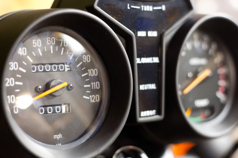

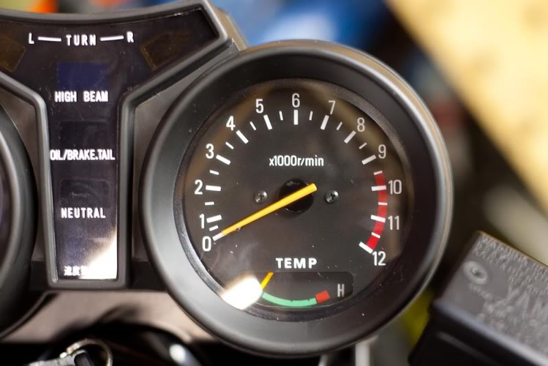

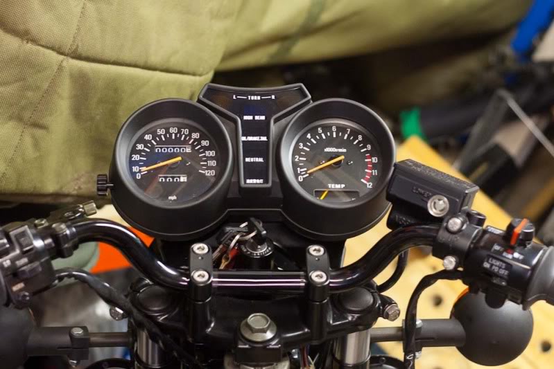

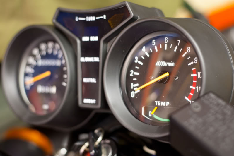

    Finally got the clocks together result new speedo new rev counter etc just a shame about the 4l3 front clock case another nos part to be on the hunt for
    Bike is really coming together now just looking forward to the bike being finished and getting the rest of the bits on

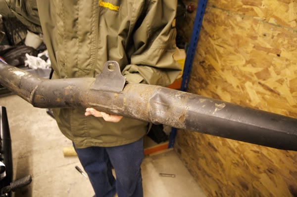

    our german import 350 lc lots of stuff needing doing on this one
    every nut and bolt goin to be perfect well thats the intention anyway on to the pics
    heres the original add pic from ebay
    when we got it home the bike that started my obsession with motorbikes

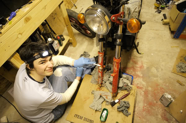

    doing the fork legs when we were just starting to learn
    Thats a bit better
    The exhaust of the bike banged dinted cut and shut
    sorting the footrest hanger out
    ahh thats better with a set of good exhausts we picked up

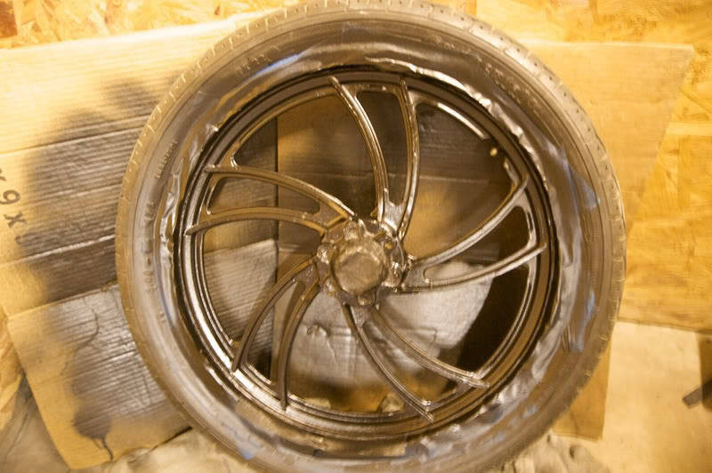

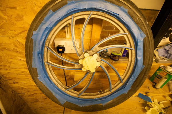

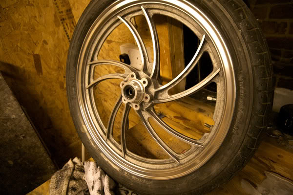

    Thought I'd do the wheels polishing them took ages

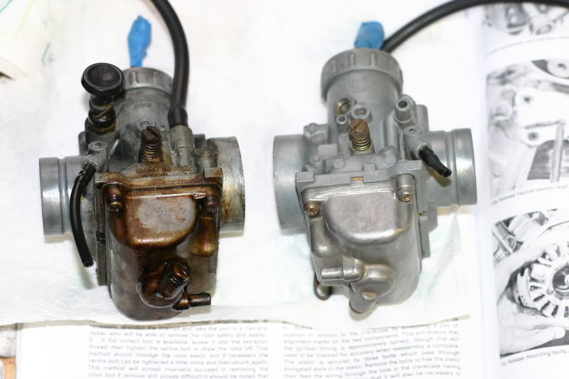

    carb cleaning

    where we are up to at the mo ready for powder coating
