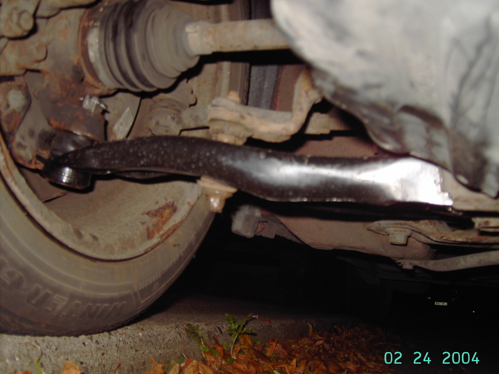

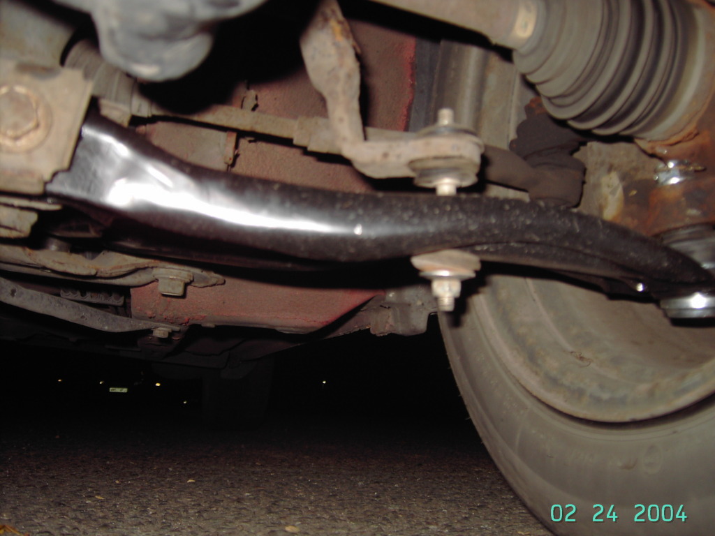

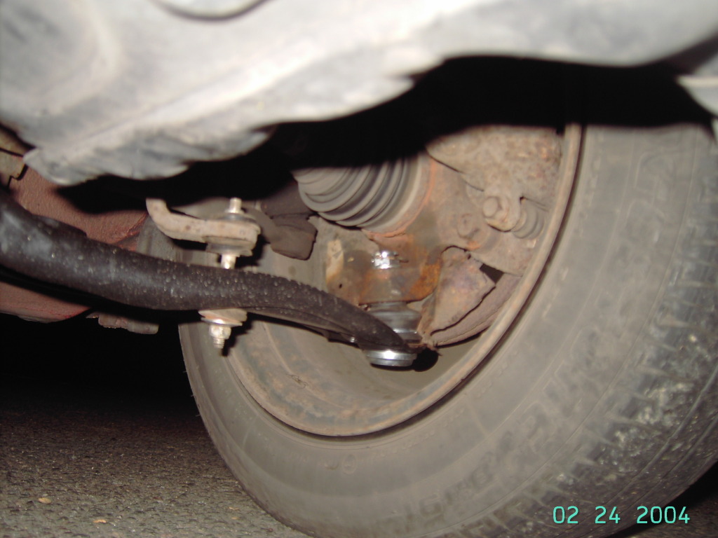

[ IMG]http://i1218.photobucket.com/albums/dd404/daved66/yaris004.jpg[/IMG] shes just got in tyre pressures are fine,squeals like fcuk going round a roundabout even slowly can any1 see owt wrong summats definatly wrong...thanks for your replies.
Those tyres are royally fooked mate!! (again pointing to tracking probs) That and the tracking rod end looks past it's best.
That could be down to the calliper being took off and back on again from fitting the wishbone/suspension arm. The discs do look a little rusted and could be catching the pads with the lip from the wear. If it were me I'd at the very least file the lip on the disc down and file a chamfer on the pads. Again I'd have some questions about the garage it was taken to. Why not at the very least take the car for a test drive after work was done??
It has definitely not been tracked the nuts holding the track rod ends have not been touched ! They take a lot of undoing and lots of releasing oil, get it tracked ASAP. The squealing might be the disc backing plate hitting the disc, easy to bend whilst fitting ball joint , Very unprofessional job don't go back to that garage , well go back with the bill from a tyre fitter for the cost of the tracking.
just got back as suspected they could nt do owt as they didnt av a laser set up,so off to a proper place and alls well £15 and its fine now thanks
So they replaced the parts and set up by eye and guess work. Sounds a real pro setup Dave. Wonder how they managed to track, toe and castor before the laser was invented? What counts is you can cross it off your snag list and get into the holiday vibe. You jammy git.
